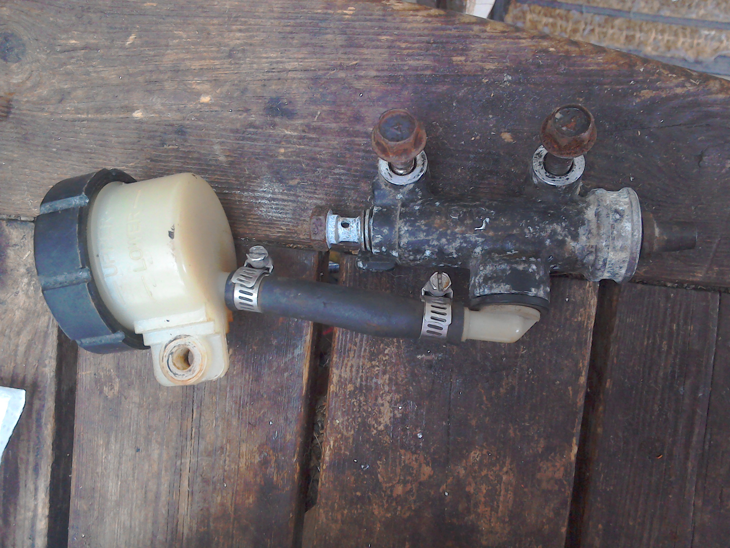

Is there a replacement for this type of master cylinder don't mind aftermarket but don't really want to adjust the mount for it as will get my old one re-sleeved in the future

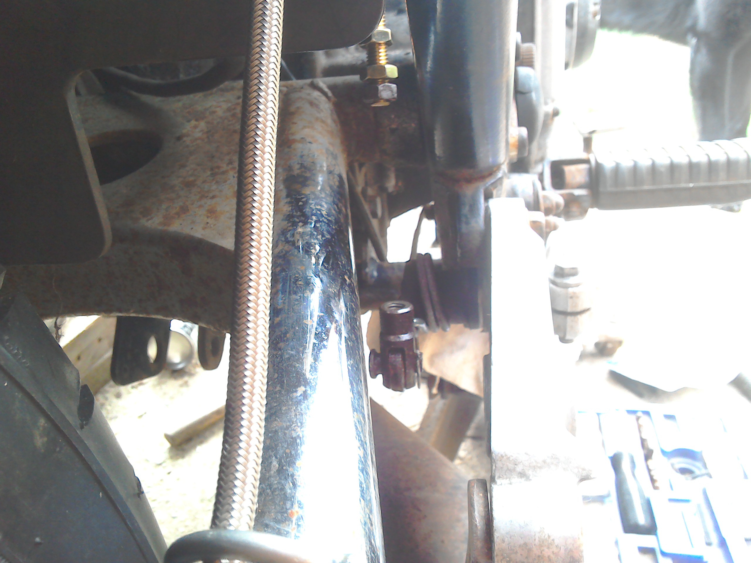

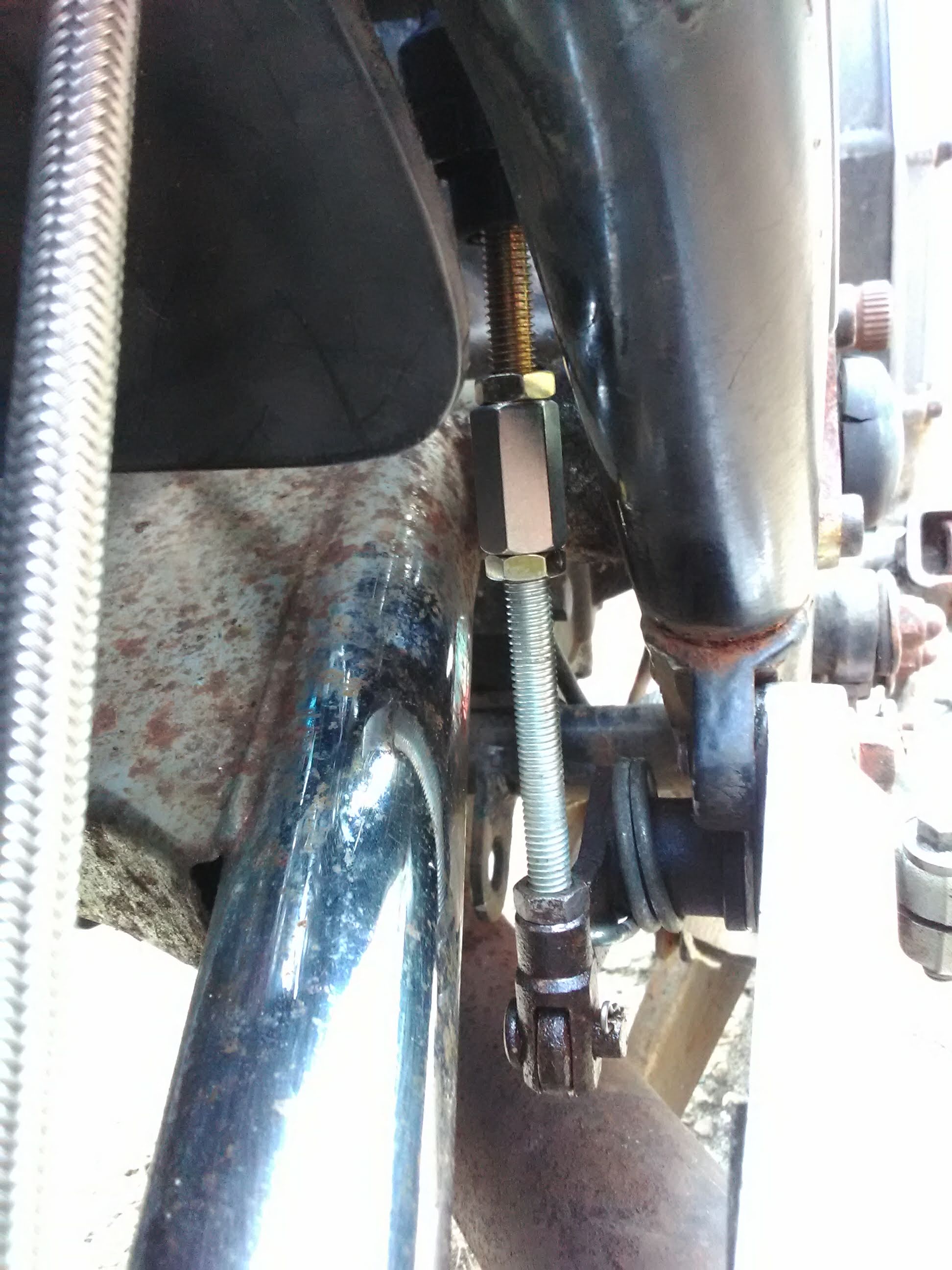

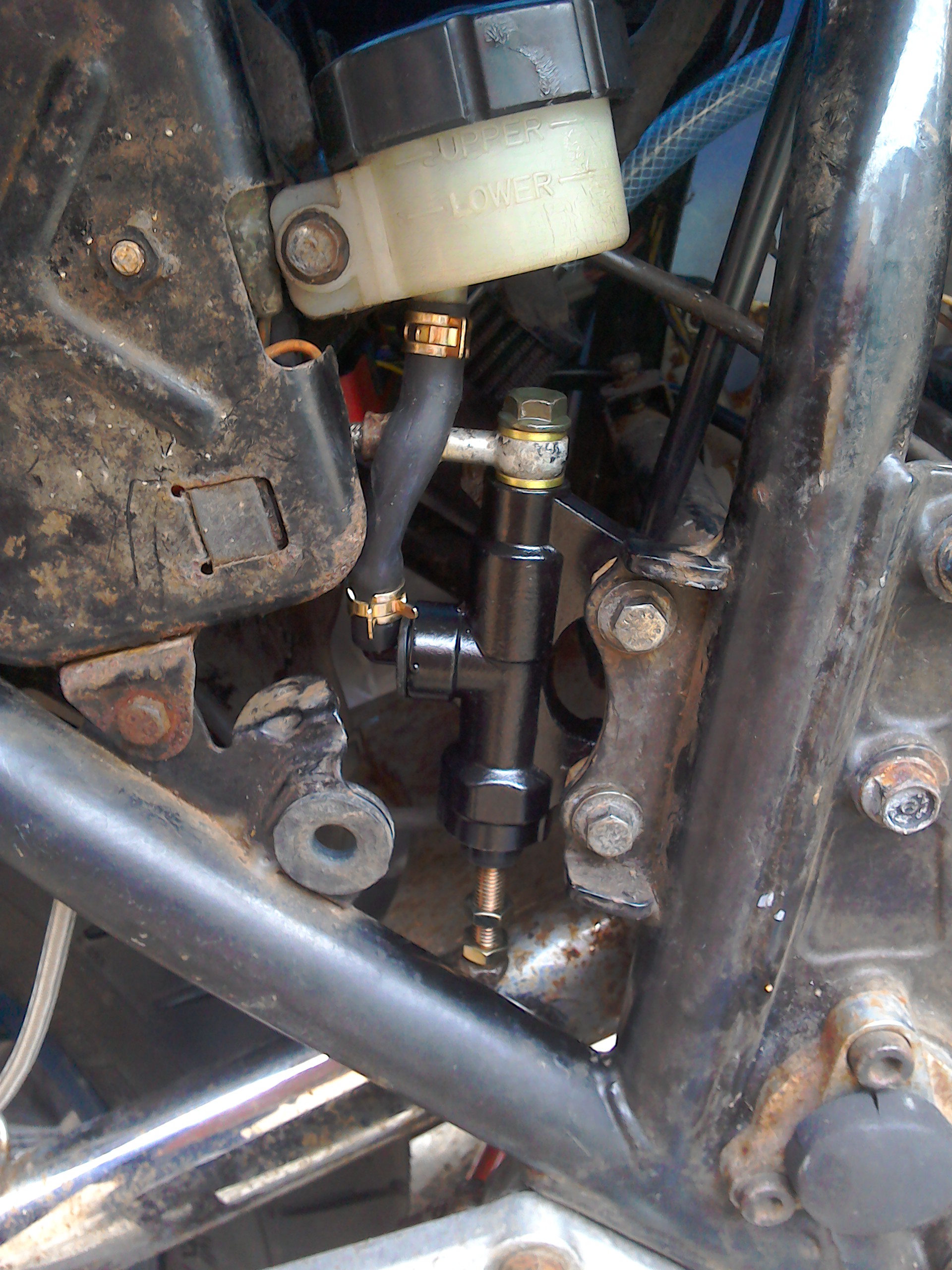

found a 1/2 master with m8 threads and 50mm between mounts tho had to fit back to front so added two 50mm standoffs to make it line up with the pivot arm just waiting on a m8 threaded rod and a long nut to joint it up.

all done and bleed brake now feels fine
