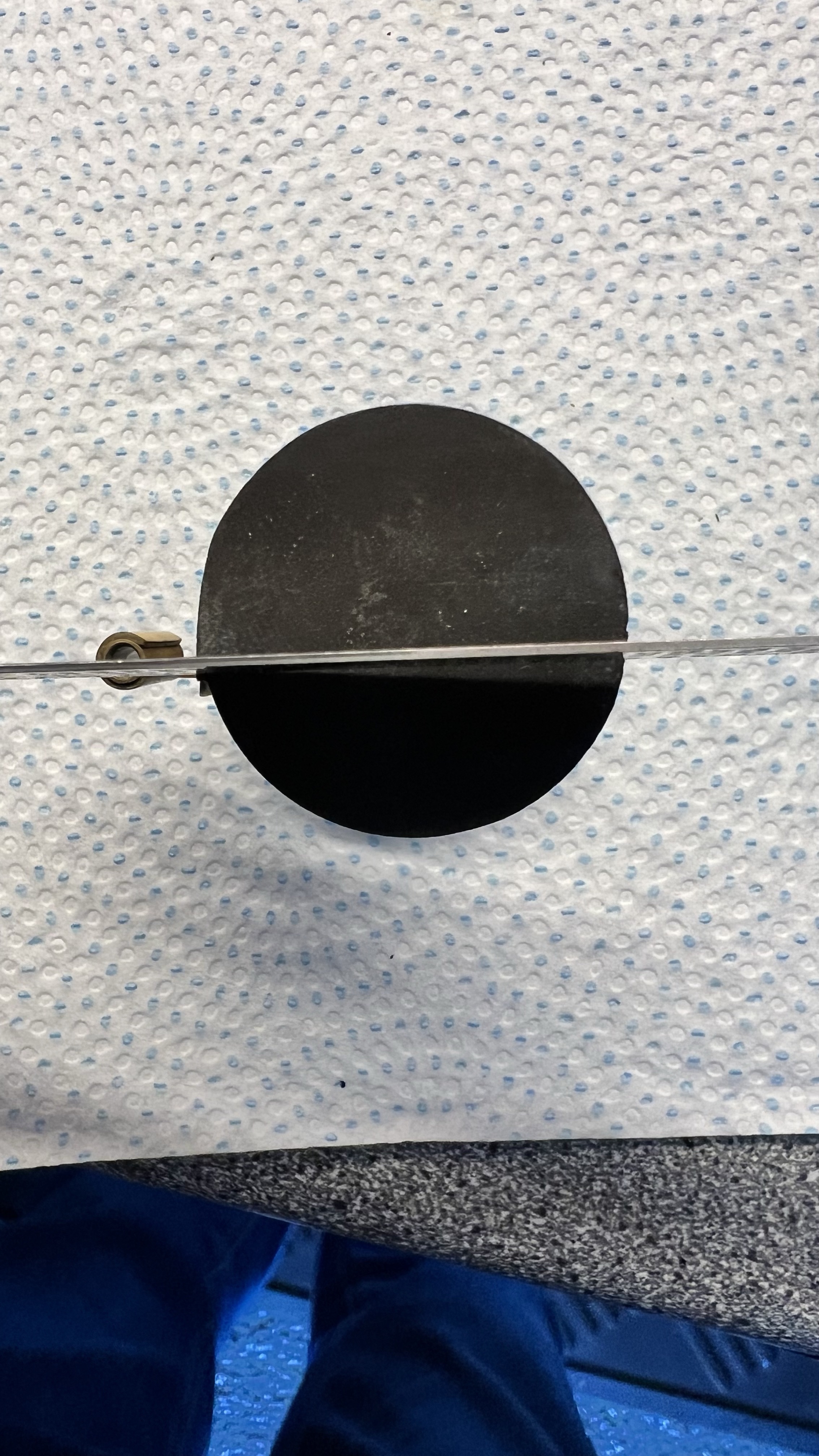

Re: KZ900 carb help
Warren also mentioned that the brass hinge section is aligned with the diameter of the floats passing through the middle and not oblique to it.
This picture posted by 'Sprint' last year in the thread i linked, you can see that the floats are about the same resting level as yours with the float valves under pressure and closed. What you can also see is the 'tab' on the far side is resting on or close to the post.
This suggests that there is very little movement available to the float to move from its present position and that when the 'tab' stops the float moving,.. the 'tang' will still be in contact with the needle plunger pin.
This was sort of where i ended up but the RS carbs have a cast nipple in the float chamber which messes it up further. It was stalemate for me for a bit.
This is as a consequence of the float level being incorrect despite the fuel level being demonstrably correct!!!!
"Someone may have found it easier to bend the floats rather than the tangs previously if they did it all with the carbs on for example". Do you know what; that sounds like stuff i used to do when i was a youf.

Re: KZ900 carb help
Also, just noticed in that picture, look how much the tang is bent upwards to compensate for the fact that the floats are out of whack !

Re: KZ900 carb help
OK, so I think we all knew what was going to happen !
After Al had planted that seed in my brain I couldn’t rest until I went out and took the float bowls off and had a look to make sure that my floats were aligned, centre line of float through centre line on hinge.
And the results are in ……. They’re not ! Not a single one. They all look exactly like the one in the photo Al posted. I’ve attached the best photo I could capture with my naff eyesight, but as you can see it’s actually slightly worse than where I am holding the ruler in the photo. .
I’ve bent the floats on the first two carbs so that they are aligned to the centre of the hinge pin. Thinking that would make the float height more akin to the manual I reached for the vernier, and now it’s gone up from 28 to 30 !
Are we 100% sure that the floats should be aligned (centre of float through centre of hinge pin) ? If so I’ll go bend the others straight and play around until I get the right levels again.
Does anyone have a brand new Z900a4 float that they could photograph and share ?
Thank goodness we are going to the pub tonight !
Re: KZ900 carb help
I am sorry i have misled you. This was the pic he posted on page three of this thread and i have told you the reverse.
That being said; if i had 28mm static float height and my tangs were potentially acting to side load the float needles, i would be tempted to try to get the floats back nearer to 26 mm by bending them and trust that brings the tangs after adjustment nearer to acting perpendicular to the float needle and seat centrelines.
Sorry to put you through that.
Check the float hinge plates aren't bent and the floats aren't bent.
They were as the solid circle when new.
Re: KZ900 carb help
No worries Al. You are trying to help, and I really appreciate all the help I’ve been getting on this.
I will circle back with the two carbs I’ve already messed with. I will shoot for the elusive 26mm in conjunction with the right fuel level.

Re: KZ900 carb help
Couldn’t resist another fiddle before I go to the boozer.
Set one of the carbs I’d already bent the floats on to a height of 26mm with the tang in a dead neutral position. I did this by bending the floats back, and then a tiny bit more.
Tried it,
Almost spot on !
Minor tweak to just make the tang barely ‘feel able’ above the level of the float hinge. Perfect. Plus the flow rate it quick to get it there.
I’m on a roll I thought, I’ll do another. That one doesn’t want to play so nice, so that’ll be for the morning, but I think I’ve finally got my head around it. Thanks for being patient!
Tried it,
Almost spot on !
