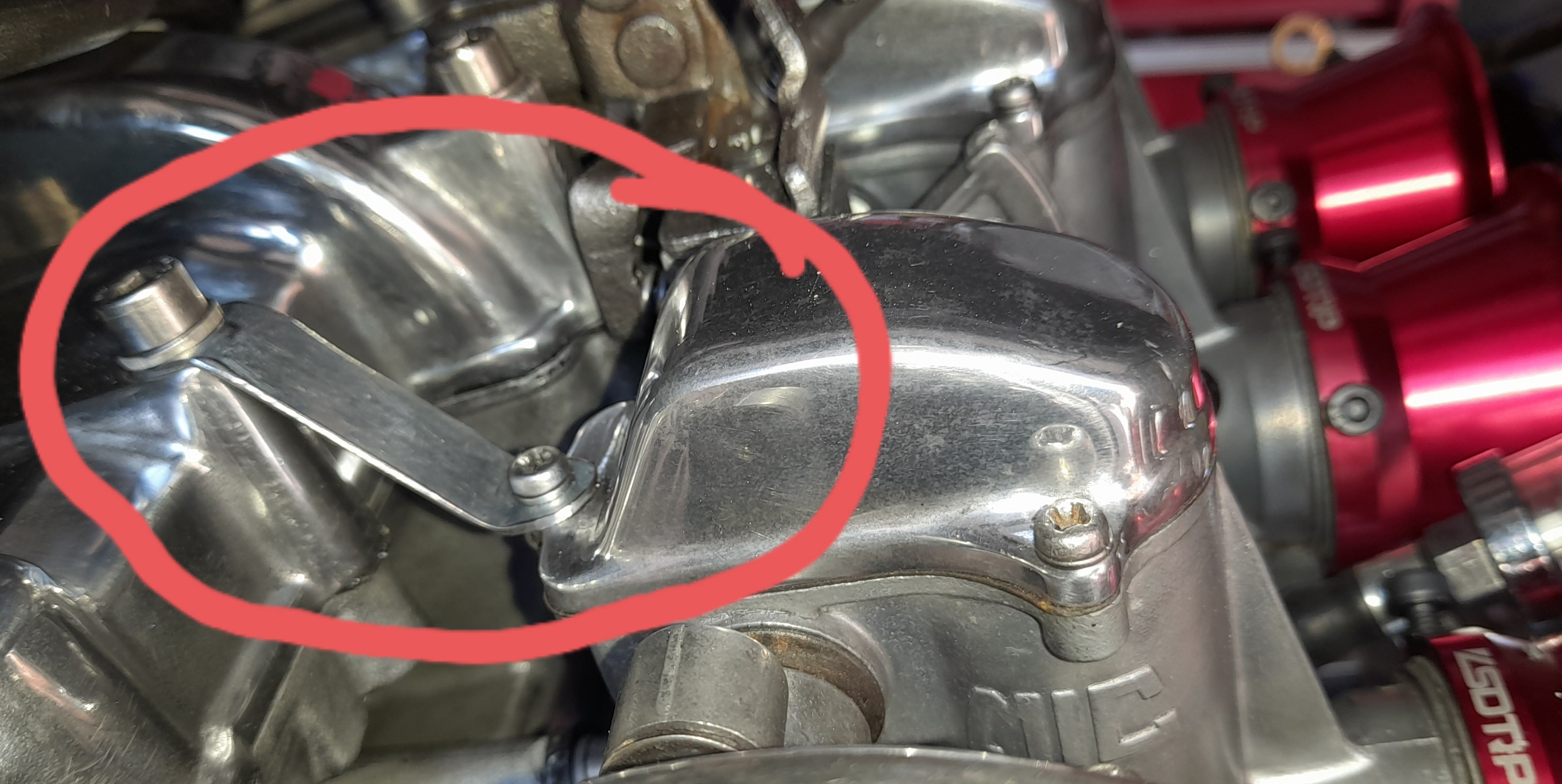

We're the inlet rubbers genuine or repop? The repop ones I tried are nice and soft but pretty rubbish quality. With unsupported cabs on one of my 650's they only lasted a few months before the split at the tube/mount plate seam. When cold it wasn't noticeable but once warm it ran like a dog because the softened rubber further made them sag under the carb weight and caused a vac leak.
I actually made support brackets to take the carb weight and used genuine rubbers. Never had an issue since.

They aren’t the genuine Kawasaki ones, but I bought them from Zpower and they seem pretty good quality.
In the first instance I’ll see if supporting the carbs solves it. I’m not going to get anywhere with trying to get it running right if I don’t fix this first
