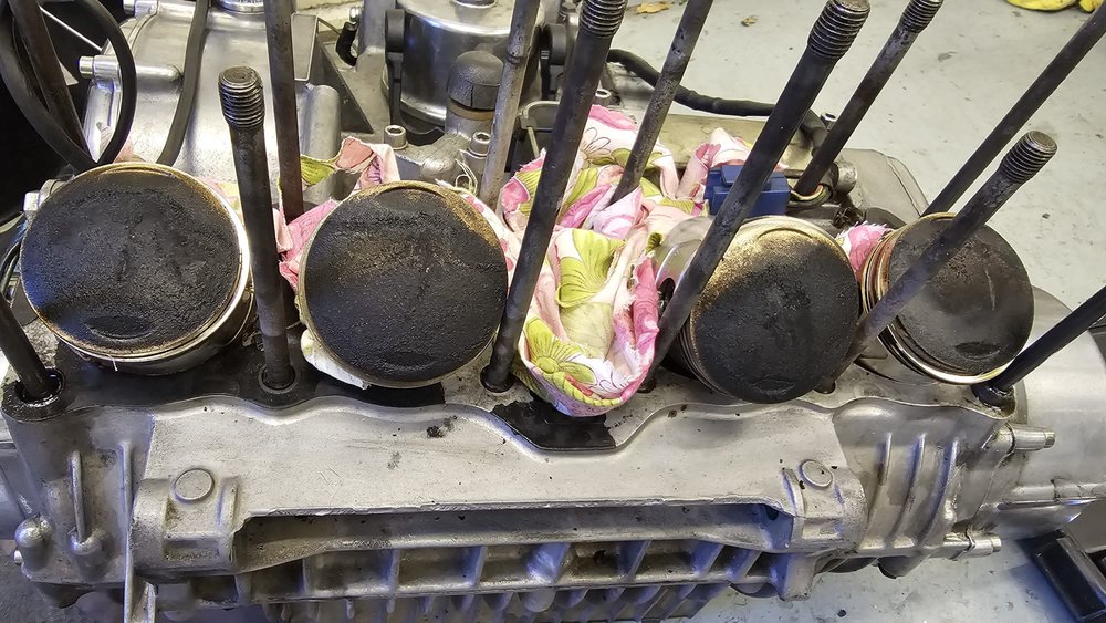

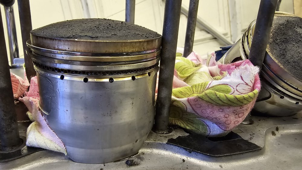

I have attached pics of the piston crowns, these were cleaned around 1,500 miles ago when I changed the valve guide seals. As you can see all 4 are now carboned up with oil residue.
My thoughts are that oil is getting into the bores from the head when stood. Could it be the valve guides themselves that need replacing ?

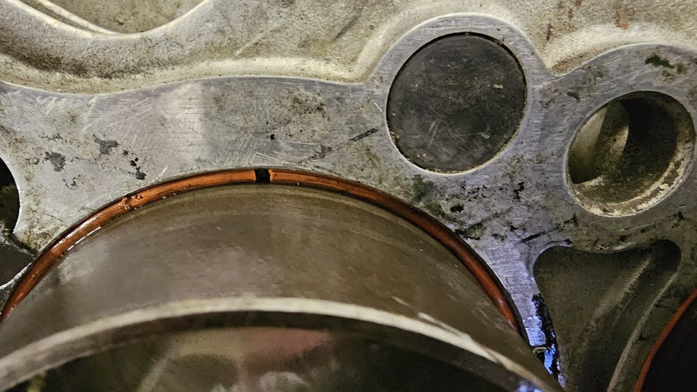

I also noticed that one of the 73mm bore O rings is broken, between the liner and crank case (see photo), I not sure that this could be causing smoke on all cylinders though.

No evidence of blow by on the ring lands - normally you would expect to see some burned oil deposits if you had a cylinder bore / ring issue. (none visible in pictures)

As you have the motor disassembled again already it would make sense to check the guides - particularly the exhaust side judging by the deposits on the piston crowns.

The "o" ring at the base of the cylinder liner should be replaced, obviously, but almost certainly is NOT the cause of the problem.
