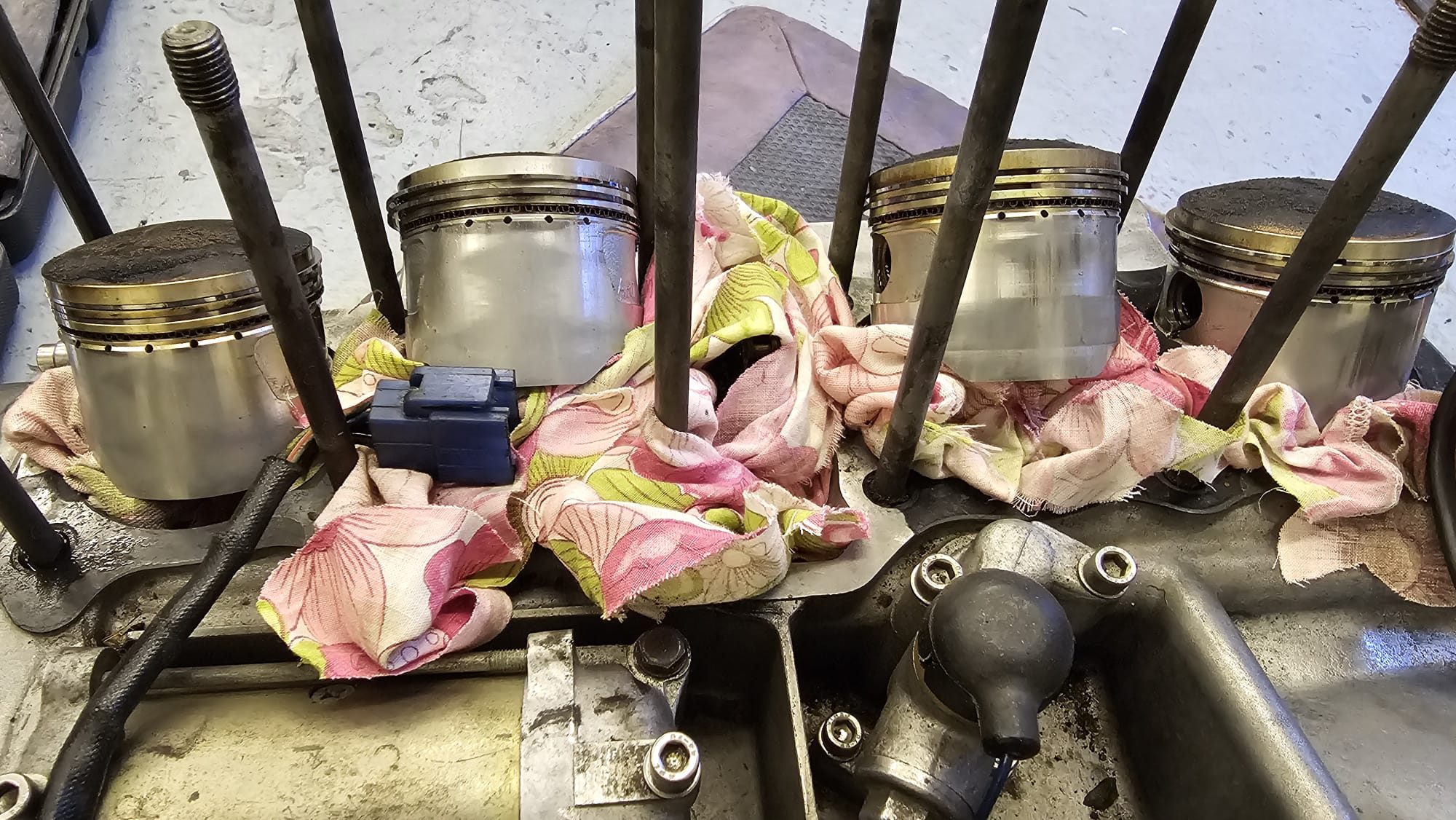

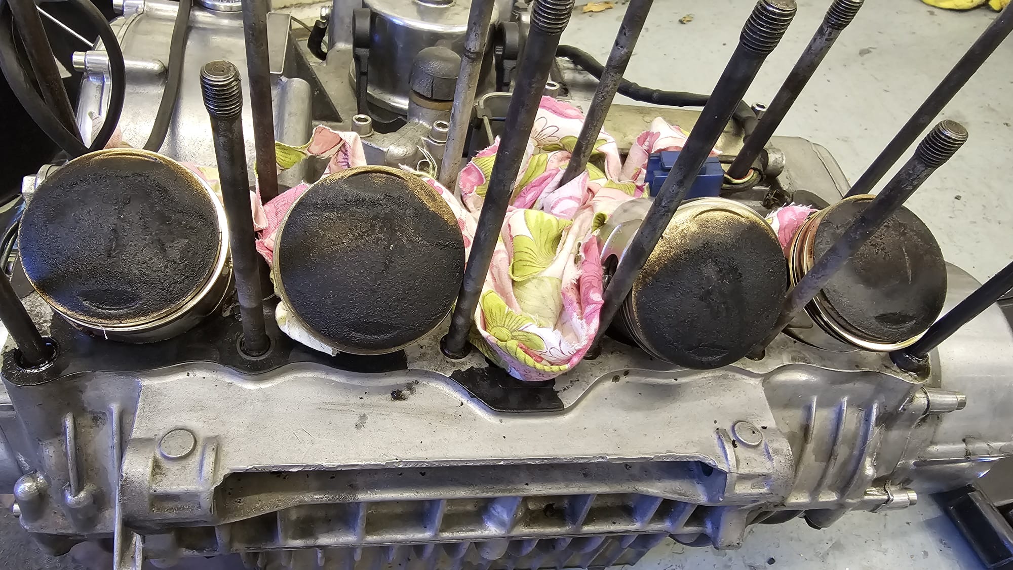

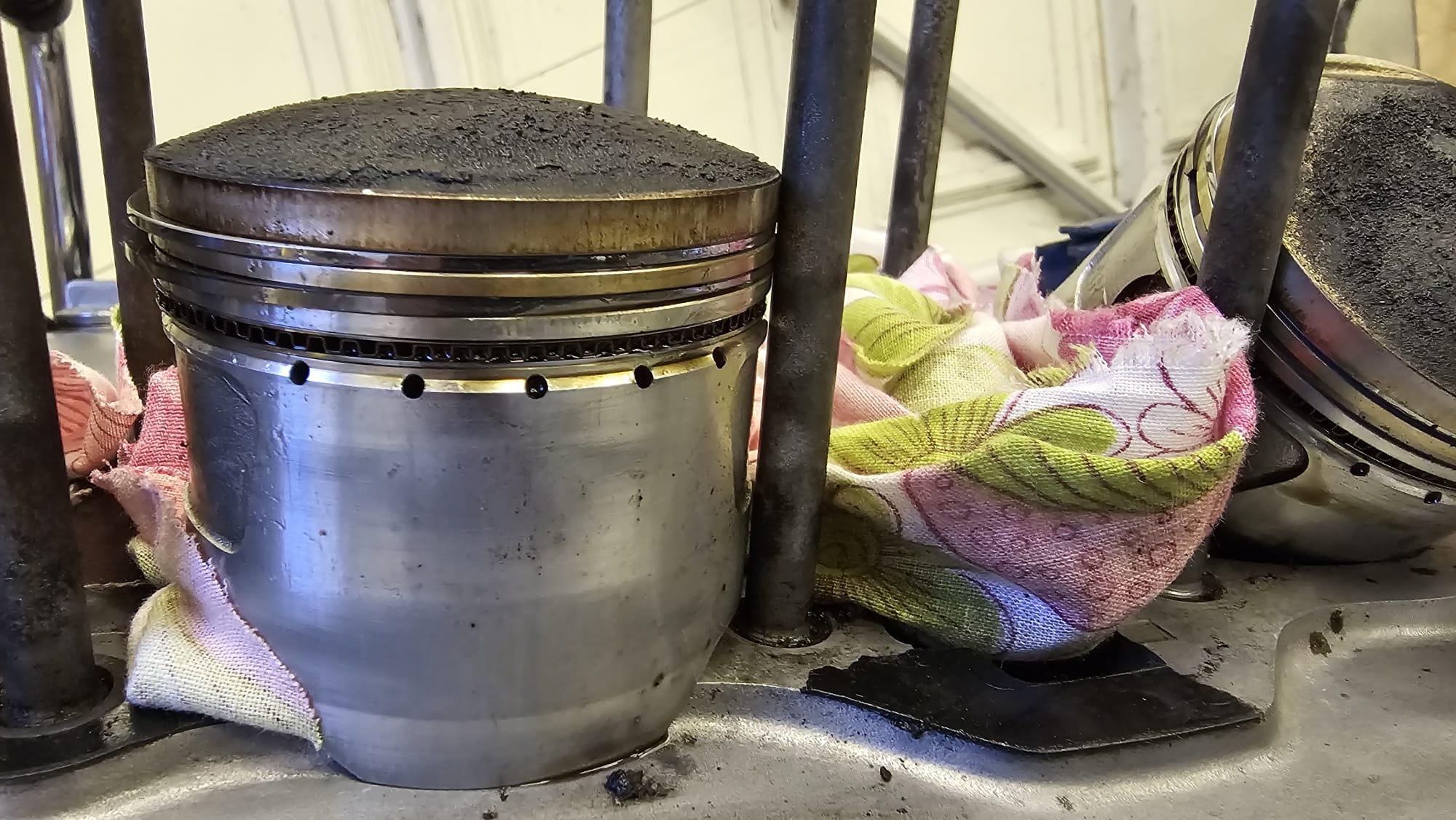

I have attached pics of the piston crowns, these were cleaned around 1,500 miles ago when I changed the valve guide seals. As you can see all 4 are now carboned up with oil residue.
My thoughts are that oil is getting into the bores from the head when stood. Could it be the valve guides themselves that need replacing ?

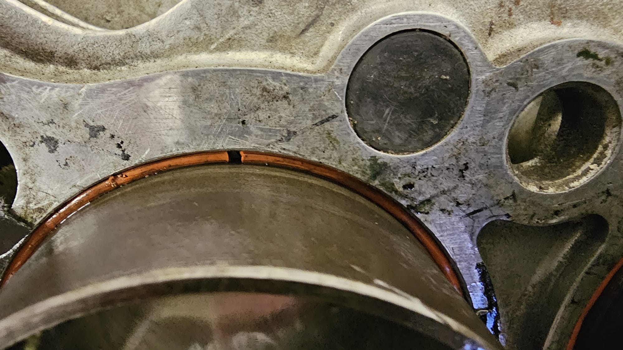

I also noticed that one of the 73mm bore O rings is broken, between the liner and crank case (see photo), I not sure that this could be causing smoke on all cylinders though.

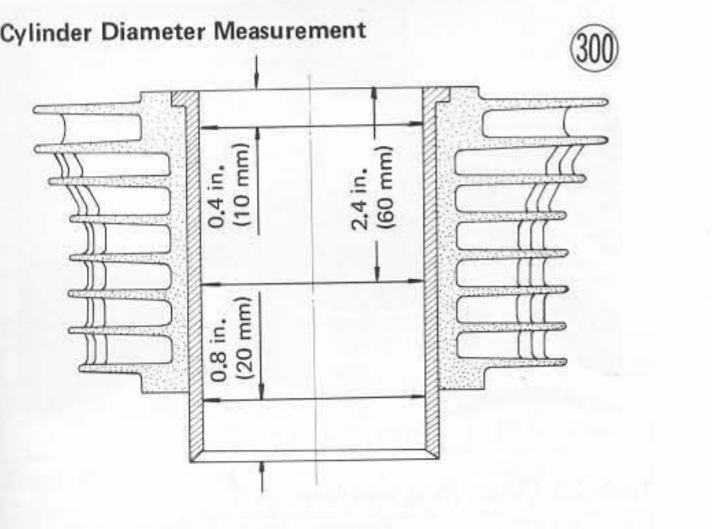

Service limit is O. 1mm over bore size. So if its 0.5 over then service limit is 66.6mm.
A borescope isn't likely to tell you much you need accurate measurements not a visual inspection.
Measurements should be taken both L to R and F to B at three height positions.

As the bores are in tolerance and looking good my next step was to fit new rings. Problem is the pistons are ART and I am unable to source any rings for them. It looks like I will have to replace the pistons as well, maybe IMD ones at £228 for 0.5 oversize.

No evidence of blow by on the ring lands - normally you would expect to see some burned oil deposits if you had a cylinder bore / ring issue. (none visible in pictures)

The "o" ring at the base of the cylinder liner should be replaced, obviously, but almost certainly is NOT the cause of the problem.
