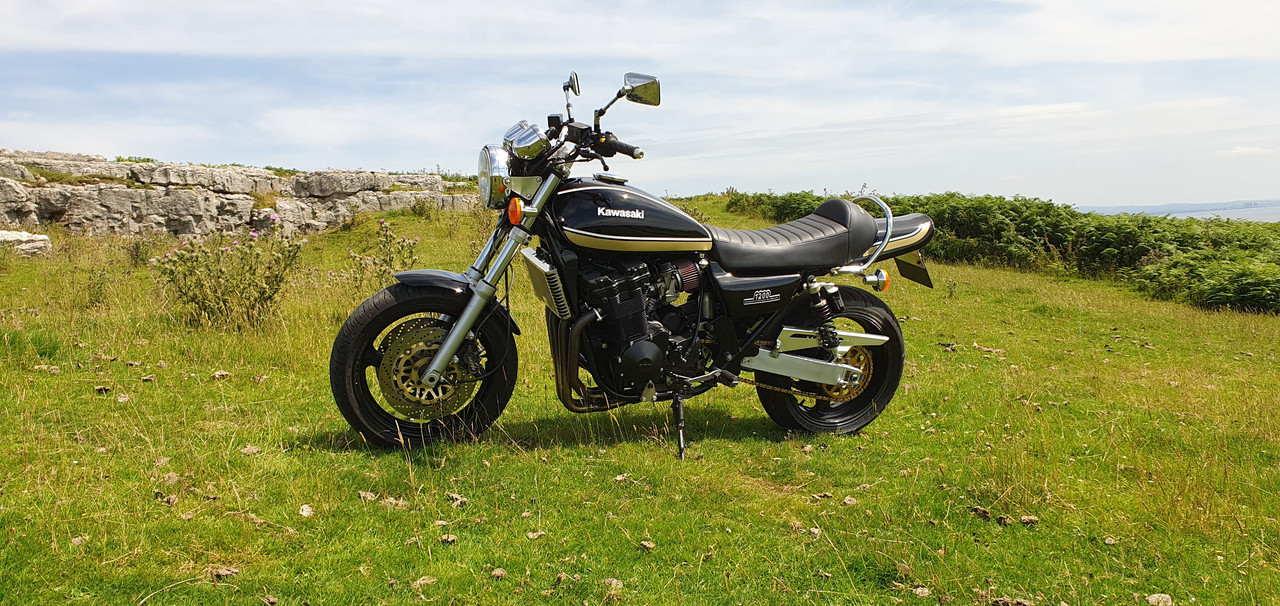

its a bit of a mish mash. the frame is z1000j but its got z1000 later side panels on it and an early z1A tank.(i think)
its the one without the key lock
i just preffer the look of the bulbous side panels, but given that the frame has just been coated i dont really fancy moving the mounting points.
i also dont want a second hand tank thanks.

baldrick wrote:yeah, thats the one im on about Tony....![]()
did you have to make mounts for the side panels to fit also or did they fit into the J mounts??
bloody hell didn't realize it was you Allen
yeah the bottom brackets i made and bolted on, I should of had better ones welded on before the powder coat

Hi Baldrick , if its a J frame with an early Z1 tank, then the underside / tunnel area of the tank will have a bit of "modification" to fit over the top tubes of the J frame. Its not unknown - and the only way to put an early tank on a late frame - but it means you have to modify any replacement tank in a similar manner - assuming you don't just go back to a J type late tank. If you get time, it'd be good yo see a couple of pics. of the tank underside ! It was at one time, something people did but in modern times with so many owners going the restoration route, examples of these modifications are few and far between - it would be good to see how it was done.
As for the side panels, if you remove the airbox and run individual filters (and "standard" is no longer aa concern) 3 or 4 carefully drilled / small holes drilled at carefully judged positions on the edges of a side panel will see anything fit anything just about with 3 or 4 cable ties to secure the panel to the frame - you see this in old pictures of modified Zeds sometimes especially race bikes. Works every time !
