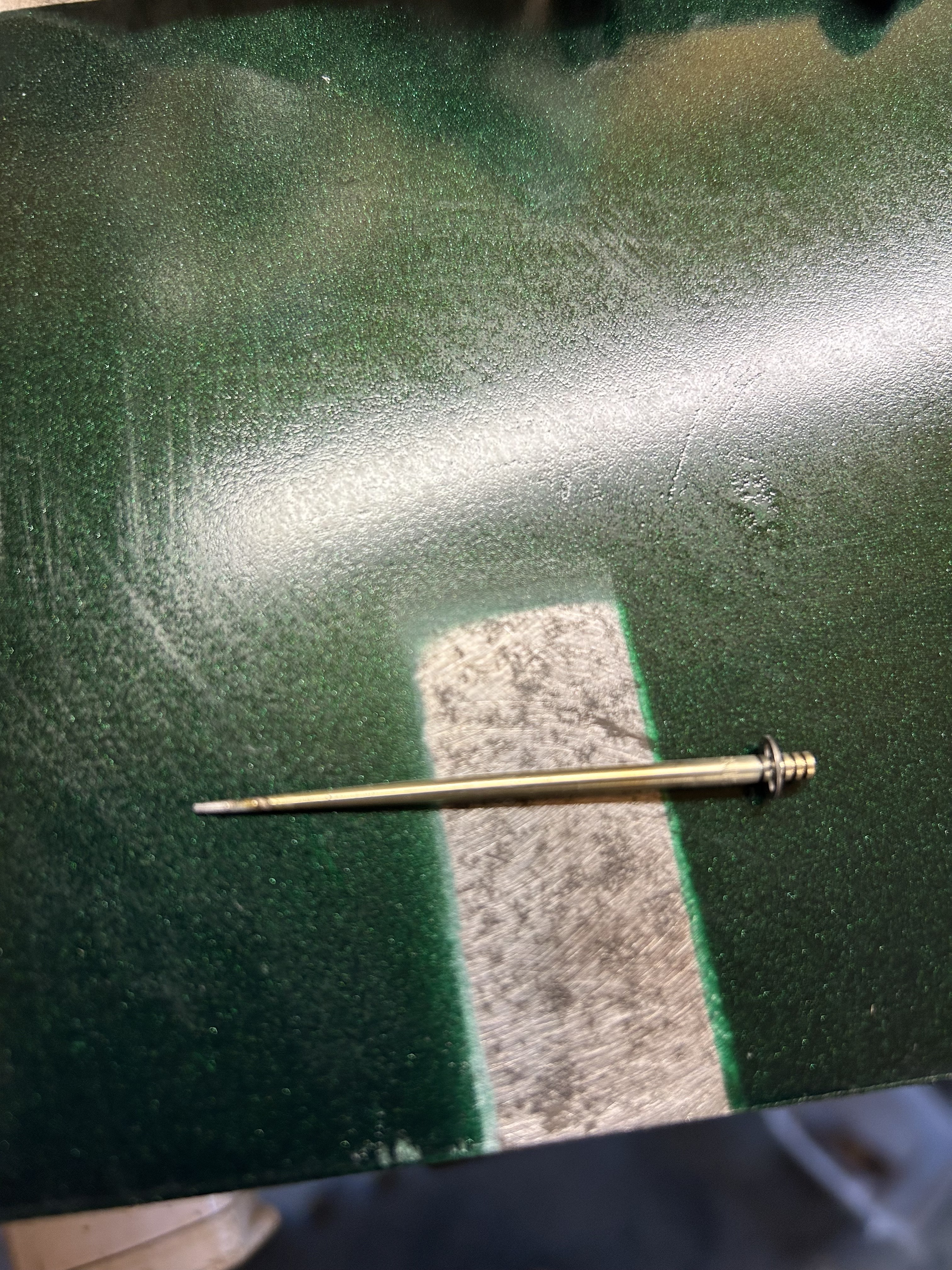

#4 PostAuthor: Mark W » Sun Oct 06, 2024 3:37 pm
I have replaced original parts that the bike was running 105 main and the restrictor but still no improvement.The last thing was the needles which seemed to be 5CN15 instead of the Y63 that came with the kit.On replacing the original needles they were not in good shape,one wasn’t straight and one had a repair with solder I think.So now I am looking for replacement for 5CN15 which I understand is discontinued

#5 PostAuthor: warren3200gt » Sun Oct 06, 2024 4:25 pm
Think the khi number is Kawasaki 16009-1009.
Google and plenty come up on ebay NOS with cross reference part number 5CN15

#6 PostAuthor: Mark W » Sun Oct 06, 2024 6:25 pm
Thanks for your help warren,found 4 original needles which should solve the problem,when it’s up and running might reduce the main jet size(it used to run a bit rich)
