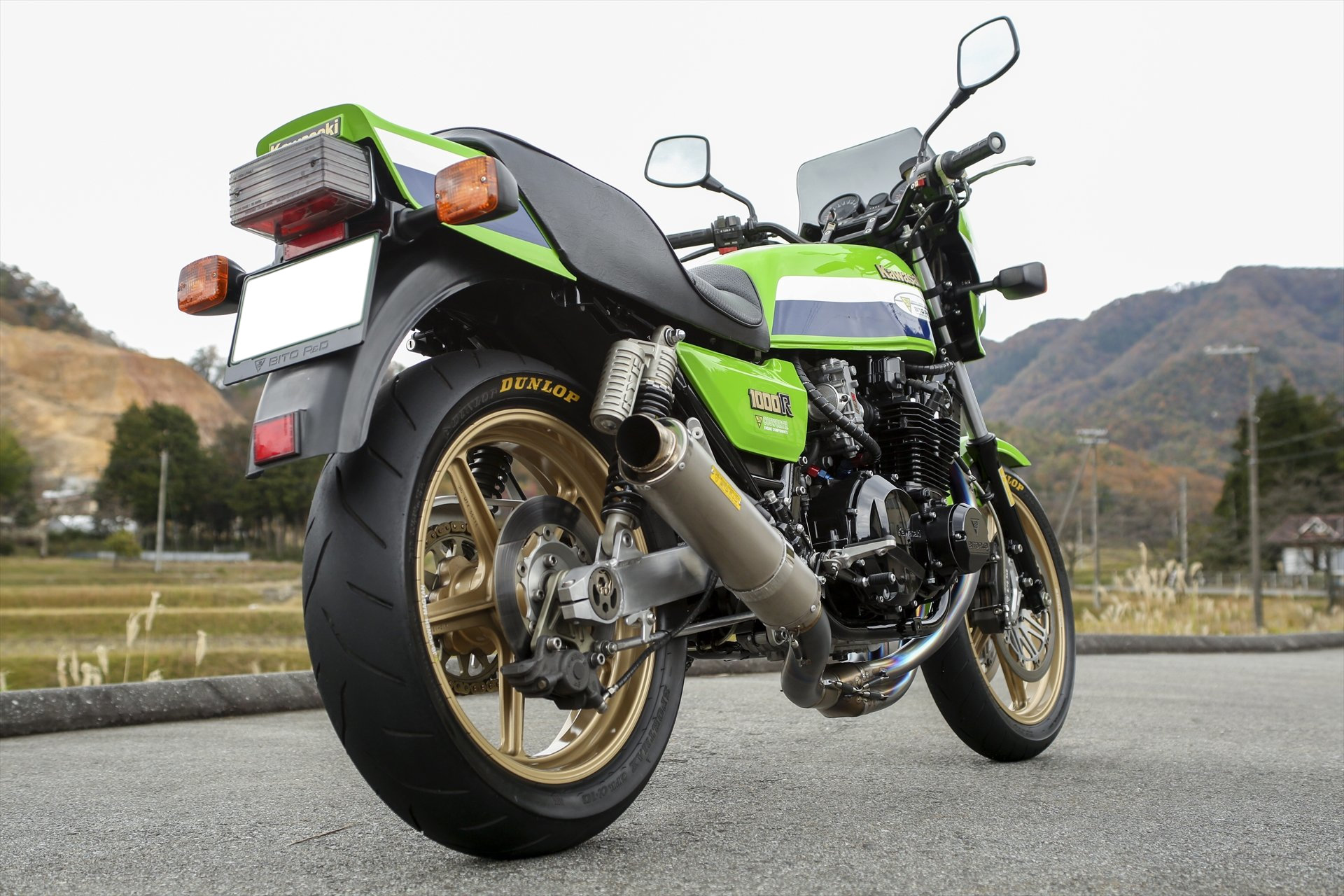

Rear indicators mount on the tail light bracket.
83 brochure Internet 2.jpg (28.26 KiB) Viewed 2346 times
Re: Z1100R help ?
#3 PostAuthor: ADRIAN H » Fri Jan 10, 2025 5:52 pm
Pictures of the rear end, of a Z1000R - same mount on Z1100R
