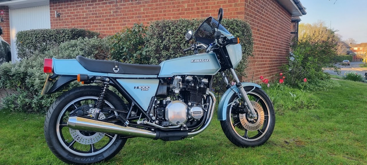

#8 PostAuthor: Sifu » Fri Jan 24, 2025 1:40 am
That’s a nice z1r wheelysteve
