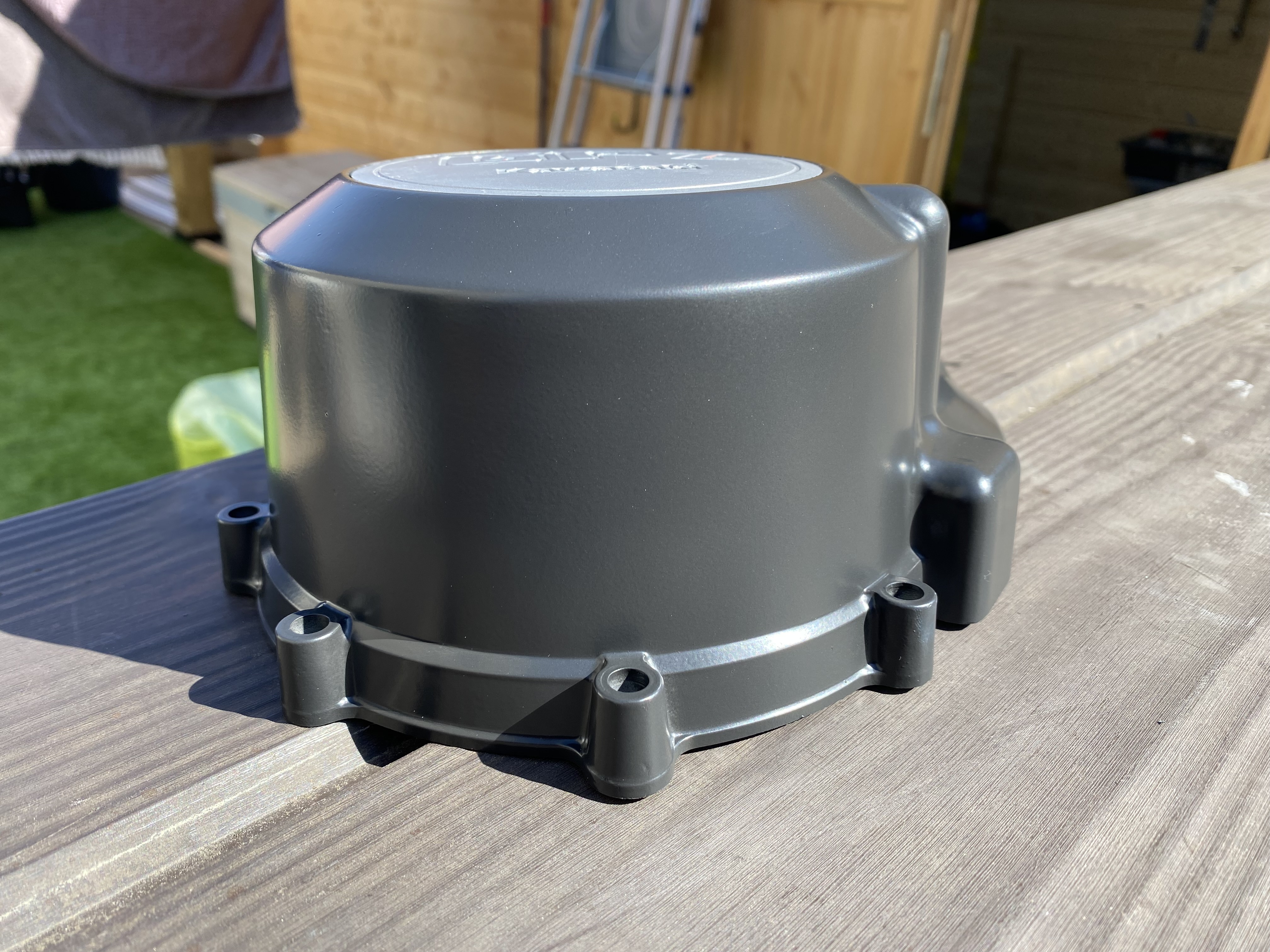

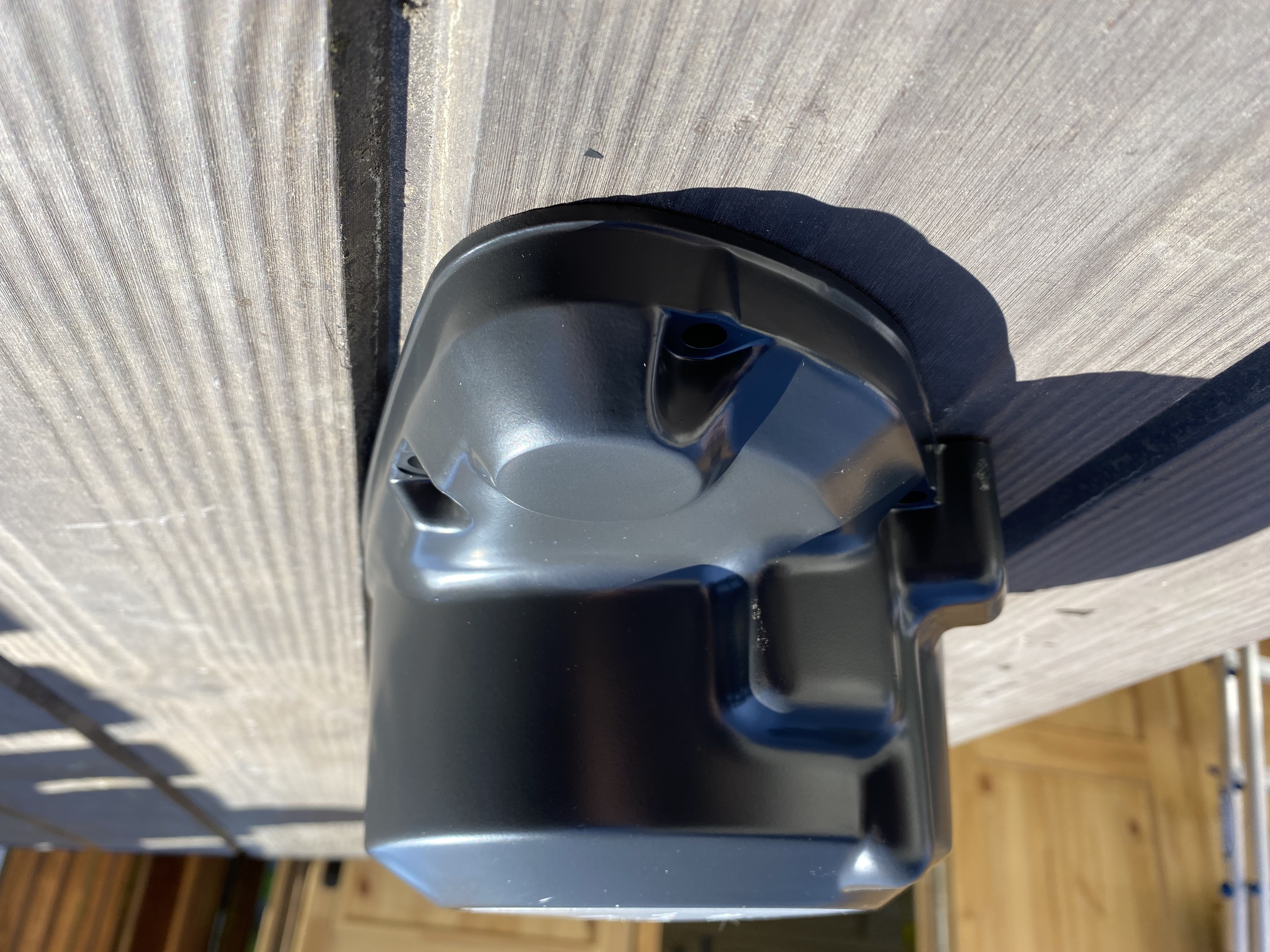

I painted my engine casing with cerakote came out well

stusco wrote:I painted my engine casing with cerakote came out wellIMG_1168.jpegIMG_1173.jpegIMG_1172.jpeg
Looks real nice!

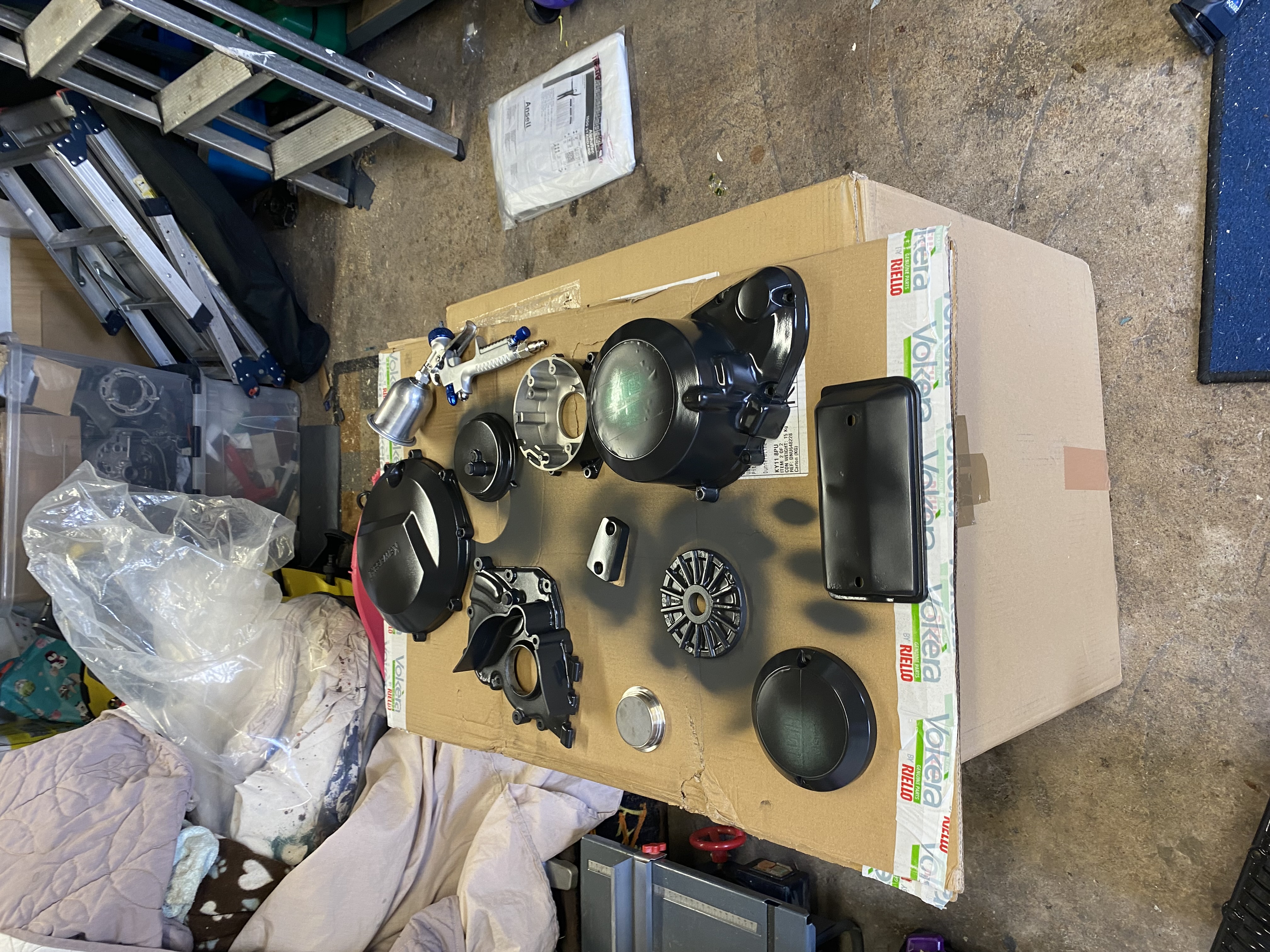

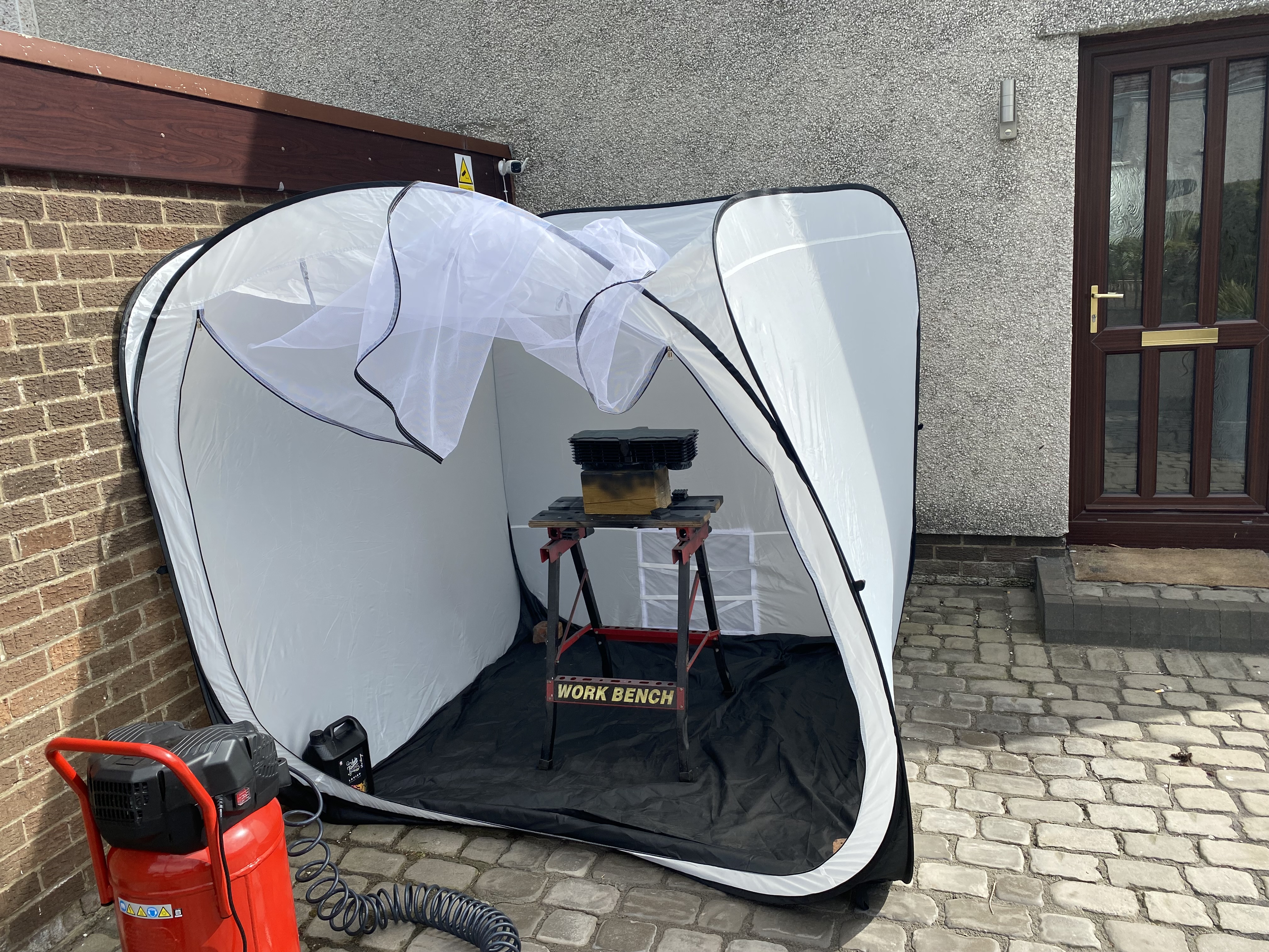

Im using the air dry stuff ,i got it blasted and spent a couple of weeks cleaning and rinsing then bathing it in acetone in a big tub (not submerged )until i was sure there were no oils left . I had bought a pop up spray booth
So had a go ,there was very little overspray with the starter gun i used using c series air dry it take 5 days to cure but can be flashed in the oven , you could spray this outside in good weather with just a dust sheet down there was no mess,im ok with a rattle can but the spray gun was no problem,best to have a lot of stuff ready at once as you need to clean the gun afterwards.

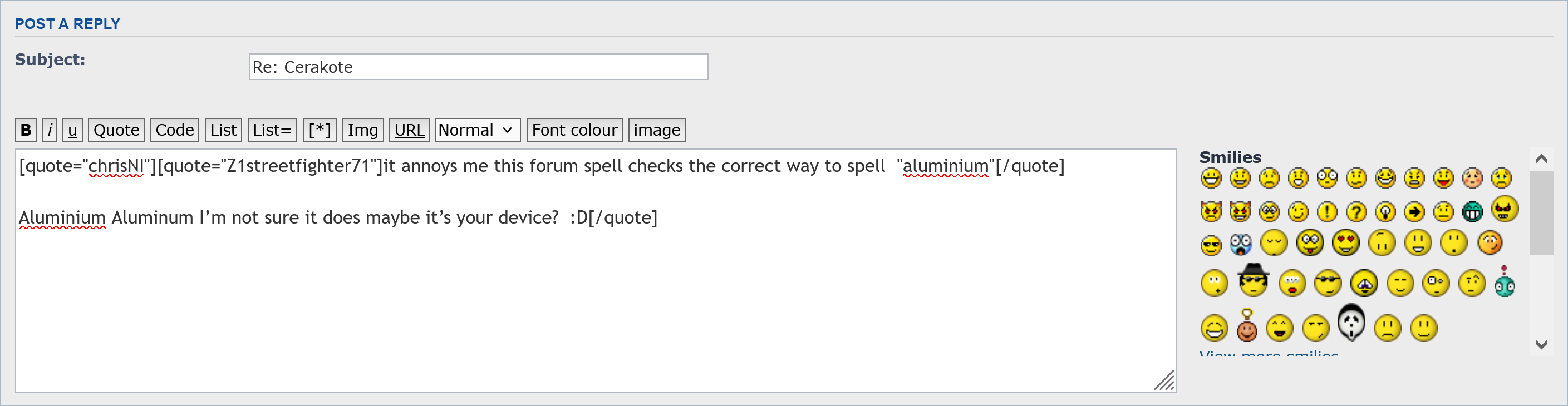

Z1streetfighter71 wrote:it annoys me this forum spell checks the correct way to spell "aluminium"
Aluminium Aluminum I’m not sure it does maybe it’s your device? :D
Posts: 1044
Re: Cerakote
#11 PostAuthor: Z1streetfighter71 » Fri May 23, 2025 10:58 am
Microsoft PC set on UK English mode, f***ing yanks trying to get into my head :Oo :hah! even your response had a promt.

stusco wrote:Im using the air dry stuff ,i got it blasted and spent a couple of weeks cleaning and rinsing then bathing it in acetone in a big tub (not submerged )until i was sure there were no oils left . I had bought a pop up spray booth IMG_1167.jpeg
