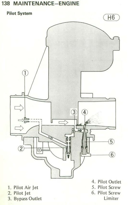

Scott whilst that specific instruction isnt actually used ,, look at page 136, cutaway drawing H6 Pilot system and it becomes pretty apparent what the effect of adjusting either way is

I think this is Keith's diagram - "a picture paints a thousand words"
And gives another name for the screw as 'pilot screw'
