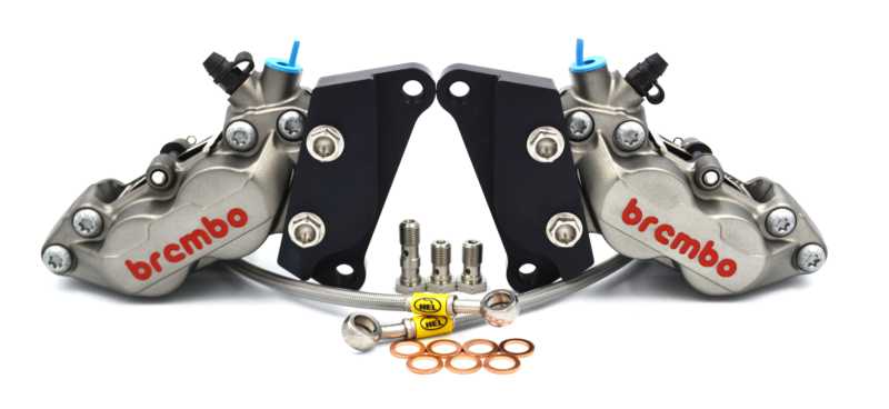

Posts: 1057
Re: Brakes
#9 PostAuthor: Z1streetfighter71 » Mon Aug 11, 2025 5:55 pm
Not to be pedantic but why? the zrx1200 calipers are more than adequate and the Brembo set up is around £722.00
https://www.ebay.co.uk/itm/134743109419
