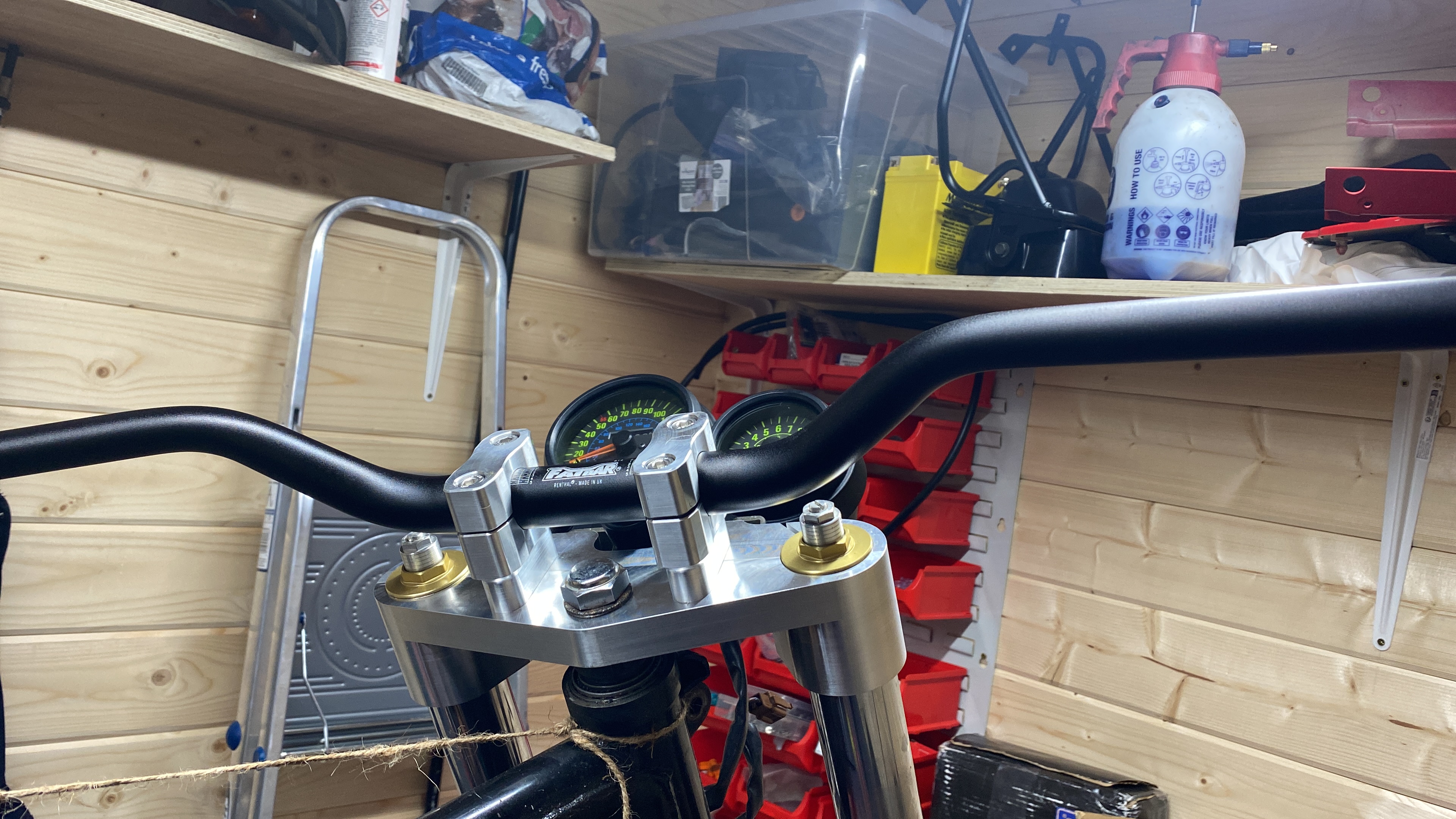

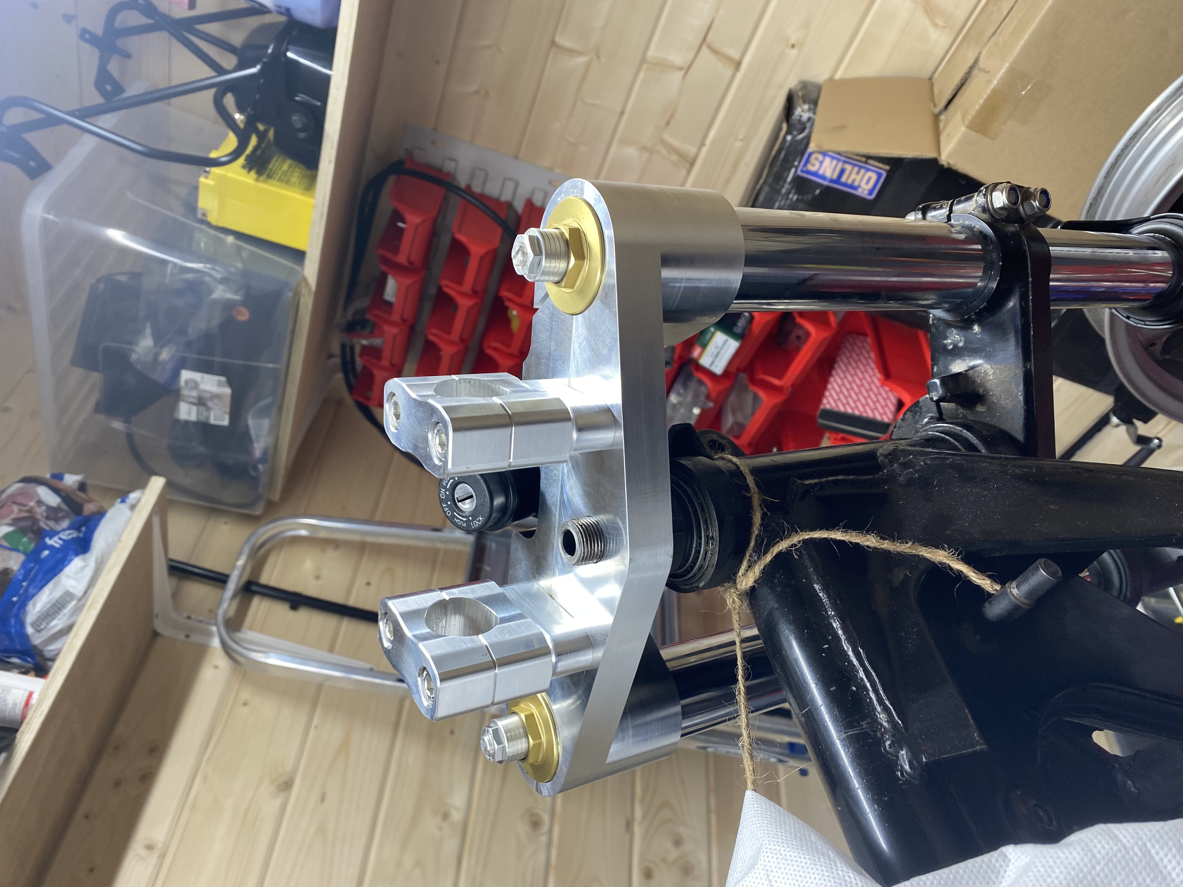

So ive got zrx1200 daeg forks on my gpz1100 i got a nice top yoke made to take the ignition and clocks now im onto wheels and brakes,ive got zrx1200 wheels new discs now im looking for calipers preferably Brembo but it turns out the mount holes are 63mm and there are very little brakes out there ! Would you open out the mount holes to take 65mm brake as there is a wide selection?
