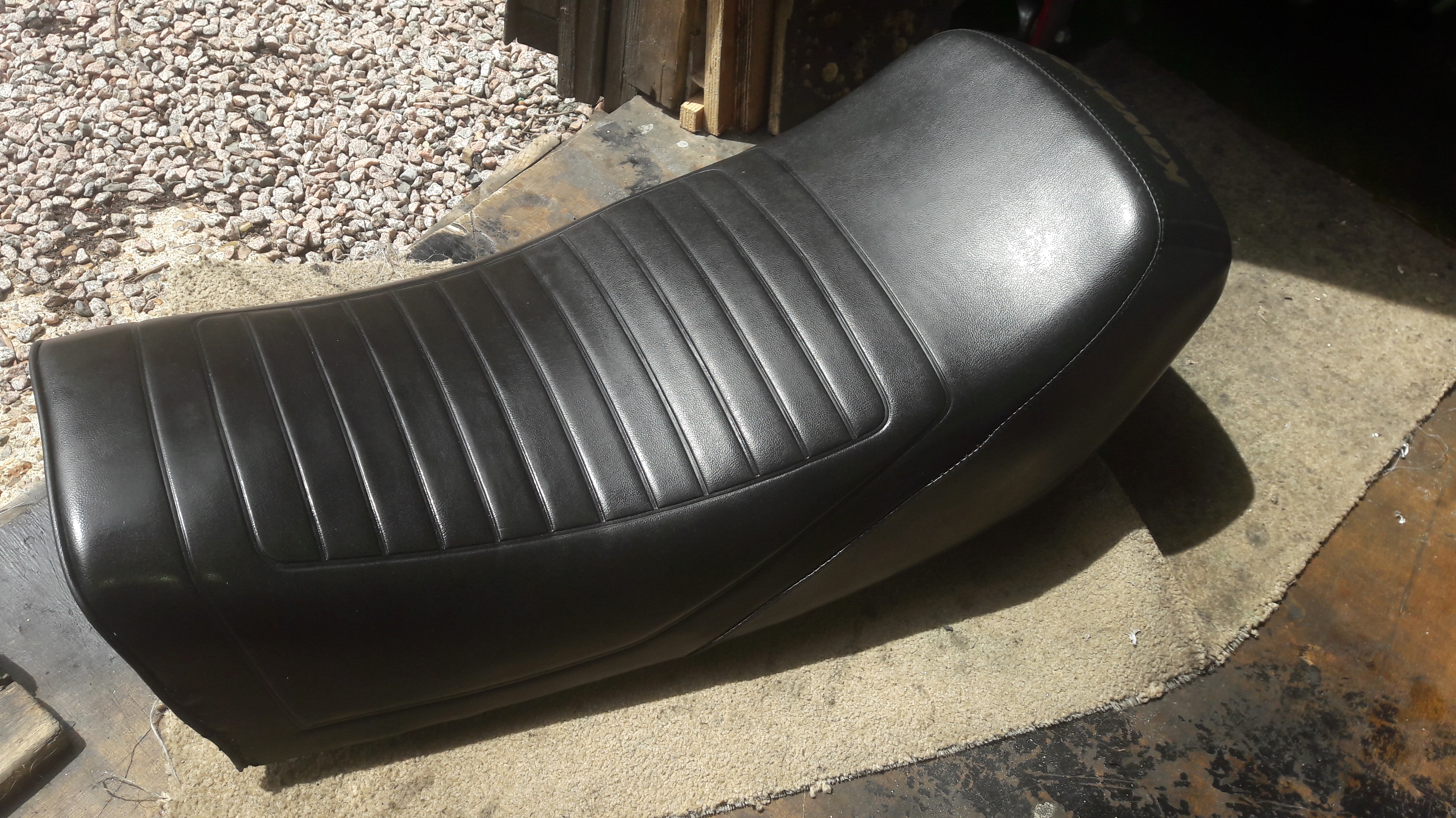

If you are ever thinking of selling your seat please give me a prod. Cheers mate
Posts: 3110
Re: Rear spring refinishing
#10 PostAuthor: warren3200gt » Fri Oct 10, 2025 7:20 am
Simonic wrote: If you are ever thinking of selling your seat please give me a prod. Cheers mate
Original 2:4 Not for sale.
