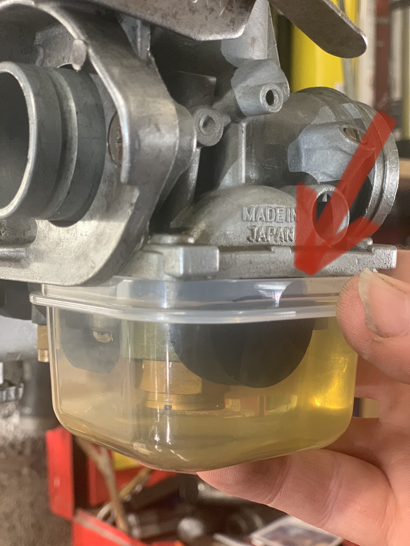

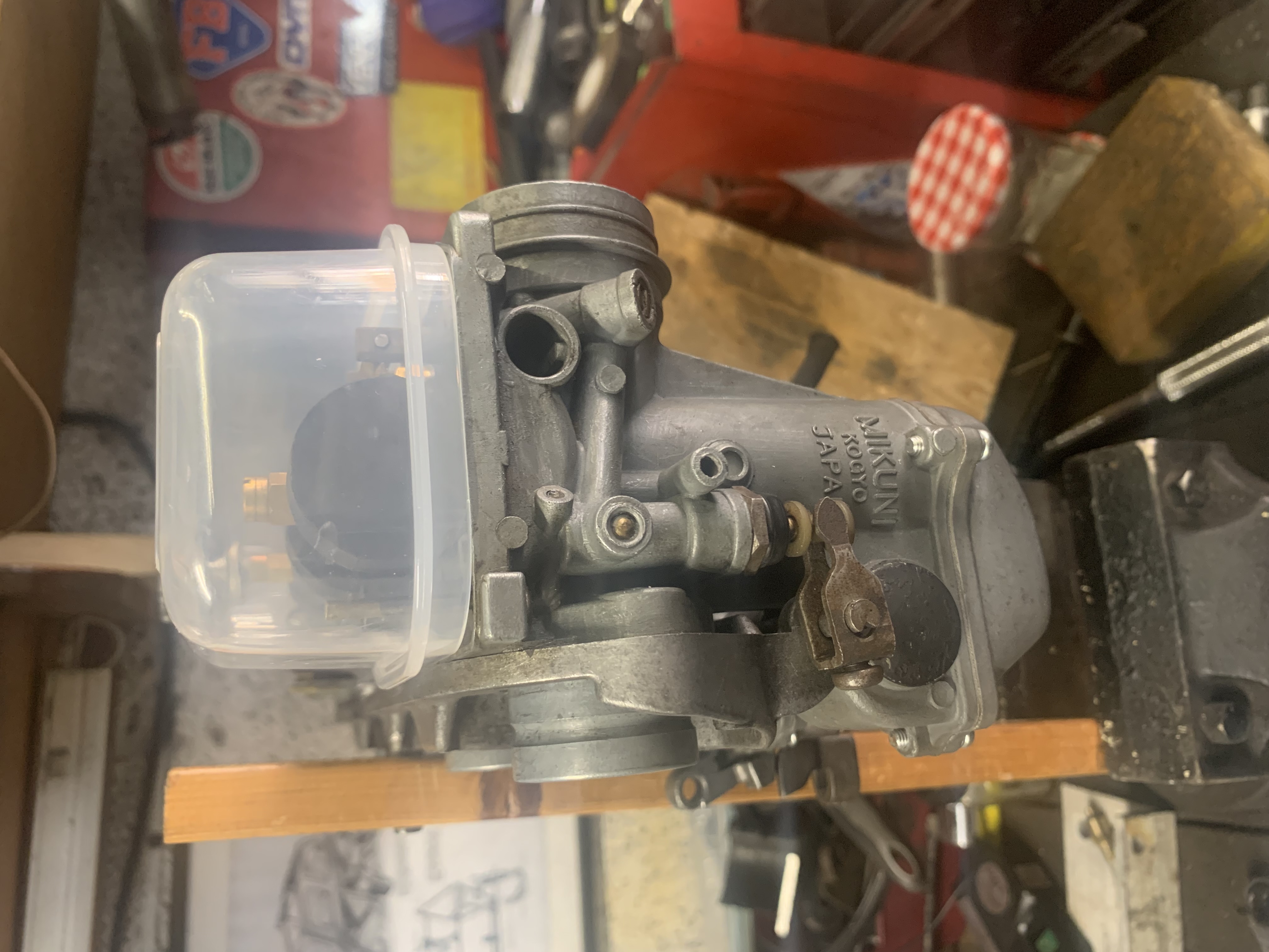

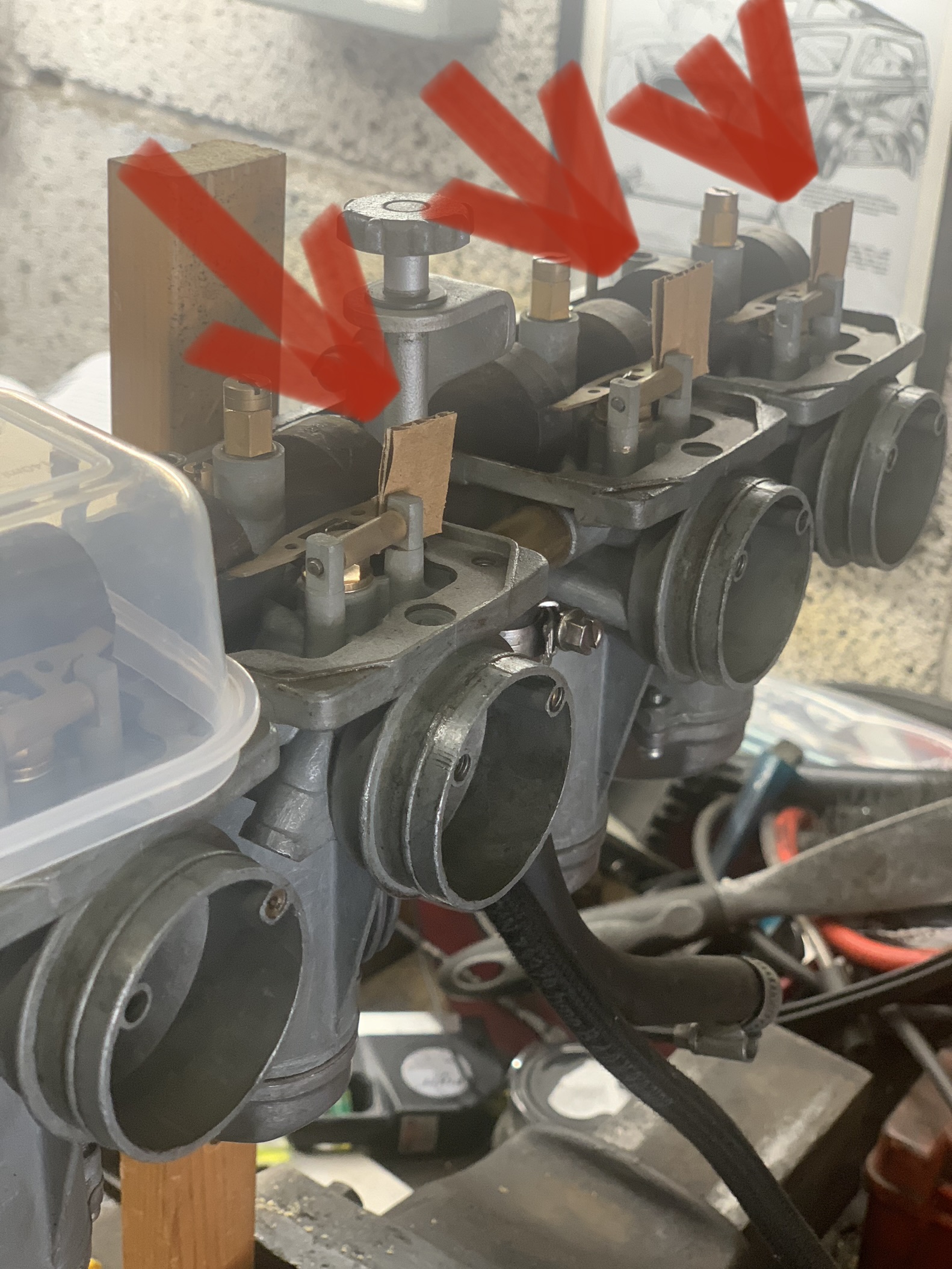

I've been reading this thread with interest as I am also experiencing similar running issues. The thing that is the most frustrating and from the comments in this thread many others will agree is the inconsistent measuring of float height from a static to a wet height. I purchased a "tool" for wet measuring and it is now in the bin as it's impossible to get a steady reading... In my moment of frustration I came up with a way to see and read a float height measurement in real time so to speak.
I mounted the bank of carbs on a wooden batten fixed in a vice so the bodies are in a near horizontal plain.
Cut some small squares of card to use as shims on three of the floats to effectively close them.
Orientate the carbs the correct way up.
Connect a fuel supply and hang up higher than the carbs.
Hold a clear plastic food container of a similar size to the carb body and turn on the fuel.
Watch the bowl fill up and close off showing precisely the distance below the edge of the body.
As the card is holding the other float valves closed you can easily measure all four carbs without having to mess about as all you have to do is pull the card shim from the carb you want to test leaving the others closed.
I marked a line at +3mm down from the rim of the plastic container as a guide.
You can see exactly what's going on and where the cut off height of the fuel is.
For my carbs with new Keyster valves and seats the static height is at 27.5mm to gain a correct wet height.
Hope this is of use and apologies if it's been suggested before.
Cheers, Rob/Bert
