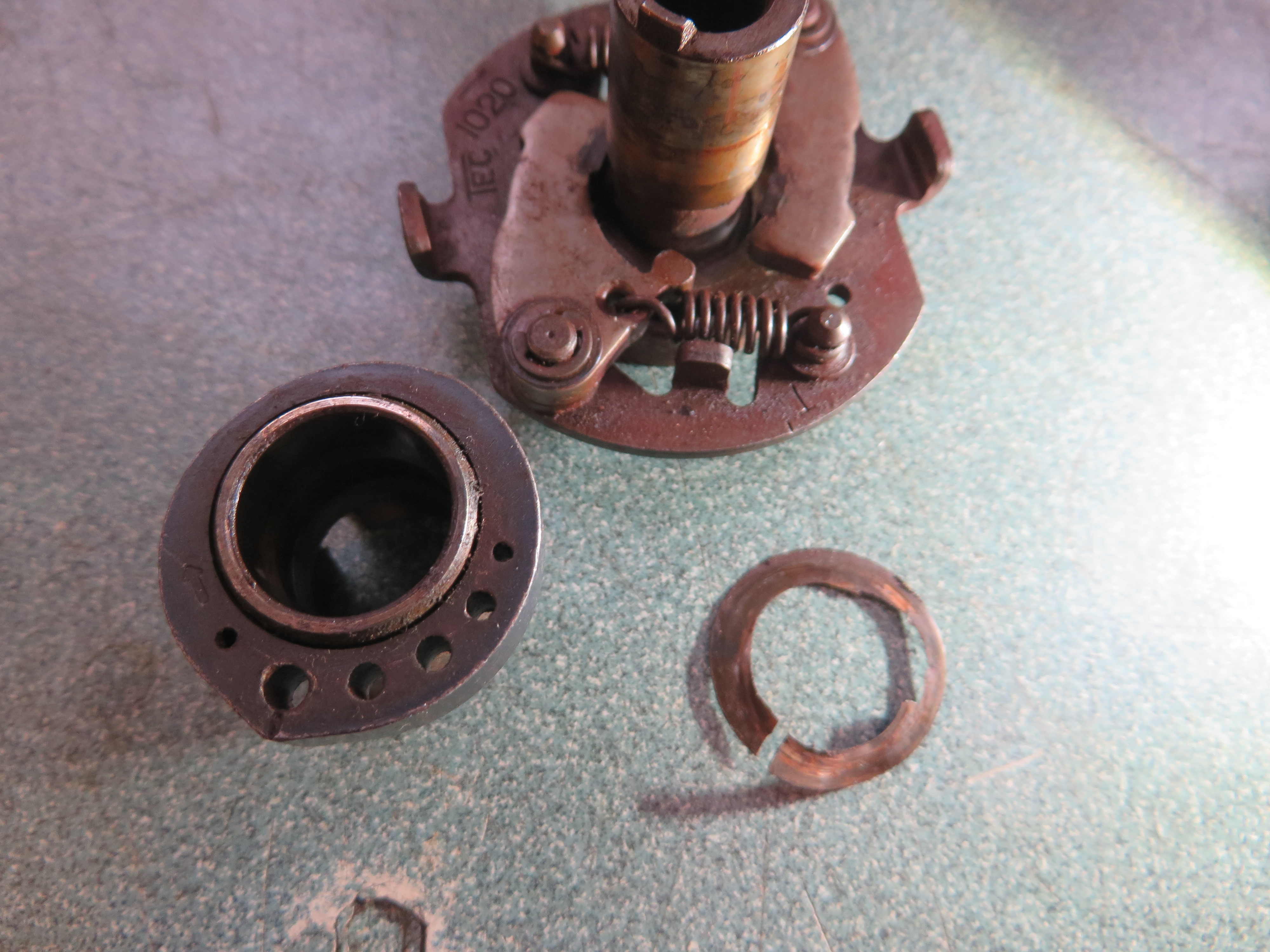

Whilst you in there with the baseplate out you might pull the cam and see if you have one of these shim washers in there. Can jam the advance unit when they break. Cam must go back in the same way as it came out!!! Dont follow the picture its probably the wrong way and its also the later J version just to confuse the matter.

Morning Guys, new day and all that!, firstly stripped out and cleaned all new Denso plugs, next removed points plate, cam and advance mechanism, completely stripped and lubricated then re fitted back to bike, i note cam can go either way round, which is silly as the plate itself is keyed, why key 1 part but not both, a simple larger tab on 1 side of cam weights would ensure it will only fit 1 way. Anyway thats all back in now, fittted Zpower contact plate assembly, complete with brand new points and condensors, wiring too, set up points gap static, will time up with strobe later.
