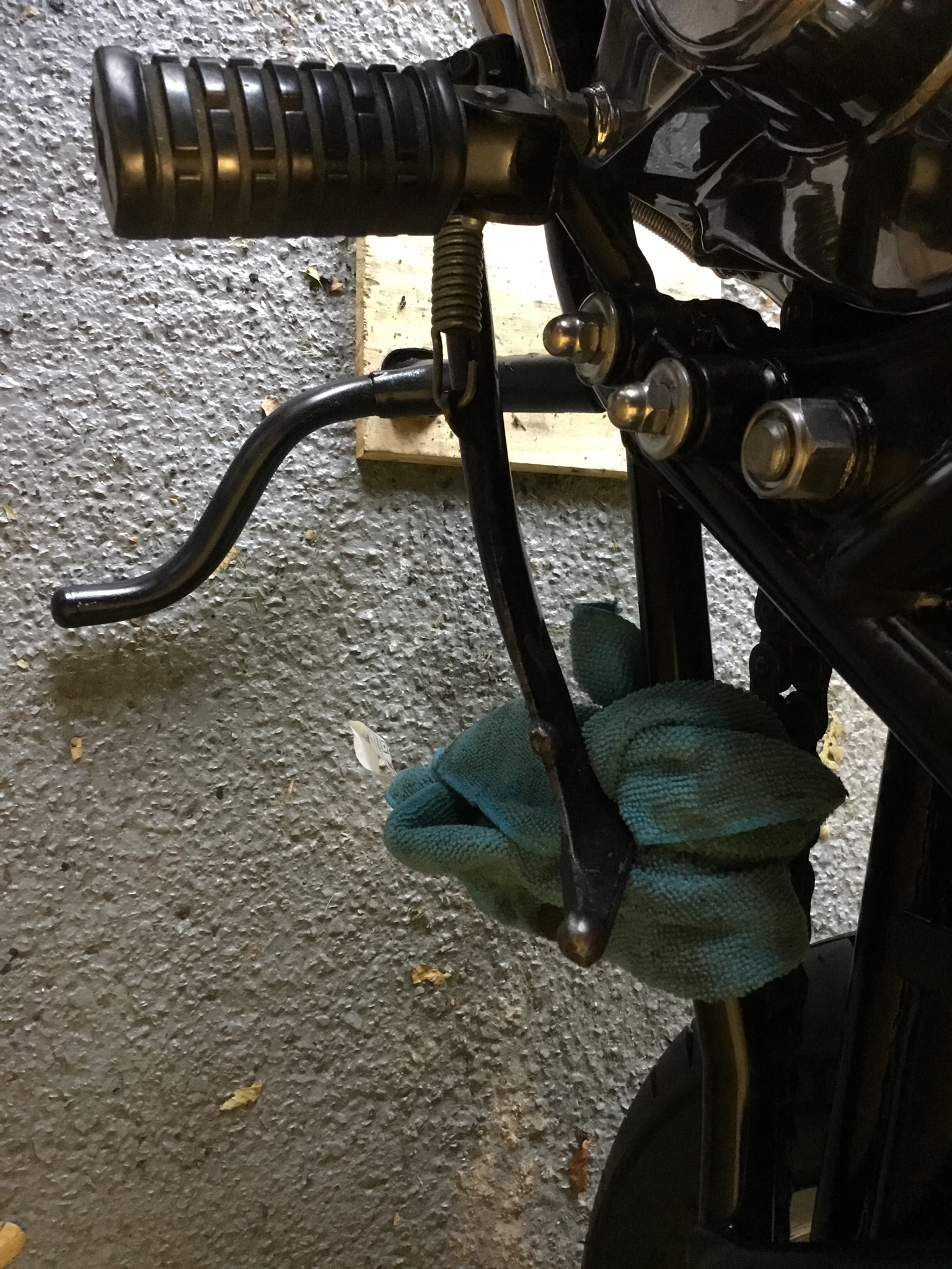

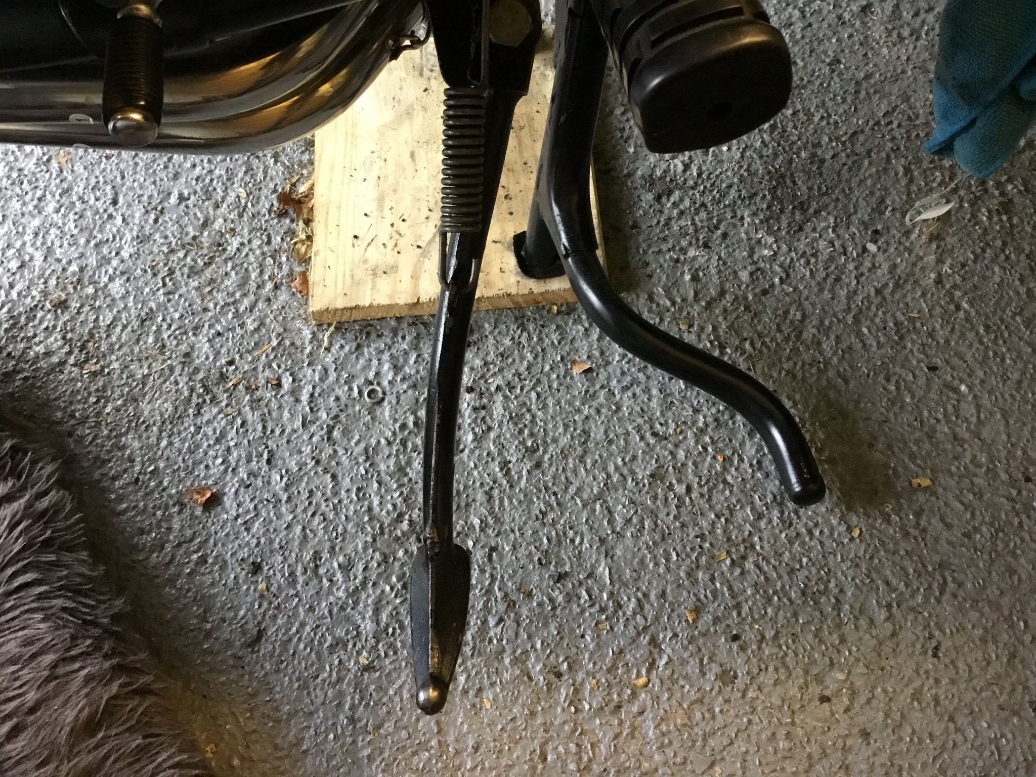

So gentlemen, what d’ya reckon ? Is this a proper Z900 kickstand or a ltd one ? And is it bent, or is it suppose to be slightly curved back like that ?

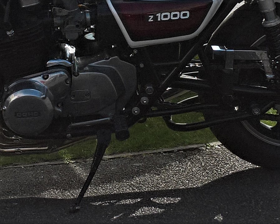

looks bent compared to mine.

It's massively bent. I am amazed the bike will even stand up leaning on that !!! :shock: :shock: :shock:

Thee sidestand on my 900 is bent like that too....

My 900 one is curved like the one in the pics, my 1000 one is straight. Looks like op may have a 900 one on his 1000?

Bit of an update. The new one pitched up today. It’s exactly the same shape as the existing one. It also whacks against the frame when it goes back. Weird ! :roll: Guess My only option is to try and make something to stop it from going back so far. Still doesn’t explain why it’s doing that though when apparently it shouldn’t.

I had a Z1B with a 4 -1 and the side stand hit the frame on it. Fitted a rubber mounted clamp holding a 1975 "Tax Disc" to prevent the clanking !
You could tap out a 6mm hole in either the stand bracket or if possible the stand itself and fit a grubscrew and lock nut to limit the closed position of the stand.

Funilly enough I’ve just come back in from the garage having done exactly that wheelsteve. I drilled and tapped a hole in the stand and it works a treat !
