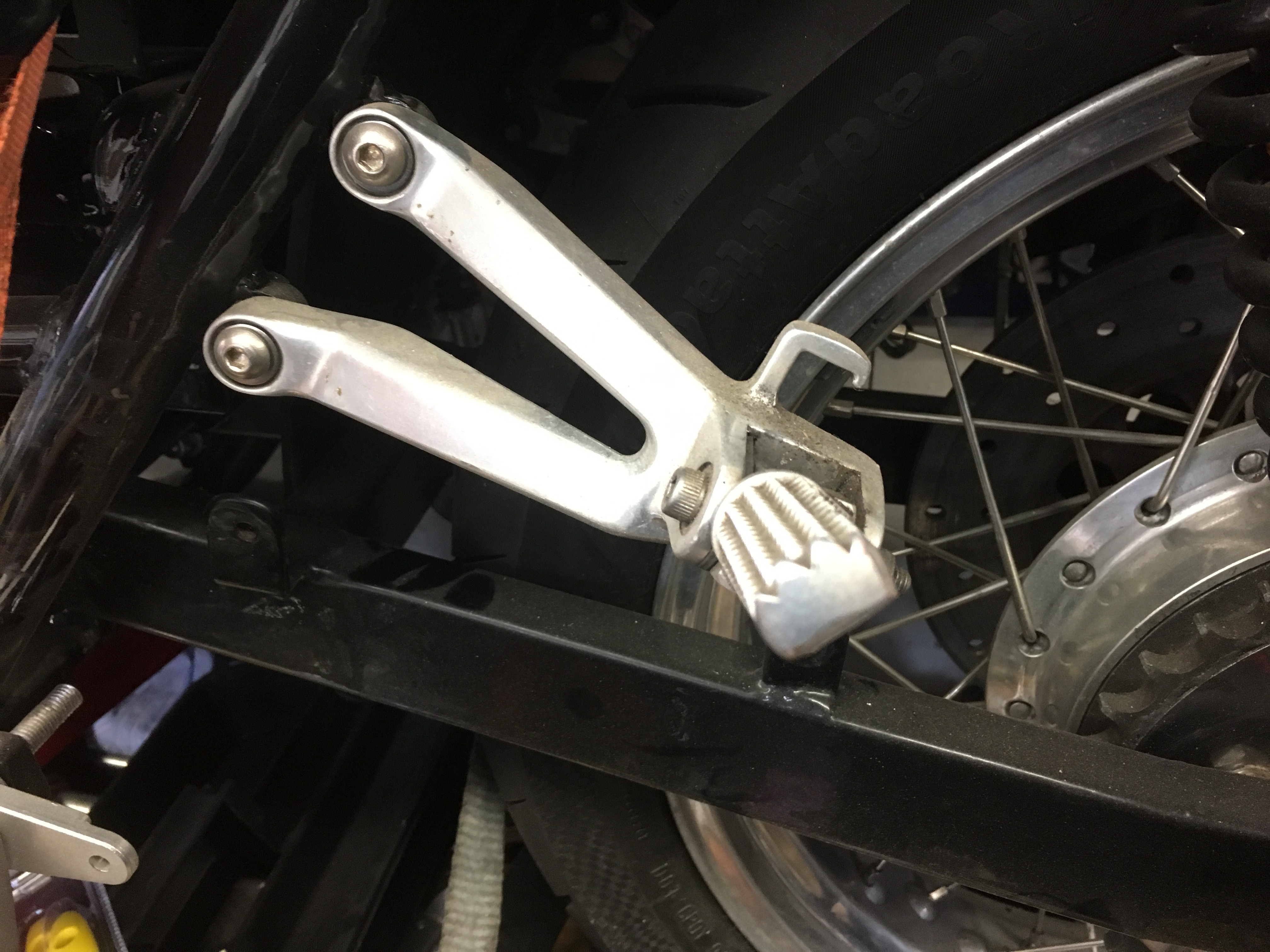

These are Yamaha r1 pegs fitted to myz1000

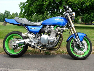

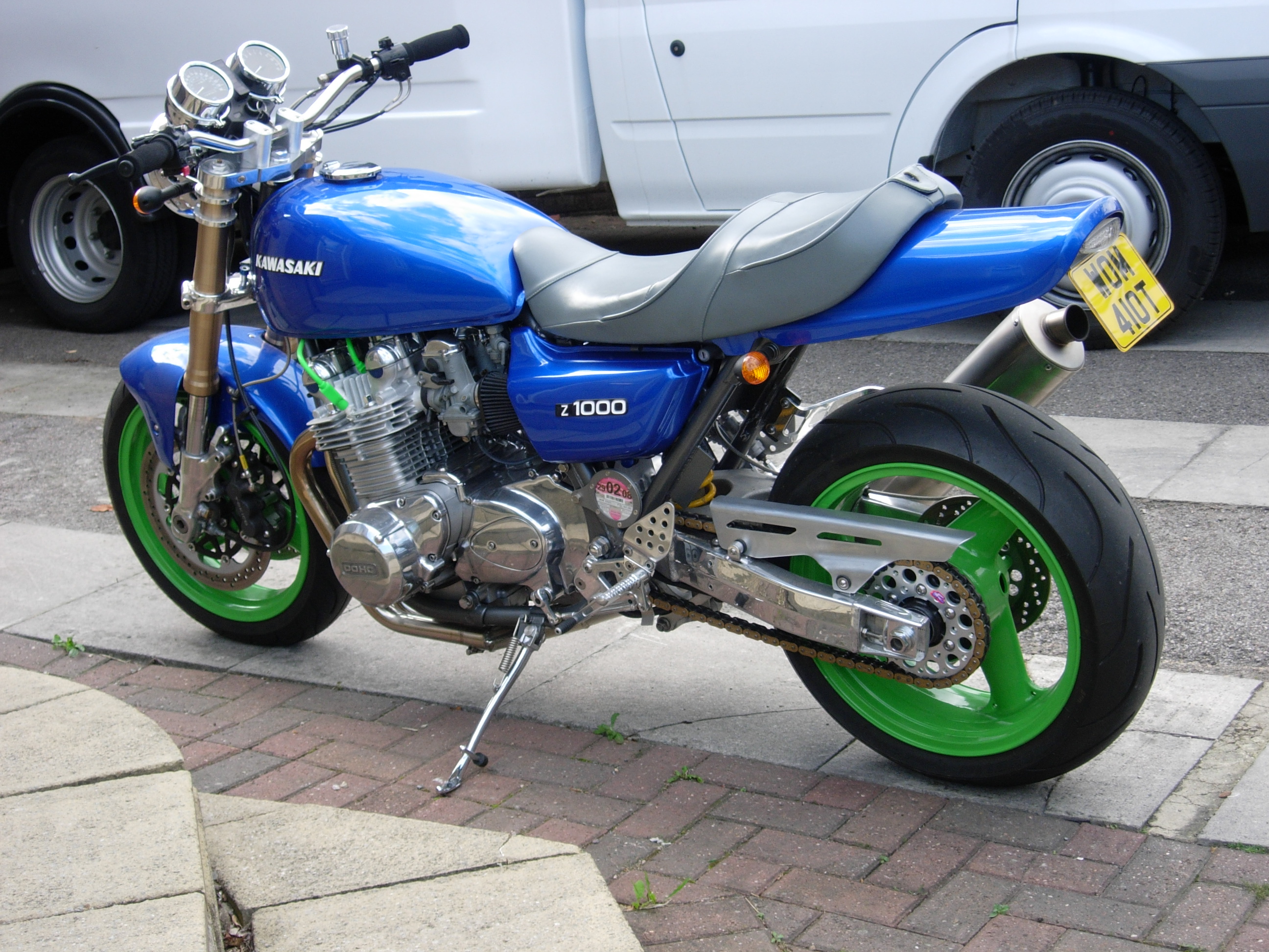

Found this one of an early Z1000 project. You can just see the tab welded to the frame rail & at that point undrilled (probably because I hadn't decided what was going on there at the time.)
Here's another, I think with R1 rear pegs attached. (Sorry it's so small :oops: )
# 104
