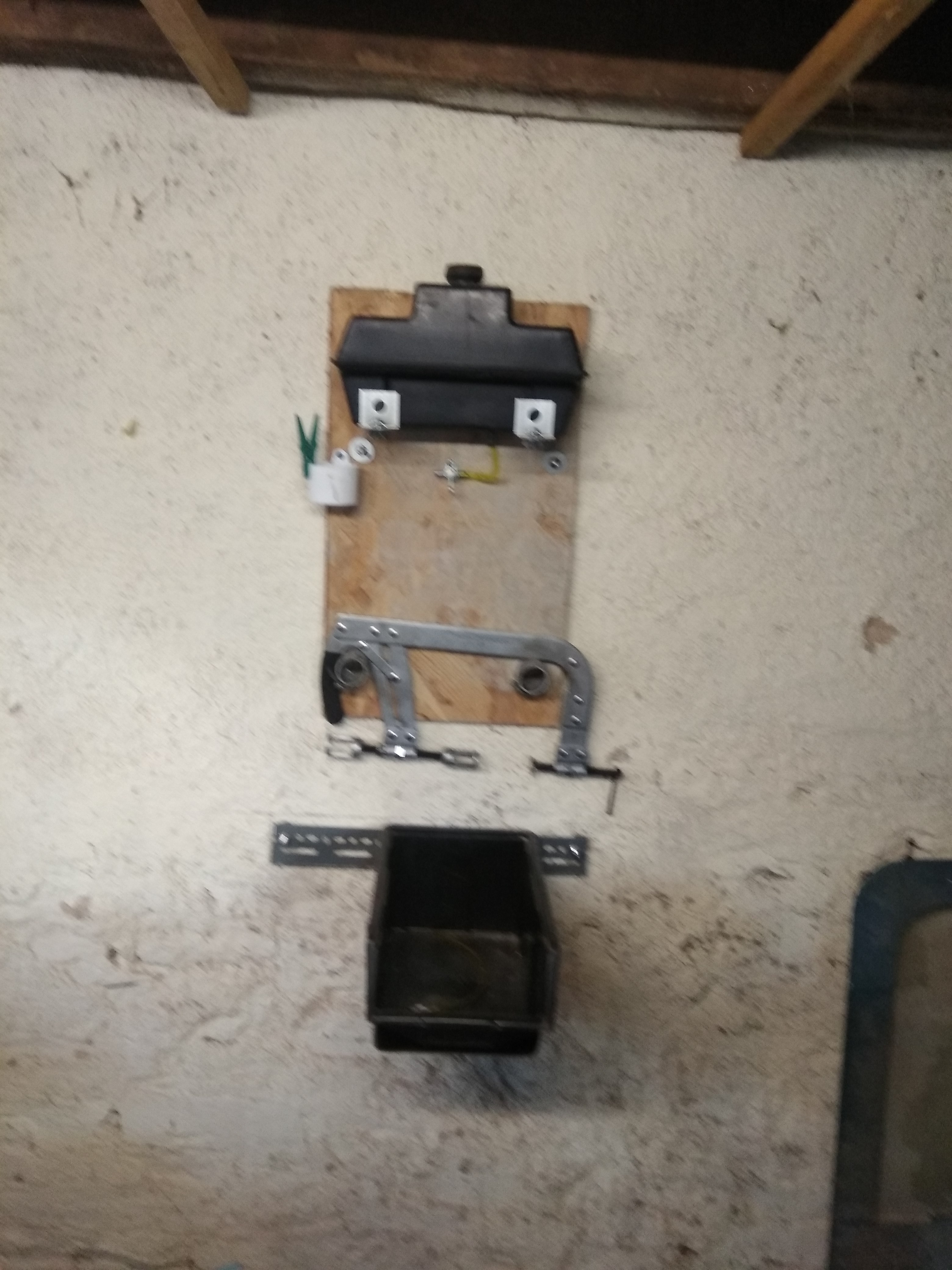

#17 PostAuthor: moizeau » Tue Sep 15, 2020 5:19 pm
This mine, you can also turn the carbs upside down for setting the tangs, without everything falling everywhere.
It also serves as a storage place for a valve compressor.
