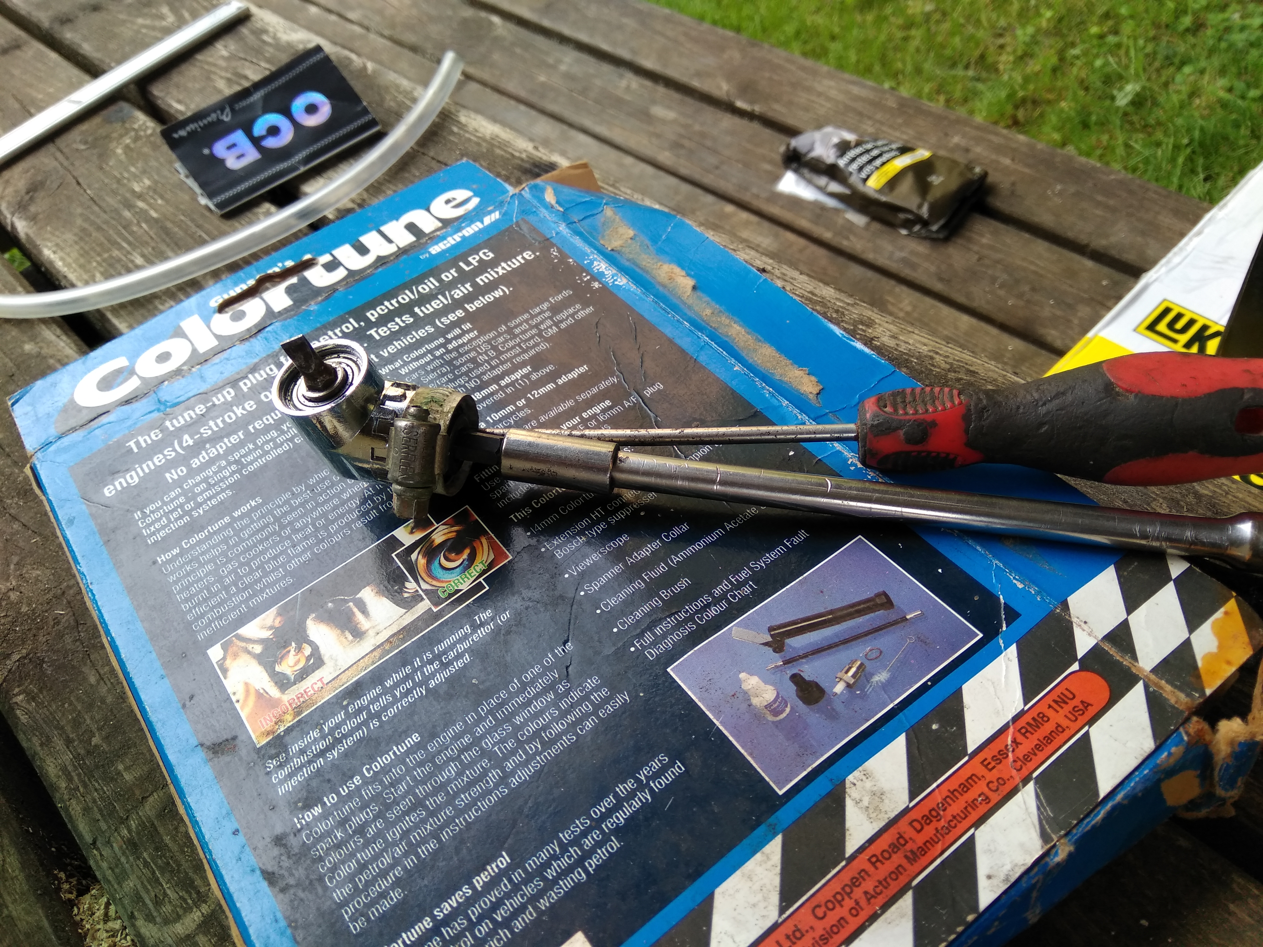

Cheers Al, Getting hold of my mates colortune and just ordered the 10mm adaptor on Prime. I've got about 4cm of clearance under the carbs because of the alternator and the screw is about 5mm up the hole. I've been searching various offset tools for doing the adjustment on the centre 2 pots. A lot of the carb tools like the Laser one doesn't seem to be able to get up the hole.

I started out with the inch snapped off the end of a screwdriver with a square shaft but not enough grip or sensitivity.
Tried these but not enough arc to rotate properly.
https://www.ebay.co.uk/itm/313181830173 ... Sw-rxcG5fv
I settled in the end for the 'bits' from one of those sets you always get in socket sets but have no use for.
https://www.ebay.co.uk/itm/192834129014 ... SwURNdg4FI
You just need to thumb them into the slot.
Never had the micro ratchet as above but discovered you can get longer extended versions of these which you can combine with a 10mm spanner.
Something like on the RHS of this item.
https://www.ebay.co.uk/itm/373548859047 ... %3A2334524
They also do angled versions of the micro ratchet.
https://www.ebay.co.uk/itm/114450178382 ... Sw~2FffZgB

Just had them back on. A new tool arrived today that allows me to set the pilots without burning my hands off. It needed a mod to be able to control the head (note the screwdriver jube clipped) and I needed to take 2mm off the screwdriver bit to get it in to No. 2 but it works. They sell the same thing with a handle but I was concerned the handle would argue with the alternator.

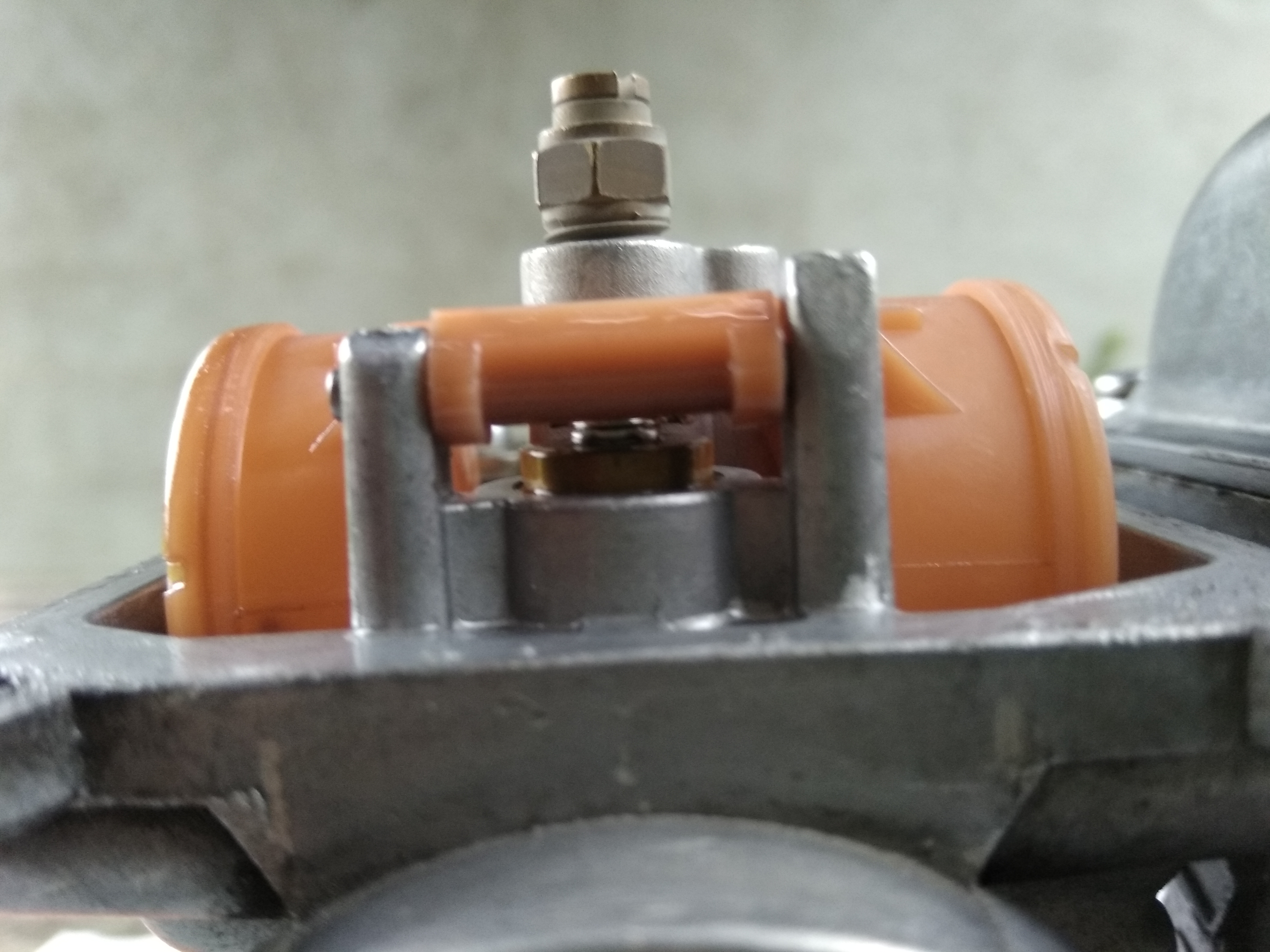

My question about the wire ears on the float needles contacting the rim of the brass seat was a loaded question. Say it isnt so. It will save me banging on about specific gravity where we both end up going down the rabbit hole.

Just been out and photoed the float, the ears don't touch, not even close with my eyes...

How do the new seats look with a magnifying glass? Is the tapered sealing surface consistent and round etc? Any scores in the parallel part?

Update: With the carbs not in a bank I checked each one individually. All have new float valves and a toothpaste clean.I'd set the float tang level to start. Fuel level was spot on on 1 carb, 2 carbs were slightly high (3mm ish) and 1 carb couldn't be adjusted on the tang!
The 2 that were slightly high were brought into spec with a slight tweak on the tang, the other....
Then I noticed the 2 1/2s of the float weren't parallel on the dodgy carb, carefully bent the metal that carries the tang to bring them into line and retested, all is good.
All 4 now have a good fuel height and hold the level, no flooding.
Rebuilt the bank and after much swearing got them back on the bike. I can see why people fit pods, bloody nightmare to stop an airbox rubber getting stuck inside the venturi, but now done.
I've set all the balancing screws and tickover screw to halfway.

OK, so still not there.....but much closer. Can't get a full yellow burn still but can get little coughs of yellow. I've now got the pilots set to 2 3/4 turns, idle seems more or less stable but it still wants to stall after a straight, needs a blip to bring the revs back up around 1000 from 500. Once it's back to 1000 it stays there. So I've still got a blockage albeit a smaller one.
Just wondering whether a bit of injector cleaner or something similar chucked in might help over time?
Any suggestions gratefully received. I really don't want to have to pull the carbs again but I fear I might.
It starts from cold on the button.
One thing I haven't tried, out of curiosity more than anything else, is if I can get a full yellow burn by giving it some choke?
