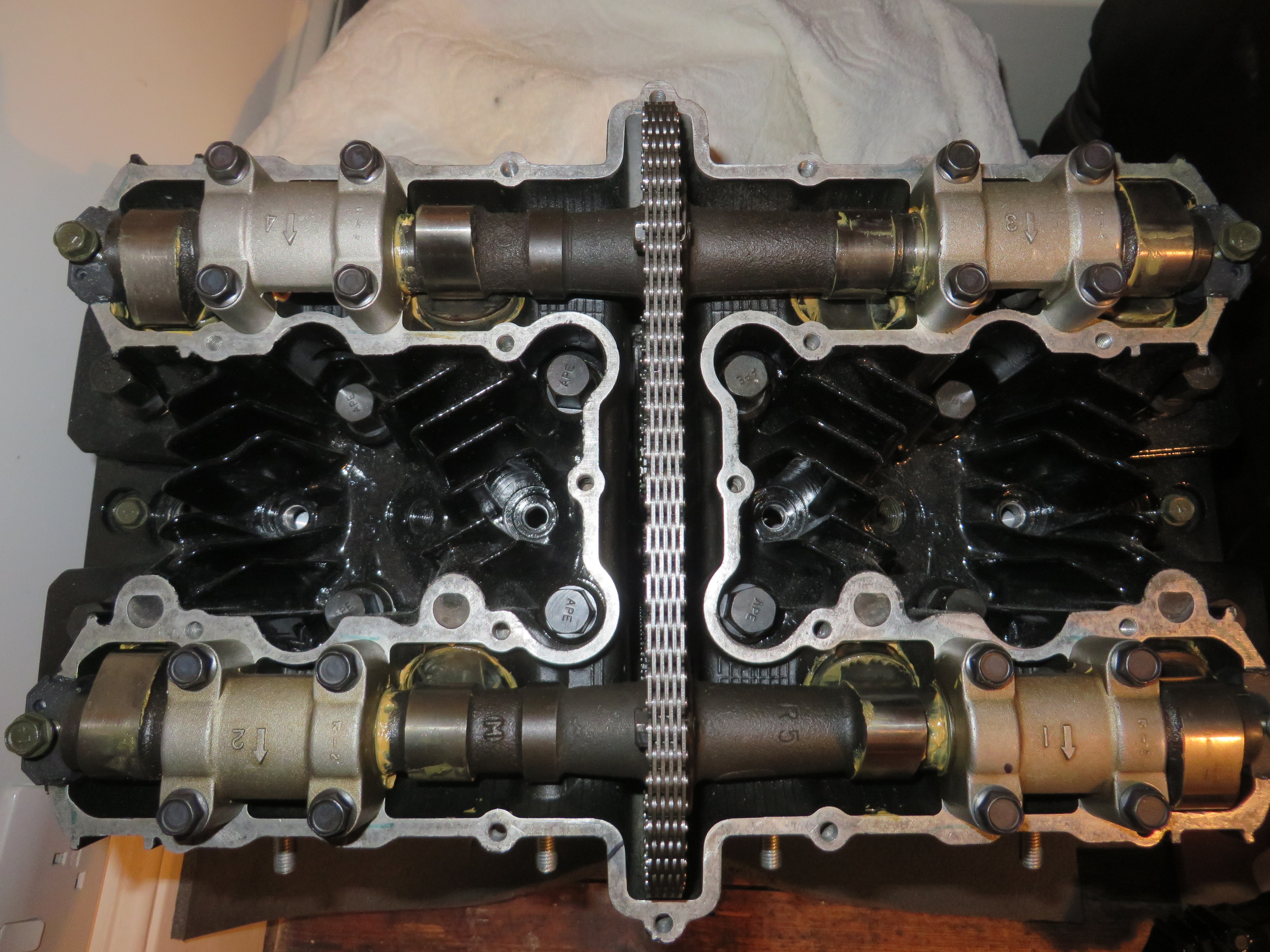

i don't know how gpz1100 a2 cams look like, can anyone post a picture of them, so that i can see if mine are the right ones???? thx in advance

These are Unitrak / 1100R1 cams. There are no grooves or teeth on the 'identifier' boss.

Hi everybody, after 4 hours of removing carbs, oil cooler, ignition coils , camchain cover, i finally could check the valve timing, and it was a little out of specs.
So i adjusted it, like some of you guys had advised me, and with the help of the pictures and the service manual, i managed to get the damn thing right.
Made a compression check, and WAW, the compression jumped to about120 psi on all COLD cylinders, that's fantastic.
I want to thank all of the guys who helped me with advice, remarks and pictures.

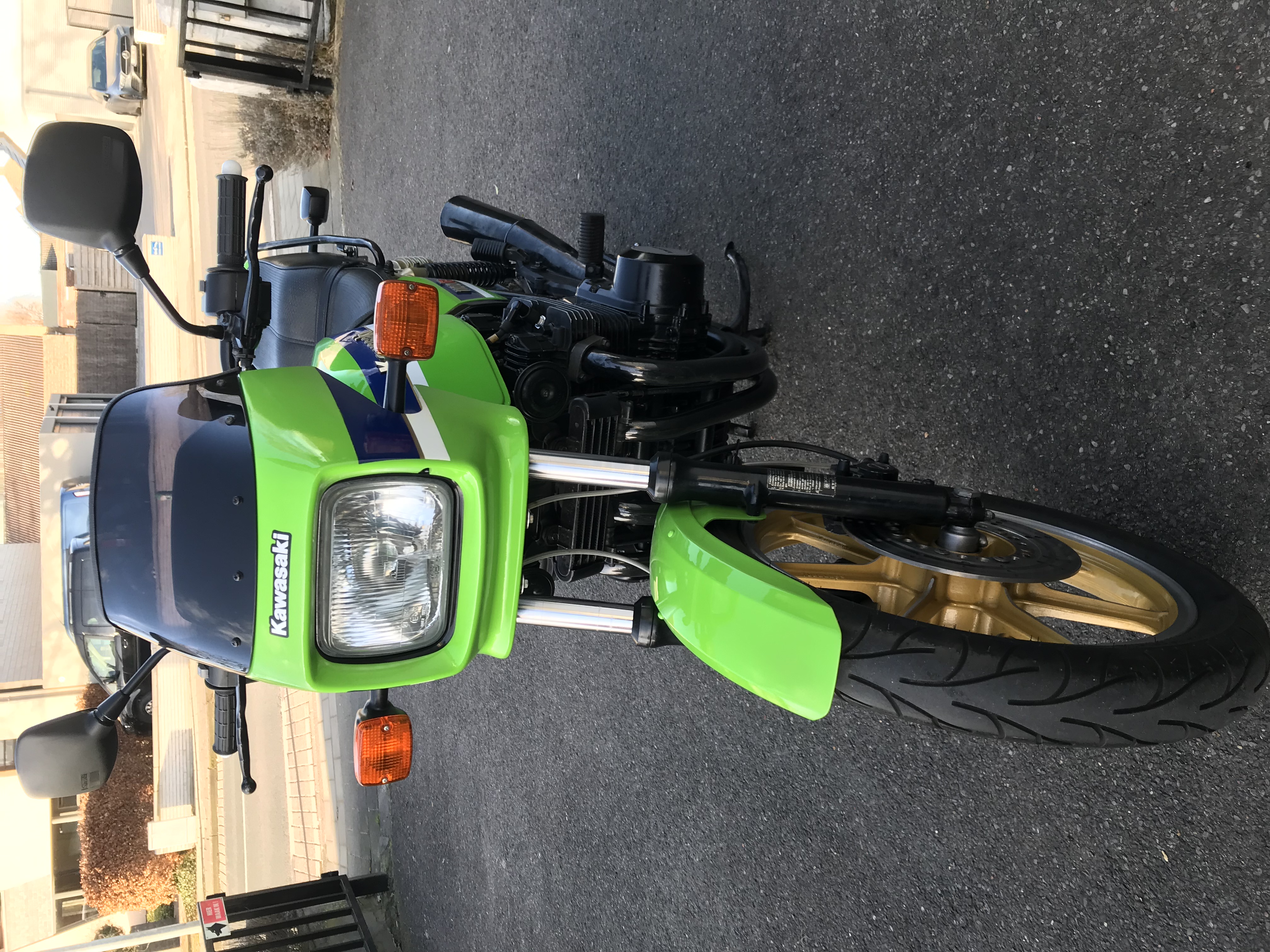

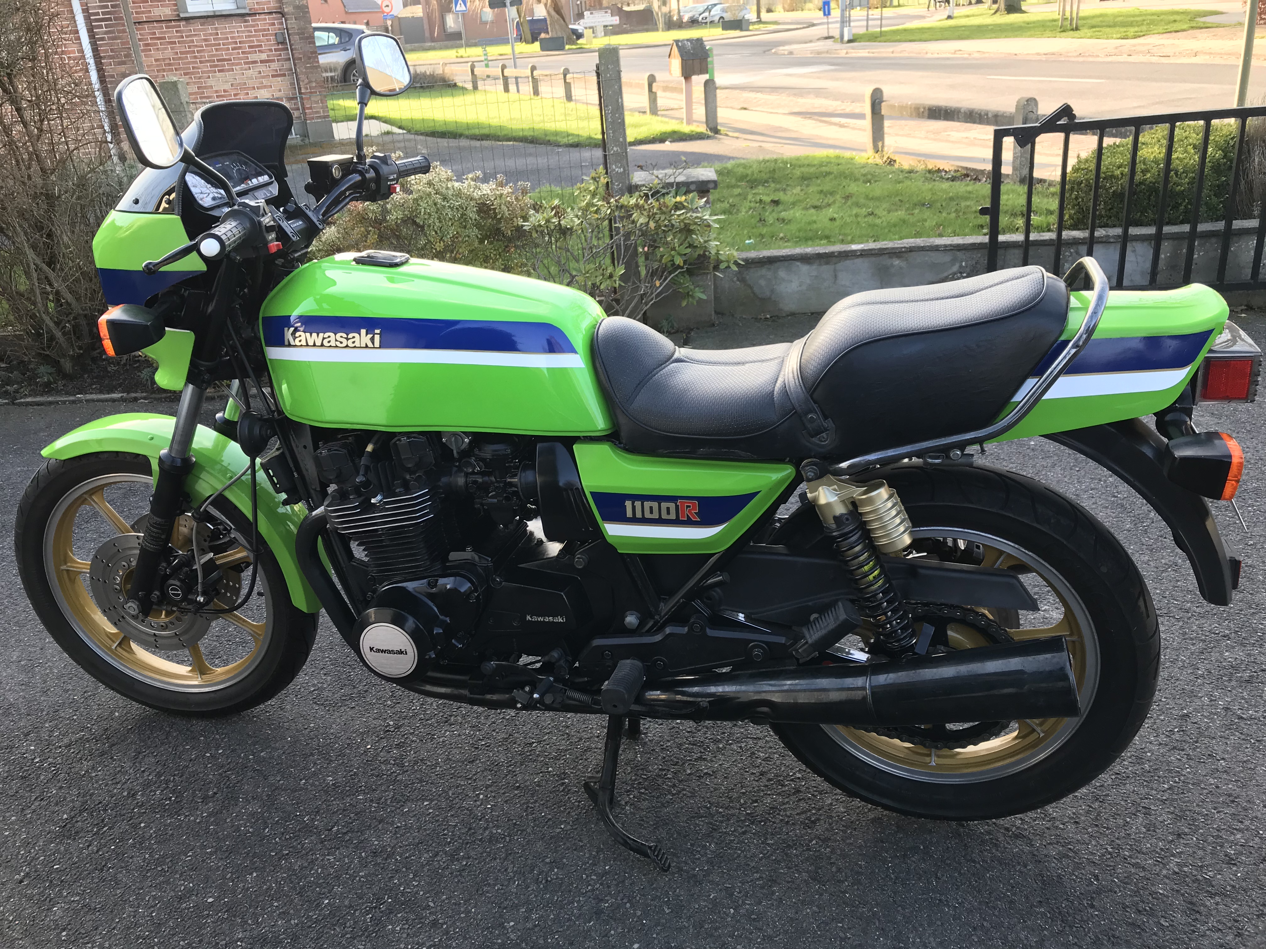

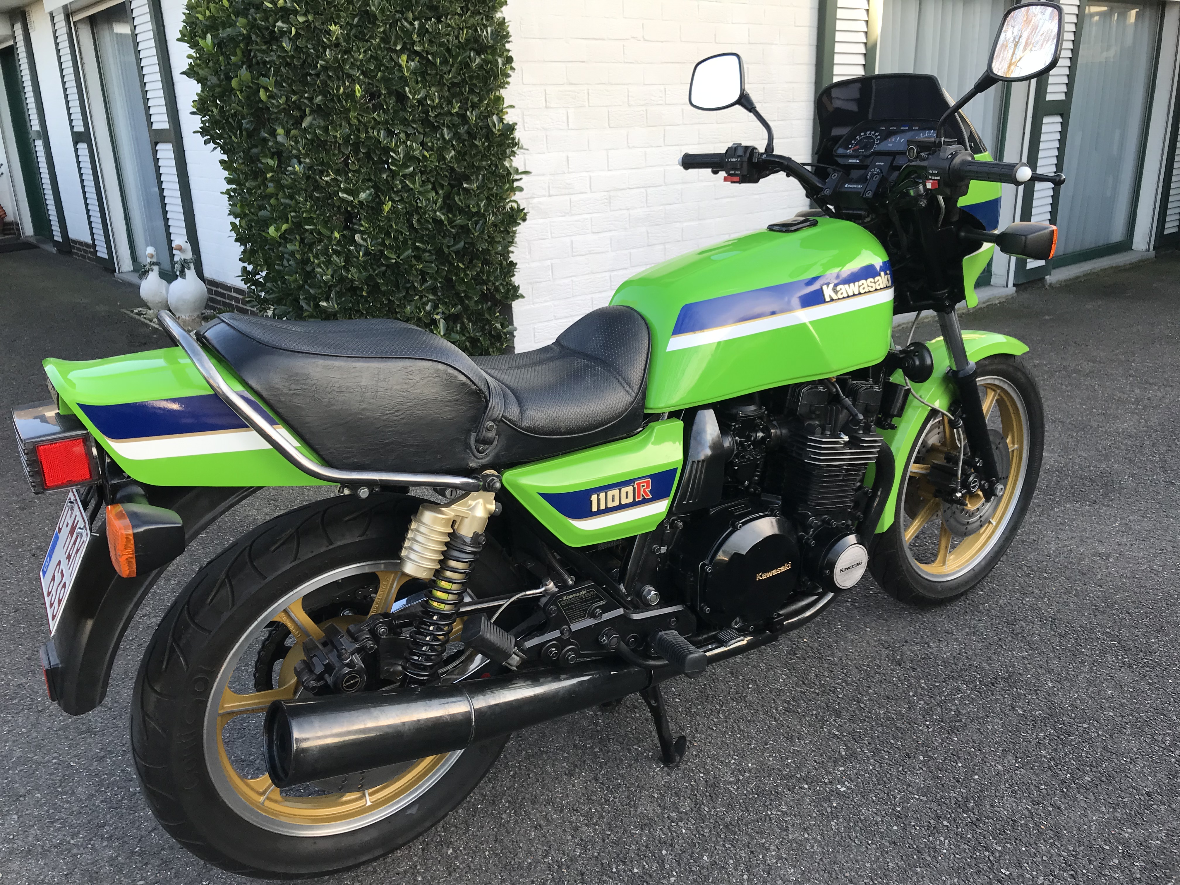

#26 PostAuthor: kawagek » Wed Feb 02, 2022 1:27 pm
here are a few pictures of the bike
Re: kawasaki Z1100R1 - 1984 troubles
#27 PostAuthor: Philippe » Wed Feb 02, 2022 1:43 pm
Hallo kawagek
prachtexemplaar, proficiat !
