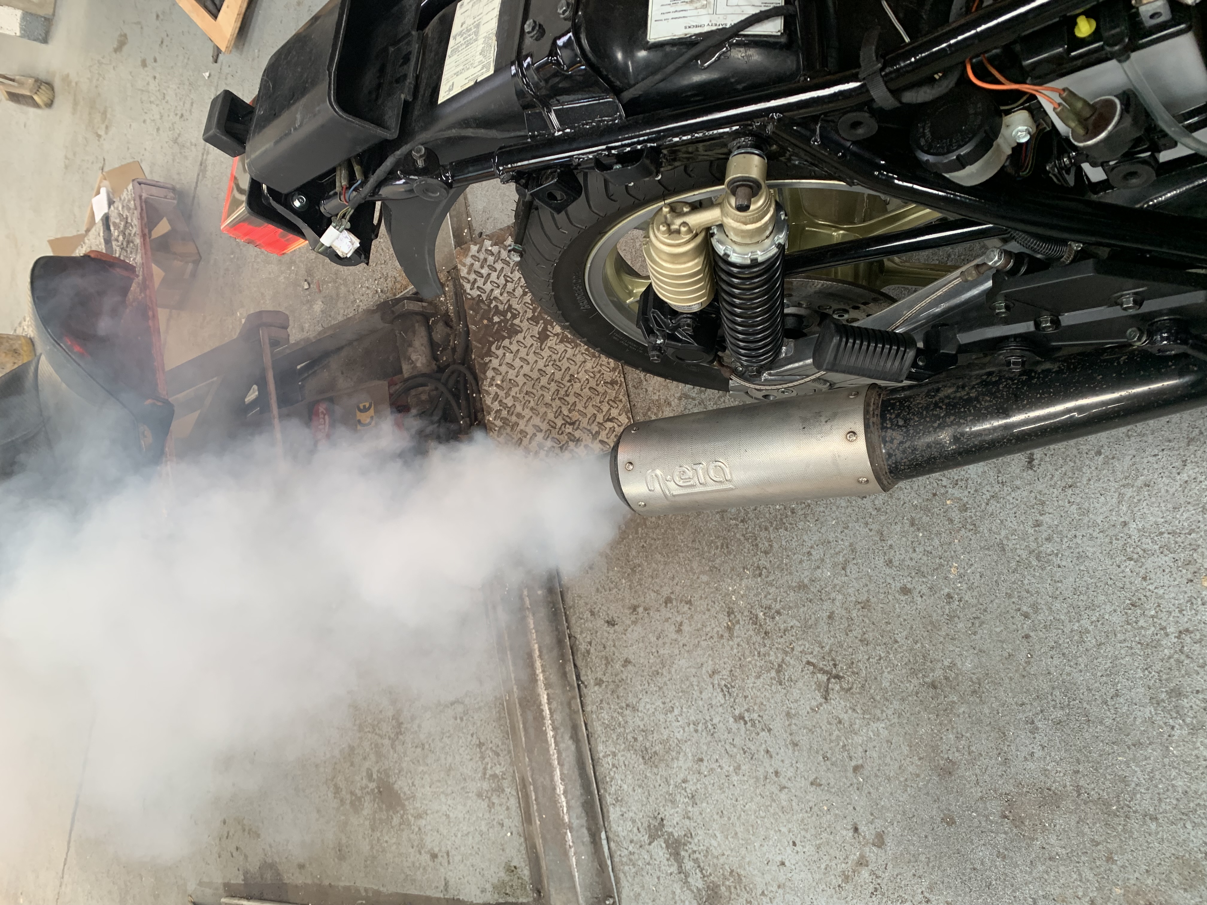

Here's a picture of the Exhaust smoke, to me it looks white. So I'm guessing its getting too much fuel :whoa

Skid Mark wrote:Here's a picture of the Exhaust smoke, to me it looks white. So I'm guessing its getting too much fuel :whoa
white is condensation, blue is oil and black is fuel.

#20 PostAuthor: rickm » Mon Mar 07, 2022 10:24 am
A long time ago I managed to seize the oil scraper rings on the middle pistons on my original Z1000J.
What came out of the exhaust was more white than typical 2-stroke blue.
In fact it looked just like Mark's photo.

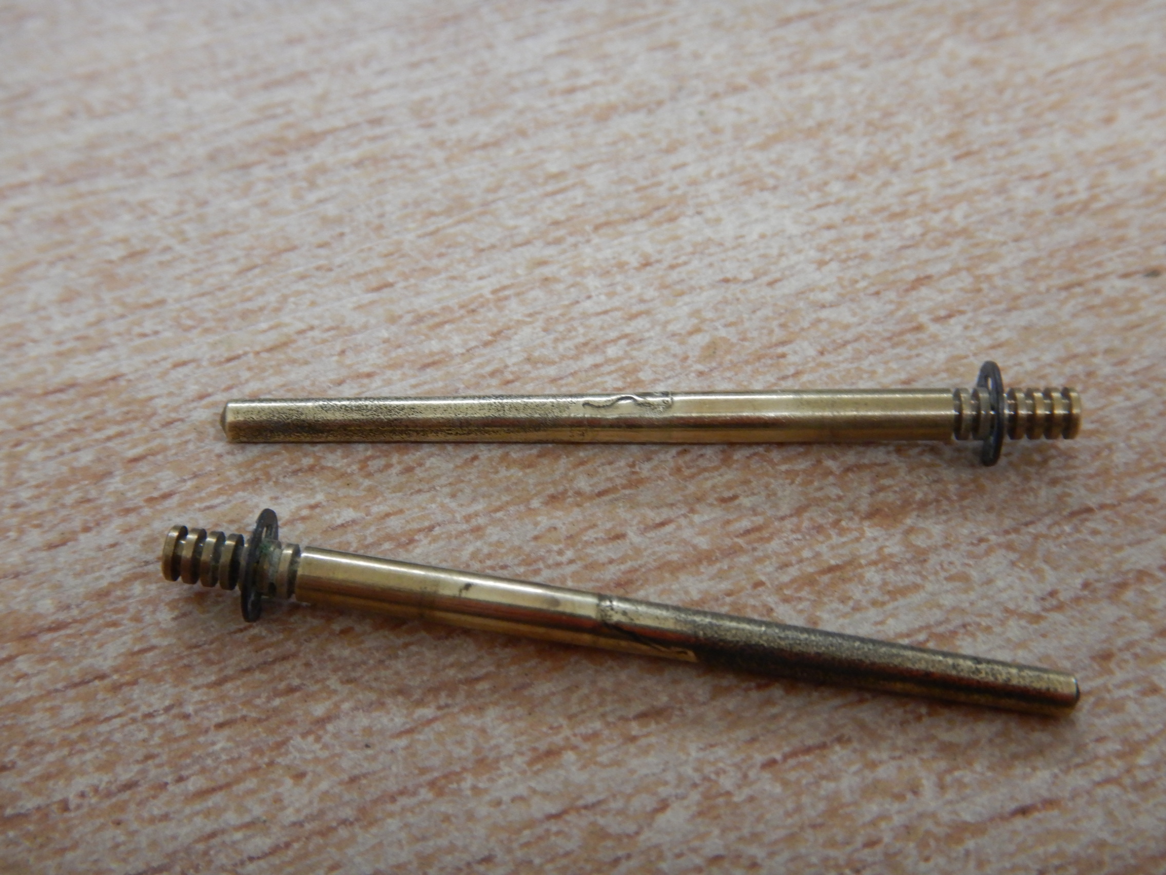

The jets appear to be correct, at least for the standard Airbox set up. The needles, in the picture below appear to be off standard with 7 grooves. There also appears to be considerable wear around where I'm guessing is the closed throttle mark. This is probably a good place to start. I'll look into a set of needles.
Oh please God let it be condensation! :eek

#22 PostAuthor: z1bman » Mon Mar 07, 2022 11:38 am
it looks like smoke to me its too dense to be condensation

#23 PostAuthor: Skid Mark » Mon Mar 07, 2022 12:18 pm
z1bman wrote:it looks like smoke to me its too dense to be condensation
It does look and smell like smoke to be fair.

#24 PostAuthor: Skid Mark » Mon Mar 07, 2022 12:23 pm
I rang around for Needle jets and Jet needles for the carbs. I have to say I understand why you all speak so highly of Phil and Dave in Z-Power, however the parts are no longer available. This is obviously why they were not changed during the refurb.
I tried Allens and Cradlie Kawasaki, no joy.I can't get through to NRP so I emailed and am waiting for a reply.
Any ideas what other options I have?
There will be a lot of water in that motad if it's not been having good runs to dry it out inside, the condensation will smell of smoke, after all it has exhaust gasses in it.

Biggest challenge at the minute seems to be getting replacement valve needles and needle valves.

kev edwards wrote:There will be a lot of water in that motad if it's not been having good runs to dry it out inside, the condensation will smell of smoke, after all it has exhaust gasses in it.
That makes sense Kev. It hasn't been run in years so perhaps there is a lot of moisture in carbon build up in the exhaust.

#29 PostAuthor: moizeau » Mon Mar 07, 2022 6:24 pm
I'm quite new to this lark but the needles wouldn't cause the original issue of a very high idle, the smoke is an unknown at the moment. I'd get the the carbs / idle problem sorted first, keeping a check on the oil level, get it up to temp and see if the 'smoke' clears.

#30 PostAuthor: warren3200gt » Mon Mar 07, 2022 6:26 pm
Whip the tail pipe off so just the headers are there. Fire it up and see if there is any difference.
