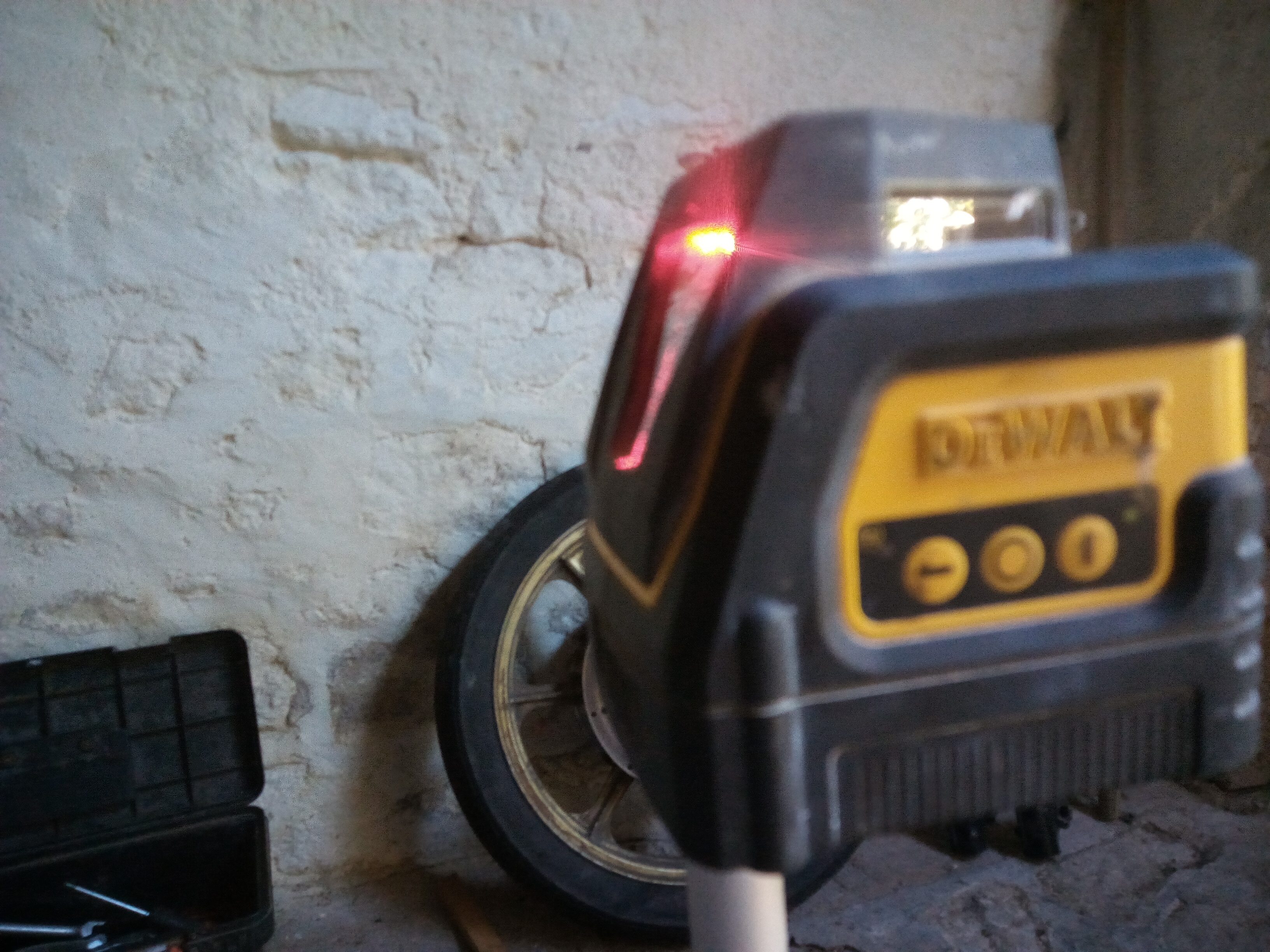

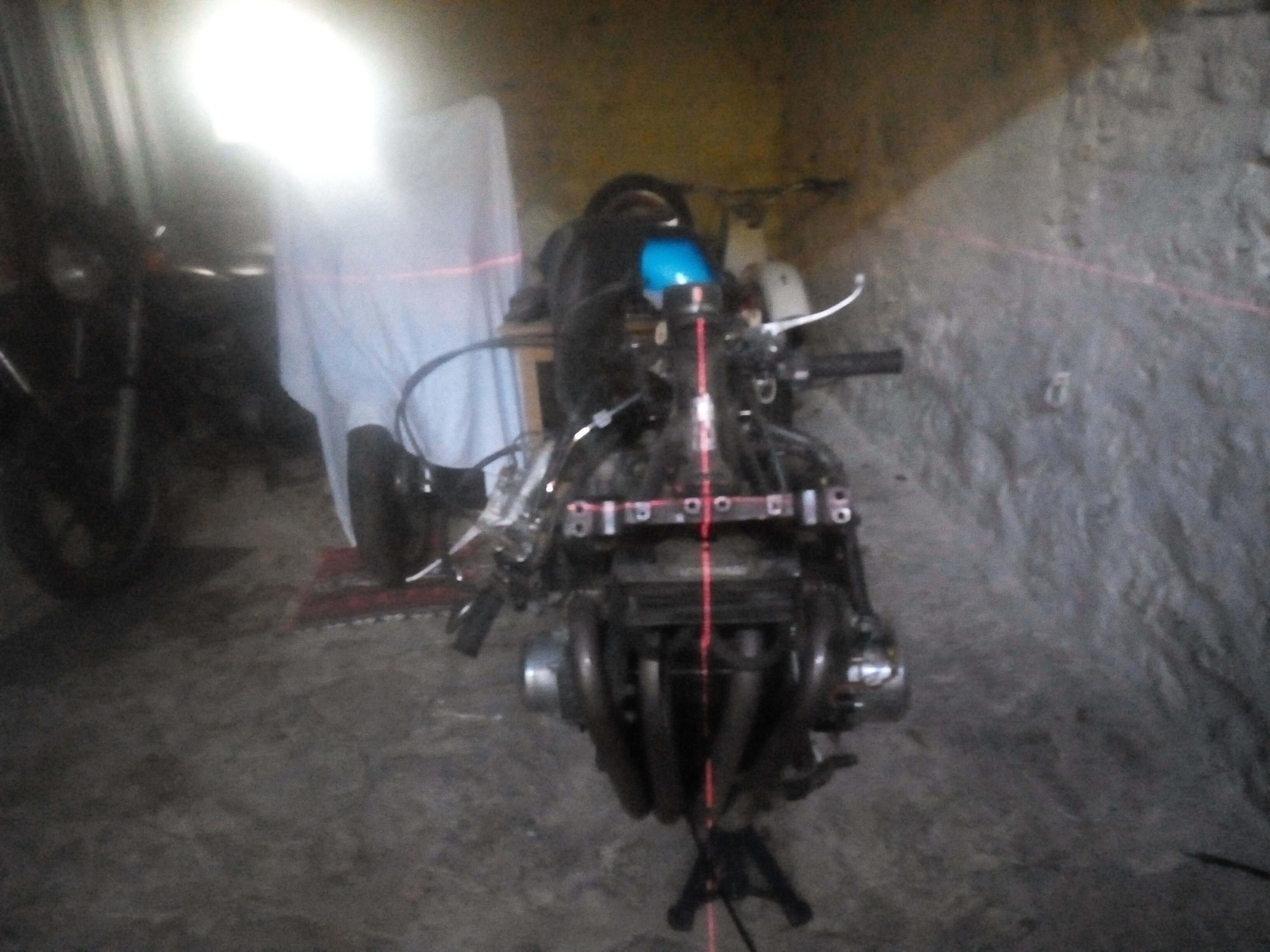

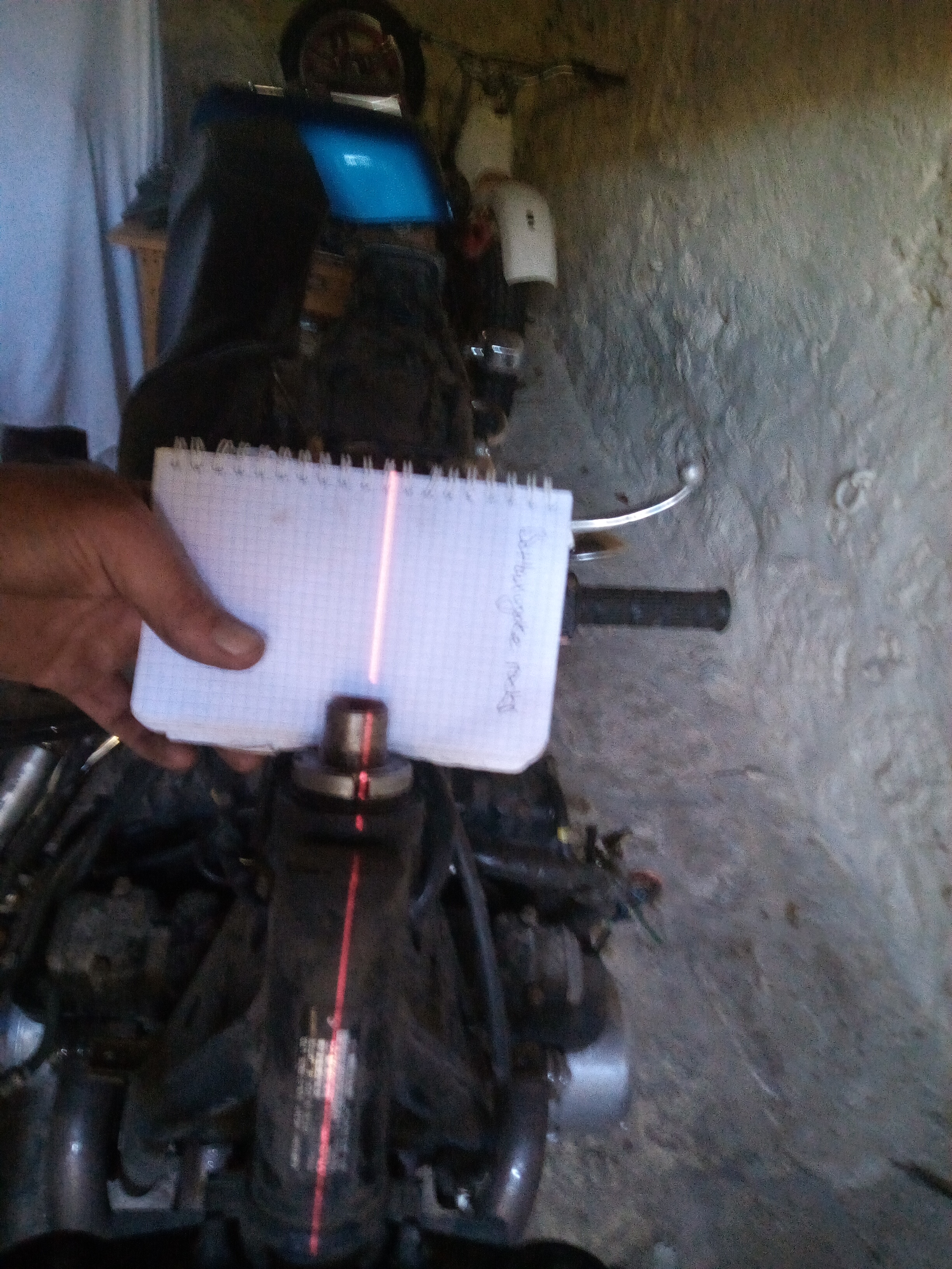

This shows a laser picking up the centre of the rear tyre, which is vertical, and the lower yoke.

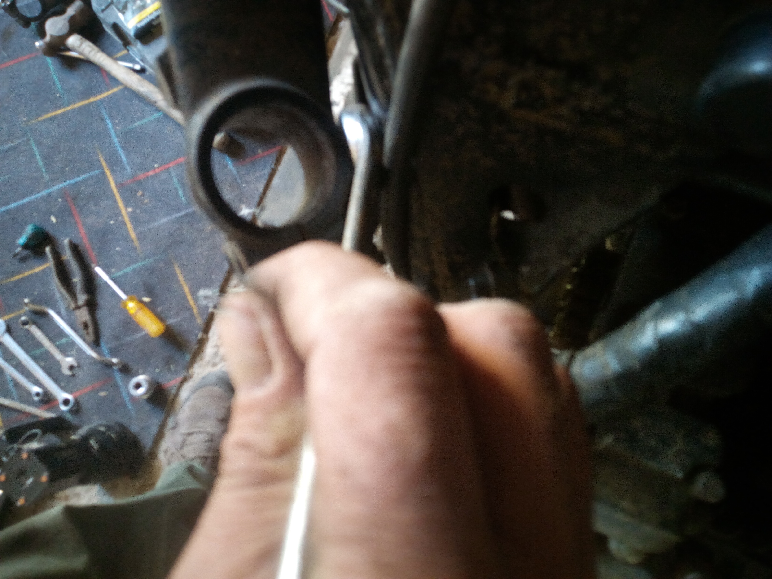

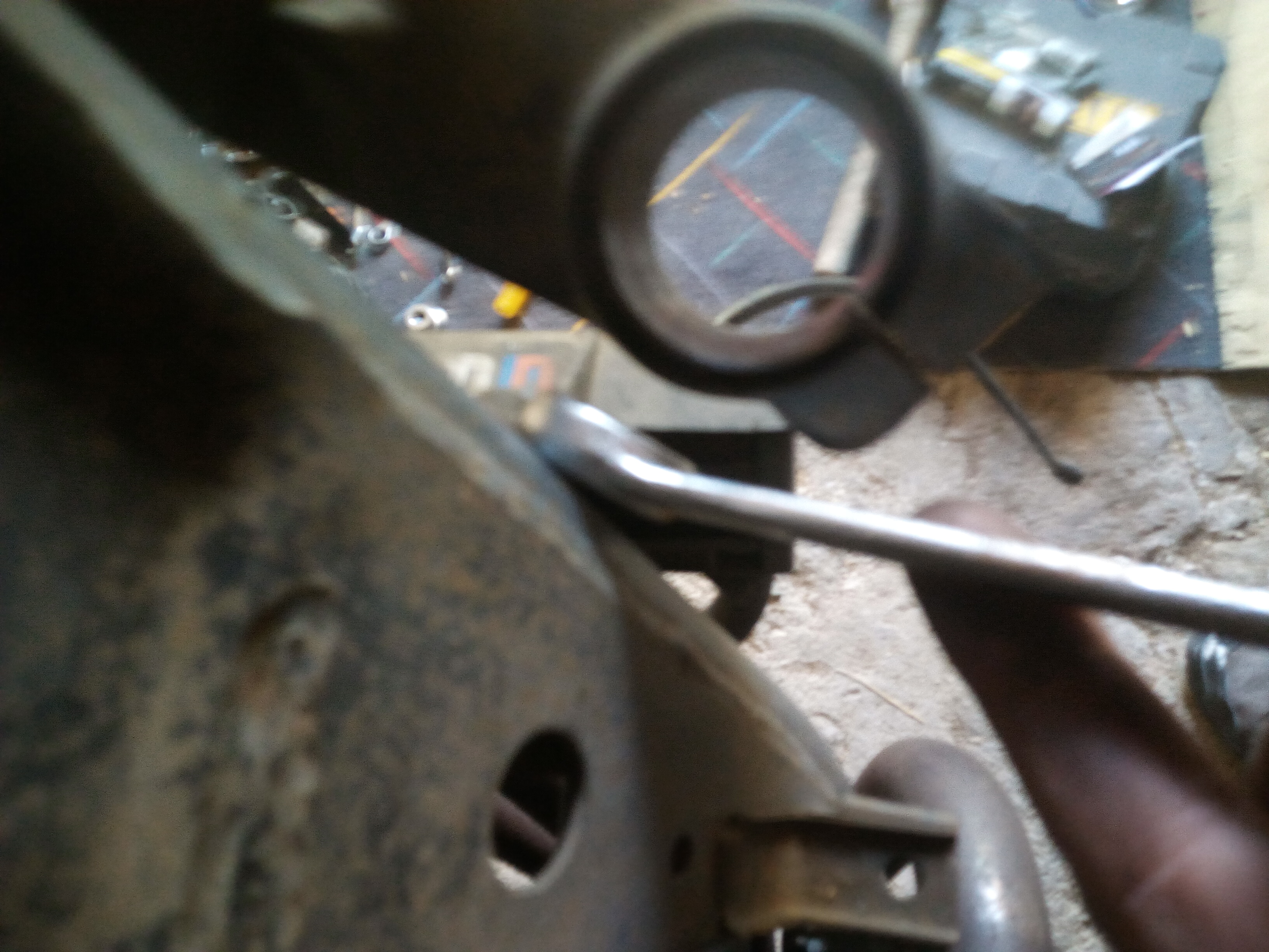

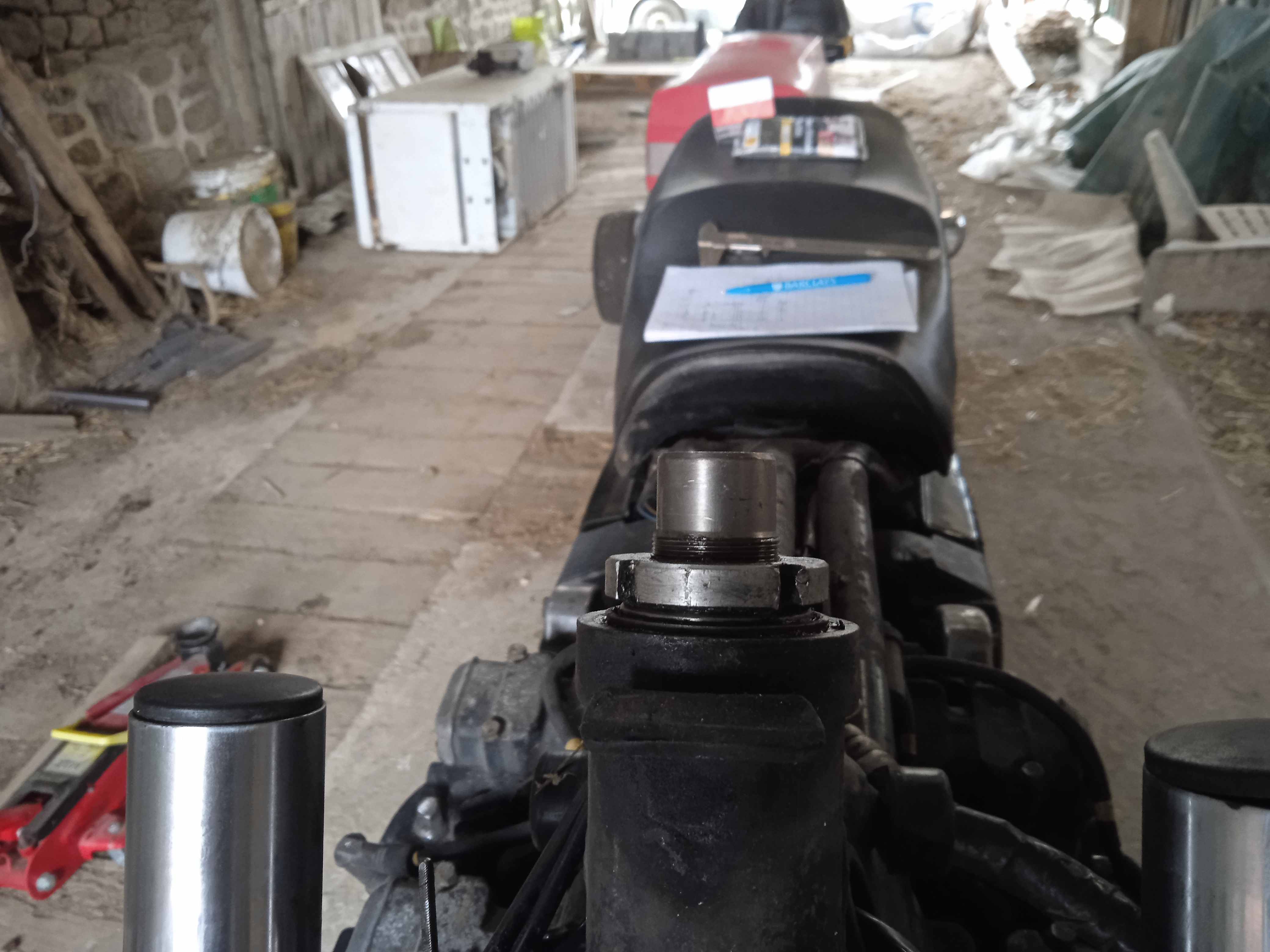

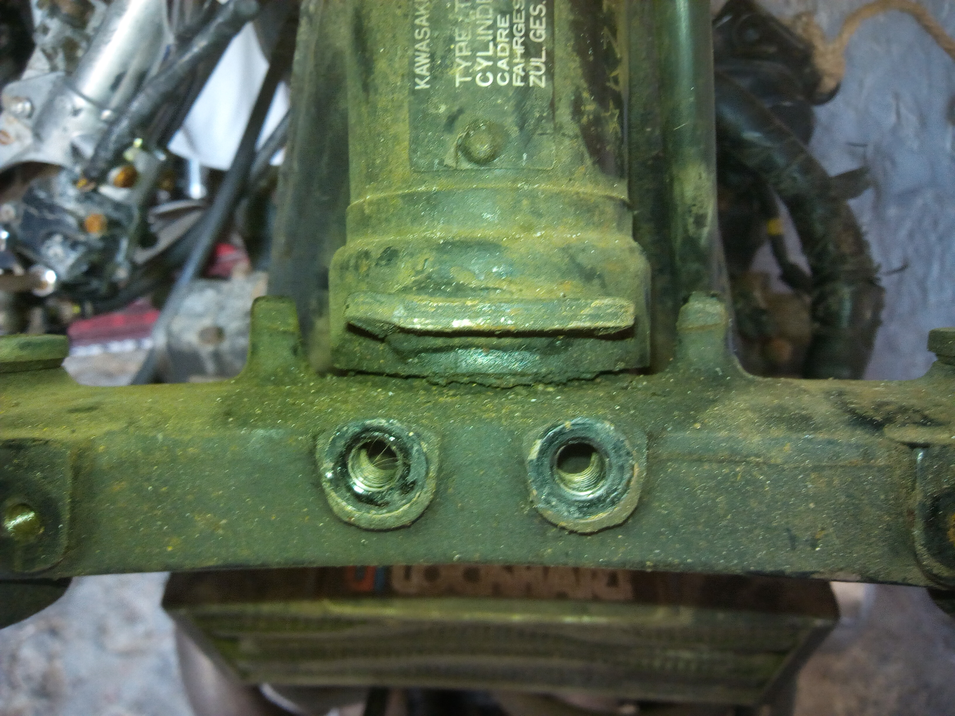

I knew the lh fork touched the oil cooler on full lock but with the forks removed it shows the difference between the lh and rh lock.
Partly caused by this
But mainly due to the headstock.

Checked everything possible, horizontal brace under the seat, the horizontal bracket that bolted to the frame rear of the fuel tank, both were the same. The 2 outside horizontalish spine tubes, same, each fork, same but the 2 forks differed by 1 deg. the rh one is more upright. After having put it back together last weekend, time to take it apart again, only moreso. Got to be yokes or headstock. So now I've stripped the front end completely including bars, clocks etc.

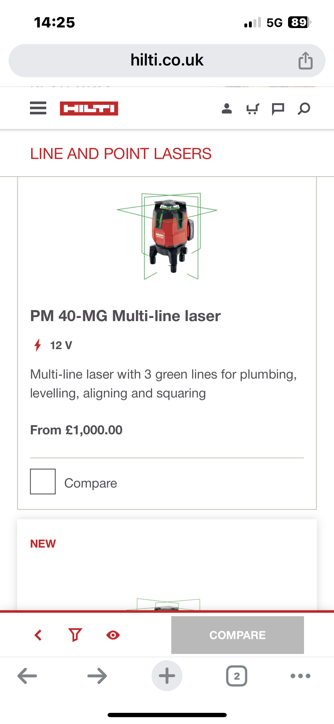

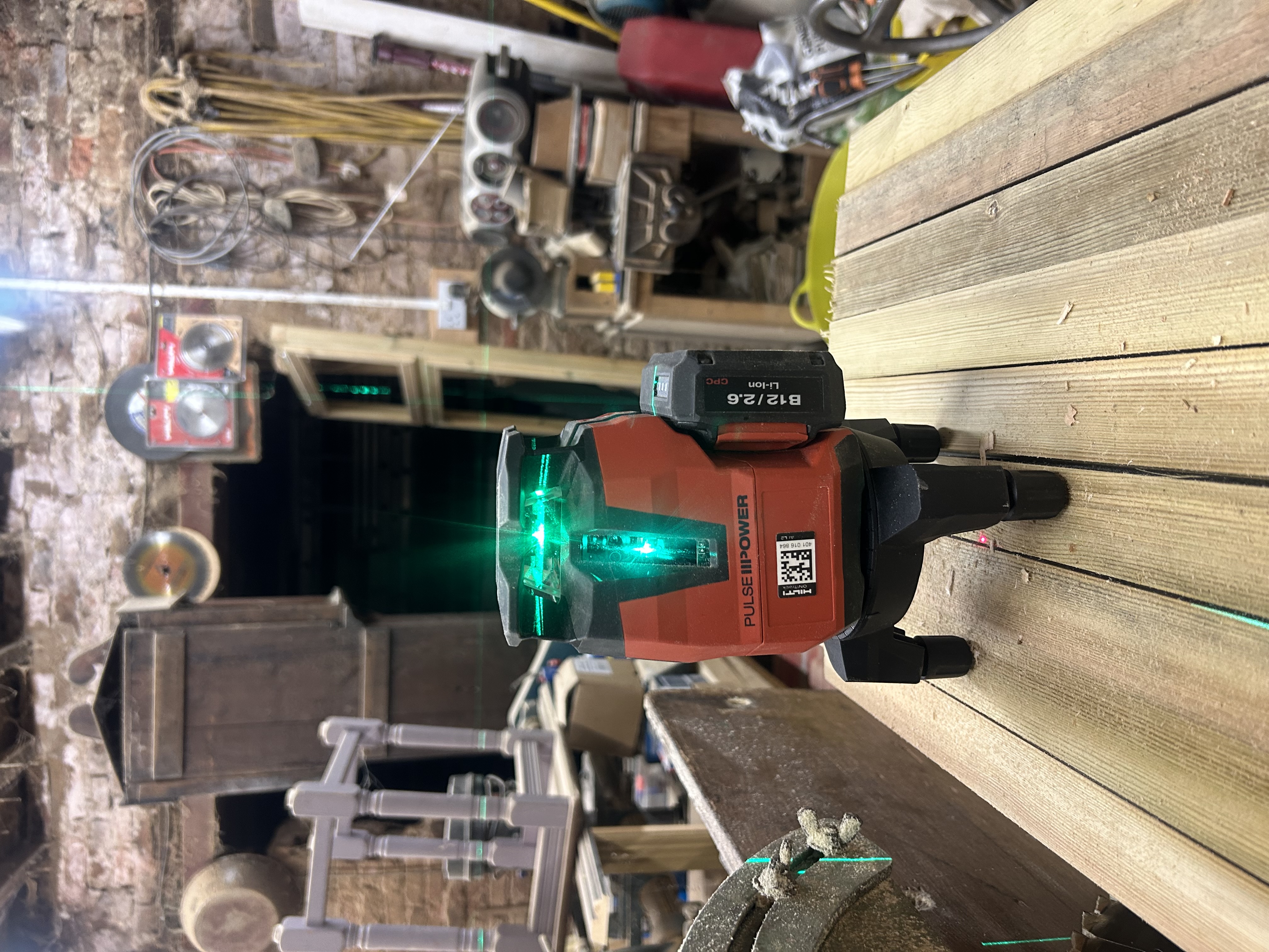

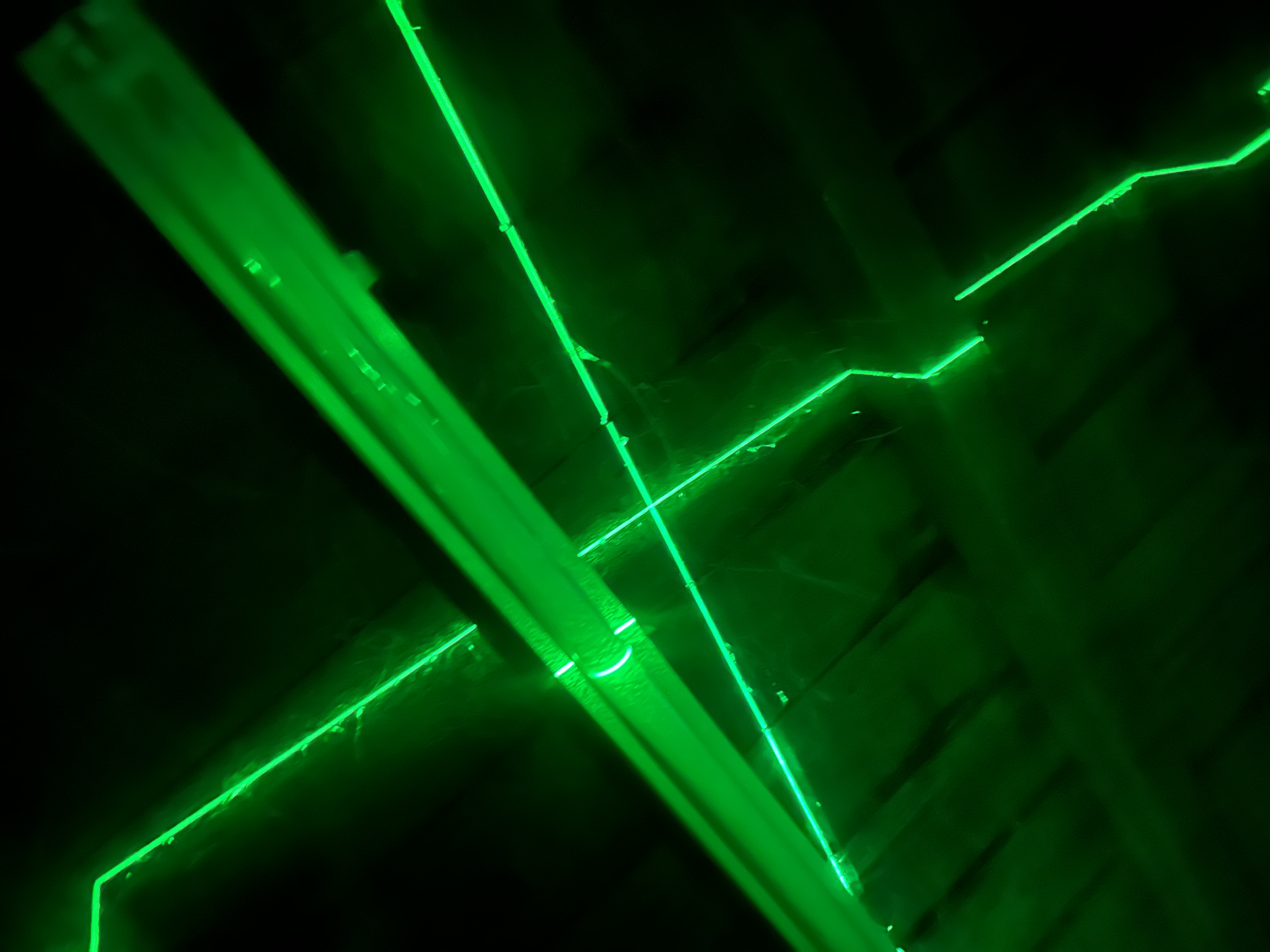

Hi can u get access to one of these it’s a high tech laser u need one around the 2k mark for the correct features it gives u datum points and is self levelling correcting it self every second if the head stock is out front to back then it would only affect the rake ! Side to side is where u are having your problem so with the triple tree in place put in new bearings and lightly tighten set laser to centre of head stock and set horizontal to bottom of yokes this will give u the degree it’s out u will spot it straight away if it’s not head stock then triple tree is bent

Compo, I can get my hands on something like that from a friend who does drainage etc. but not today so I've used mine again which does self level and has a cross but doesn't tell you angles.

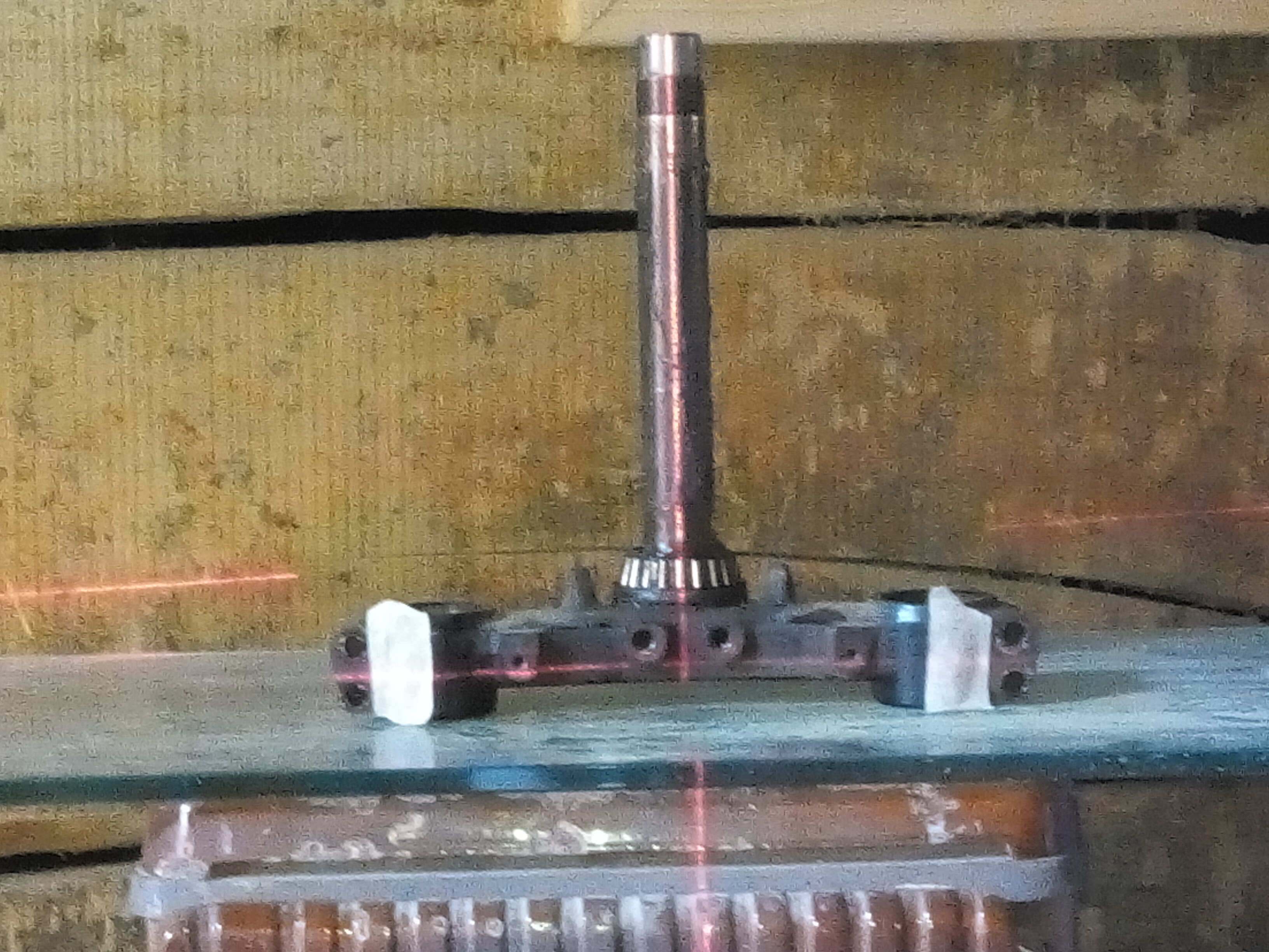

The first thing I did was set a piece of 9mm glass level and set the bottom yoke on it.
It's not too clear on the photo but there is a decrepancy between the lh and rh fork tube clamps even though the centre tube was vertical. It also rocks. Here's a video. The laser can be seen better also.

Al, I could get a measurement underneath the swingarm pivot and it was 0 but with the bracing and welds around the headstock I was't confident with the reliability. I did get 88 both sides which makes sense but I could alter the reading by tilting the phone so not conclusive.

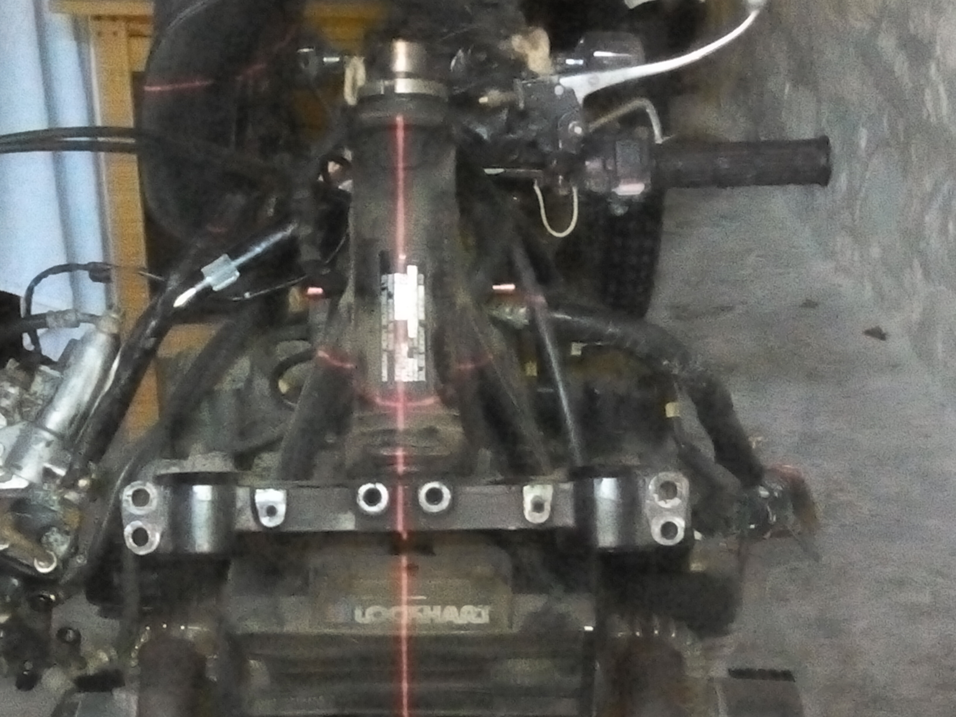

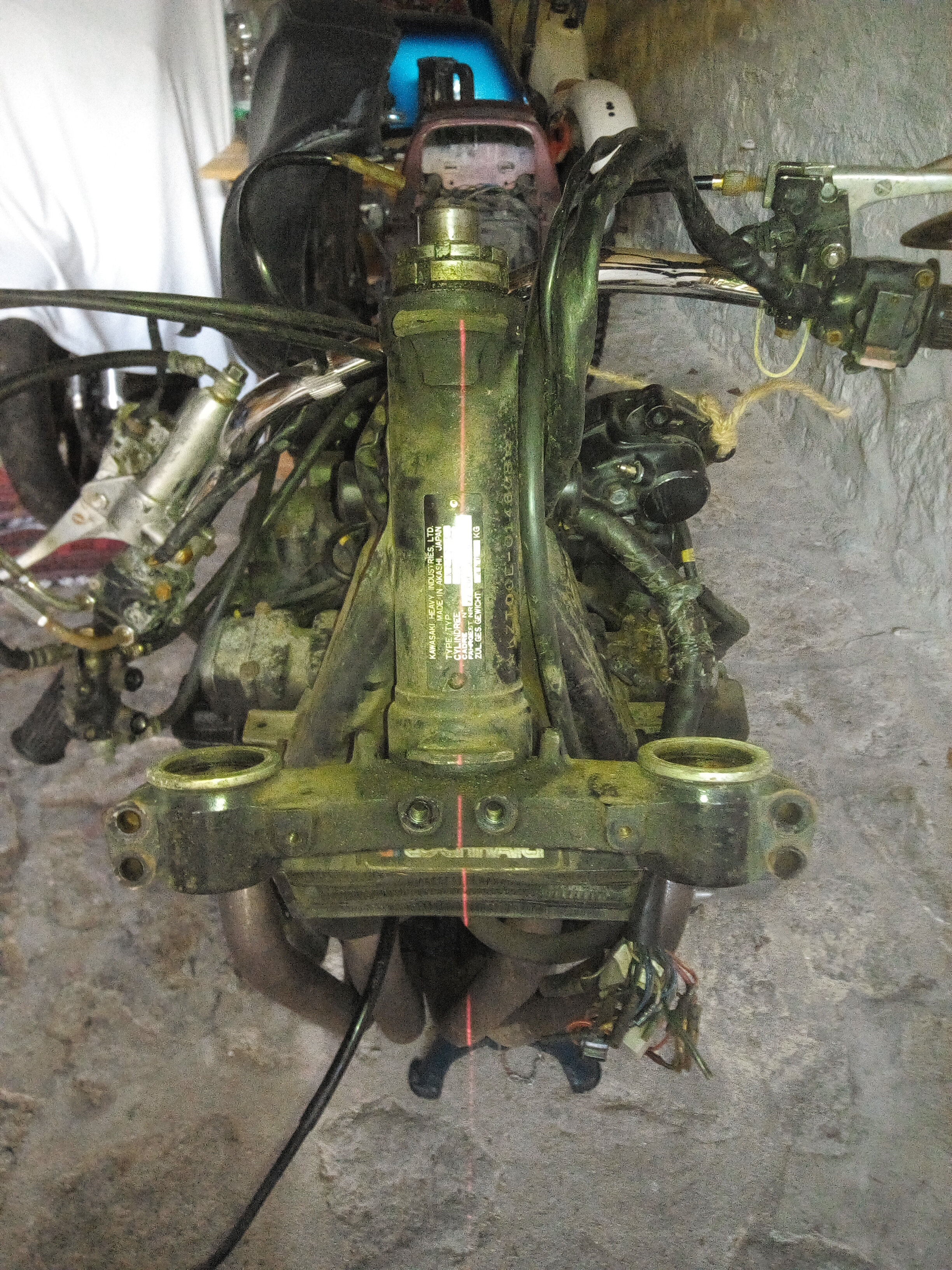

Next, refitted the lower yoke, set the laser to yoke centre underneath and also to the centre of the frame at the rear, then set the horizontal.
As can be seen the rhs is higher than the lhs and the headstock is tilted towards the left at the top (As it's looked at in the photo). I wanted to check other areas of the bike so set the laser up with the horizontal line set on the fuel tank mounts and the vertical on the top of the headstock.
With the lower yoke centralised I also measured the distance from the tail fin mounts to the slit on the fork clamp. There were within 2mm of each other. 119.0 cm and 119.2cm.

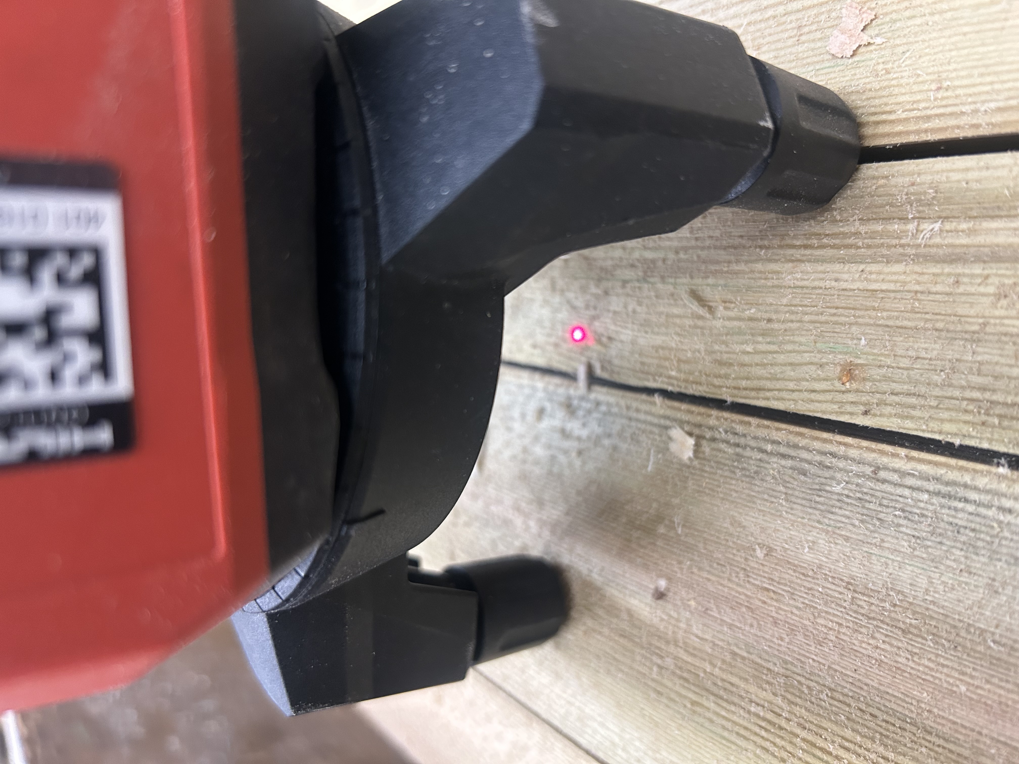

Z1Streetfighter, if you get a chance could you do this measurement please? Rear of the tail piece mounts on the side tubes to the top of the slit. Cheers
Another photo showing the top of the lower yoke tube's offset due the headstock. Again datumed to the underside of the lower yoke.

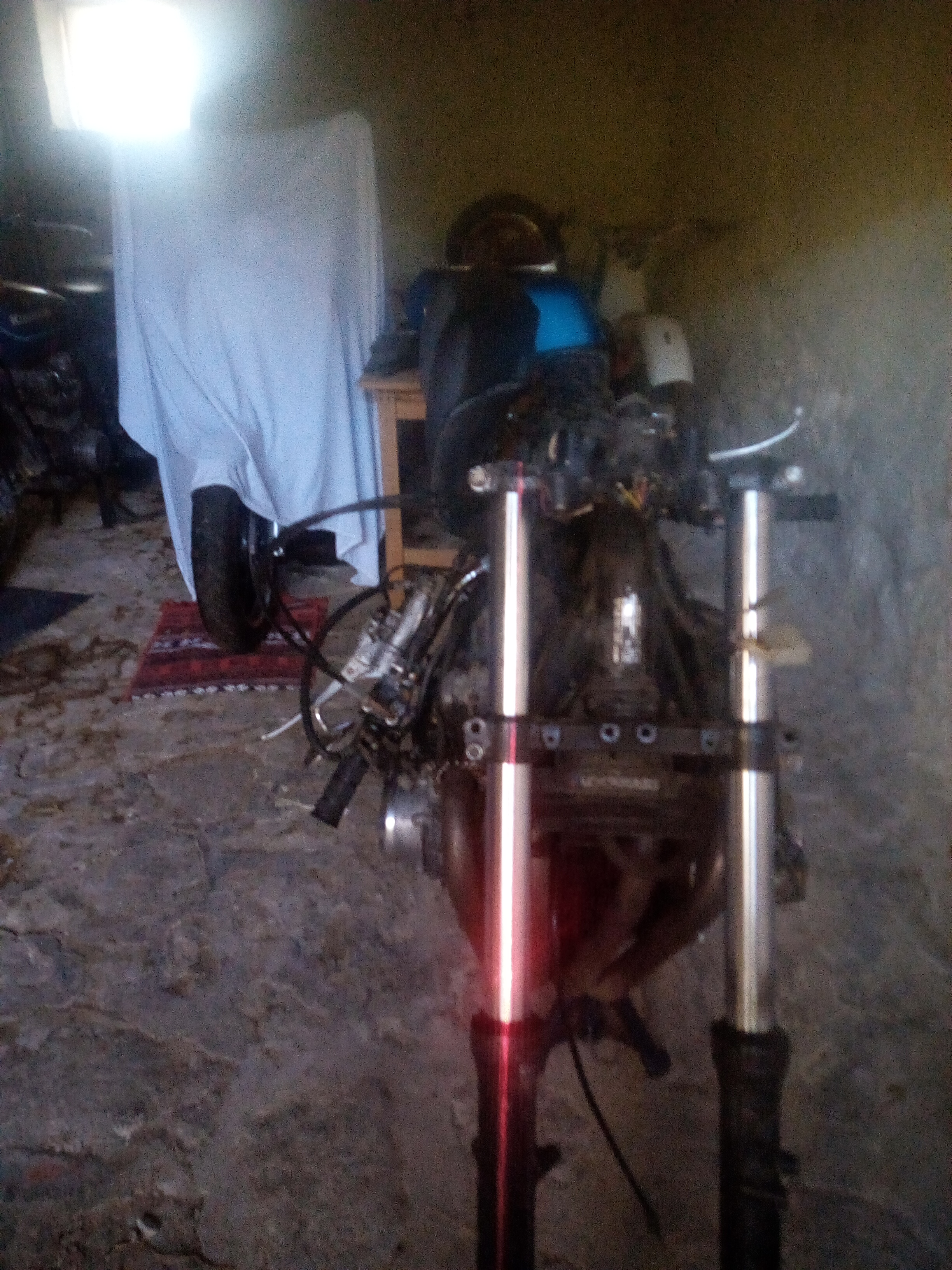

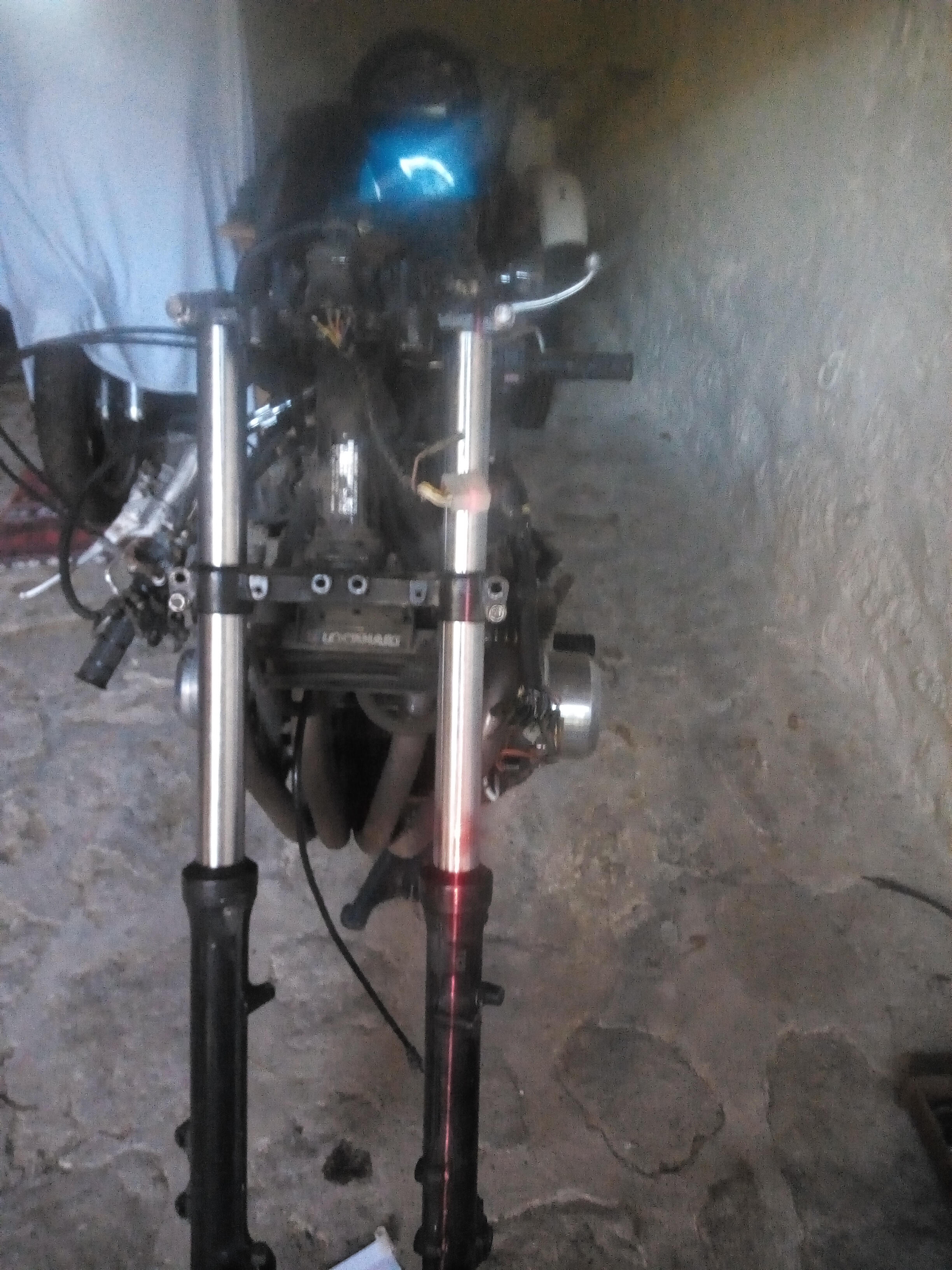

Dropped the top yoke back on and the forks in, set the bottom yoke central then lasered each fork using the top of the stanchion as a ctr point.
So unless someone can see a flaw in my methods I think the headstock is definitely kicked over and the lower yoke is potentially bent as well, therefore the top yoke also. Now just got to work out what to do next if I can't find a frame straightener. I have access to trolley jacks, chains, barn walls that are 50cm thick and tractors, steel bars.......just can't see it is possible without damaging some other part of the bike.

That looks like your correct Pete if u had the other laser it would show with mine I have software to 2D shadow block it like this ?
You could then set it up the front of the forks and it would show it out of true ! Looks like u need frame on jig and new lower yoke

Not sure where I am going with this atm. The headstock is definitely out of line as can be seen in the above photos, backed up by abnormal wear on the front tyre and the fact that I am permenantly turning right to go in a straight line. There are no frame straighteners near. Closest one is 3 1/2 hours away which means a day to drop it off and another to pick it up. I'm tempted to try and straighten it myself with the help of tractors and blocks of wood holding the frame in place then a metal bar down the headstock followed by an impact with a very big hammer. Can't be any worse than it is. I realise this isn't anywhere close to putting it in a jig and using proper rams etc. but an impact caused the twist so a reverse impact may straighten it a bit.

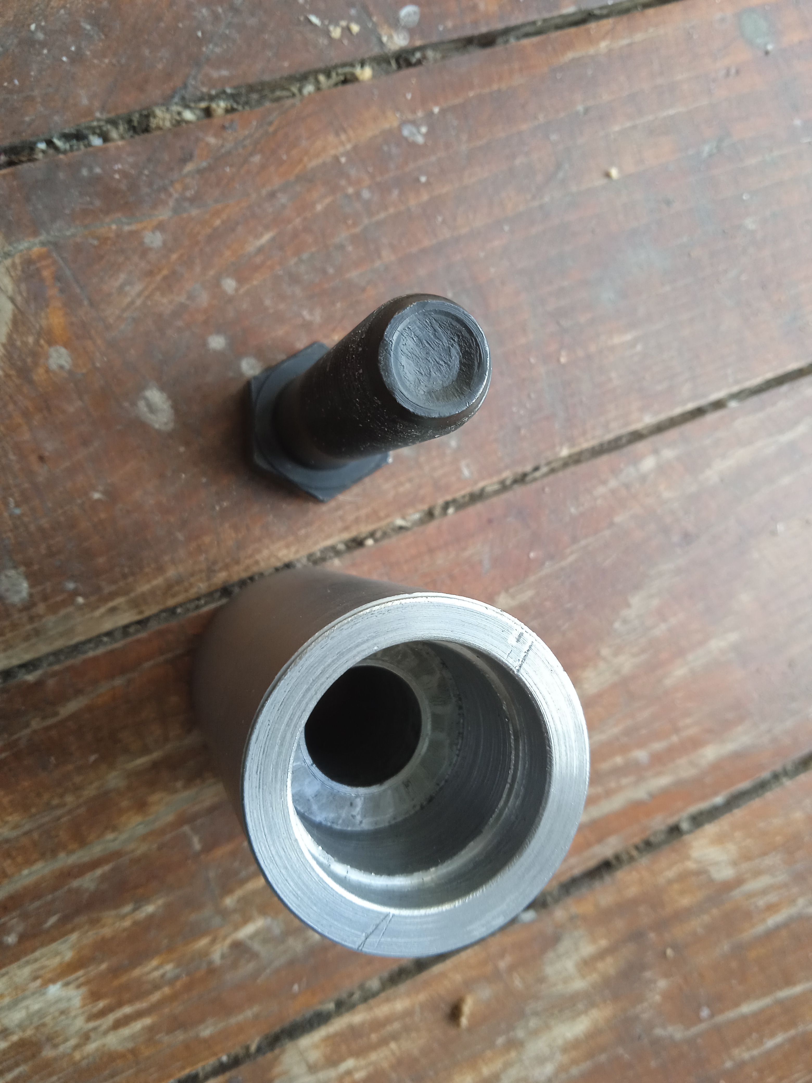

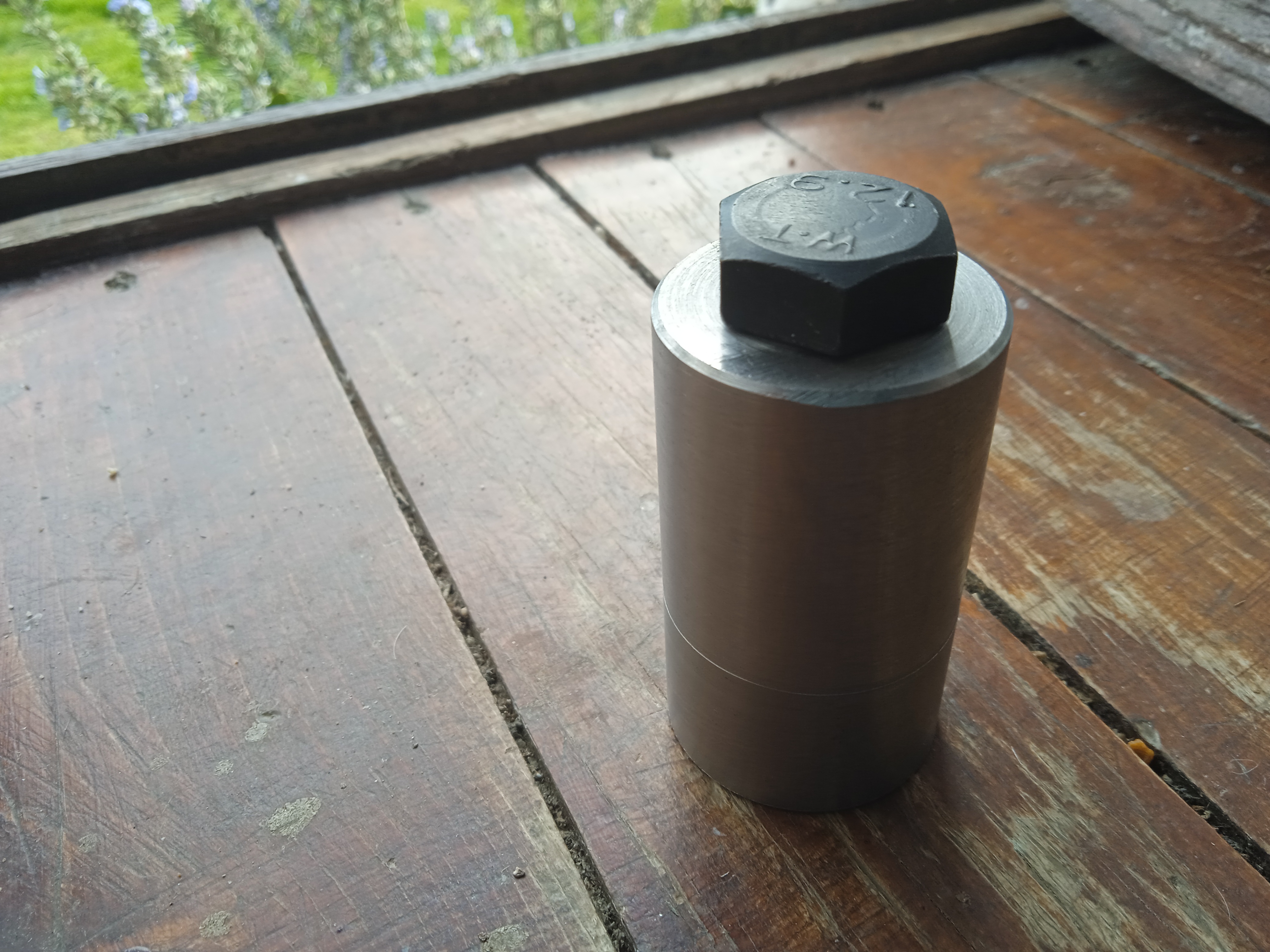

Bike has had the top yoke removed, forks dropped so both wheels are on the ground.
Mate knocked this up on his lathe
It's going to be bolted on here
Then it'll be strapped the the walls, I'll be lifted on a pallet with a big sledge hammer......
More to come at the weekend when mates and a tractor is available
