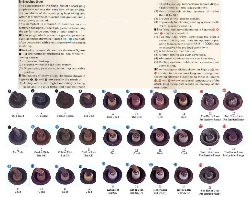

Anyway enough rambling, Bike is running good,plugs are like #17 , 20 & #22 on the plug check chart.
I have not done a compression check yet,but will do this week & then to fine tune the carbs.
