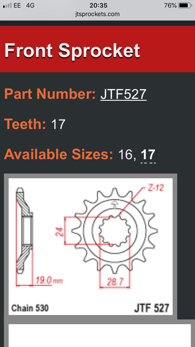

#32 PostAuthor: KWACKERZ1 » Wed Jan 23, 2019 8:40 pm
Scott have pm ‘d you.
This could be an option if you dont need the bearing support

#35 PostAuthor: KWACKERZ1 » Thu Jan 24, 2019 9:41 am
Looks like it disappeared, dont worry it was me prattling on about the sprockets below before I found the info but if you need a bearing support one its irrelevant.
Suppose if you are running a 6" rear you might need one.

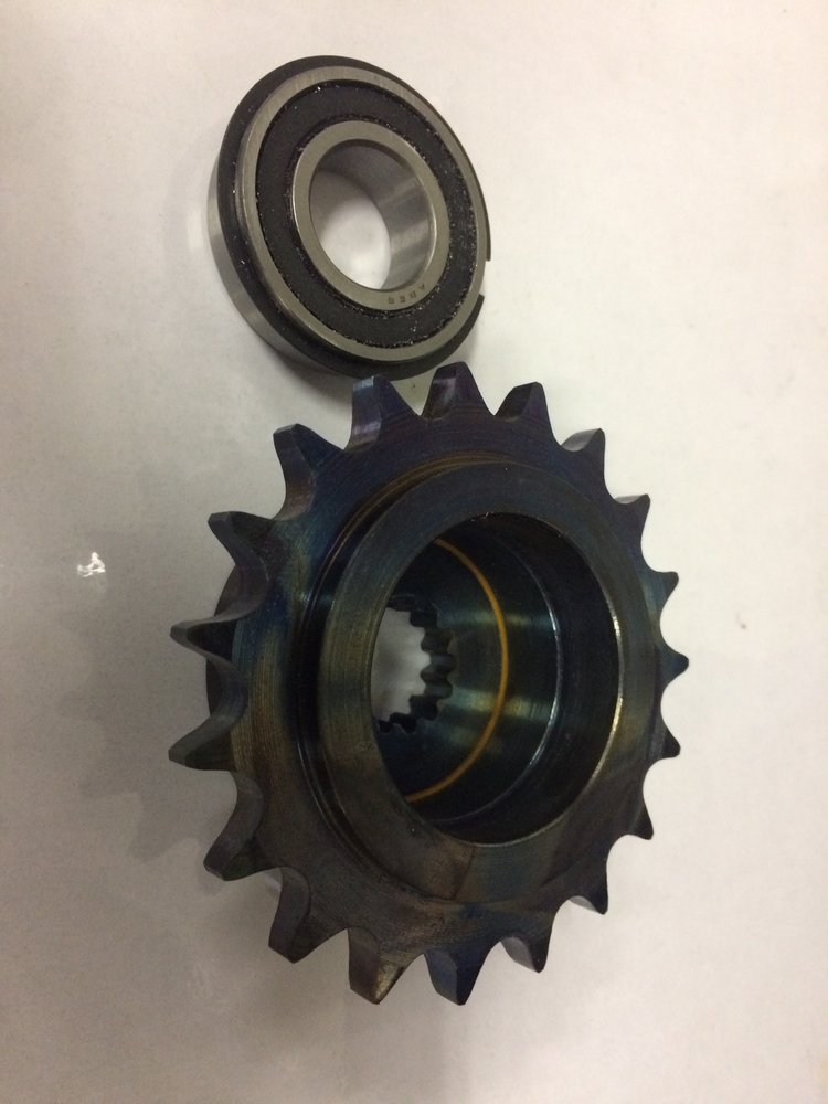

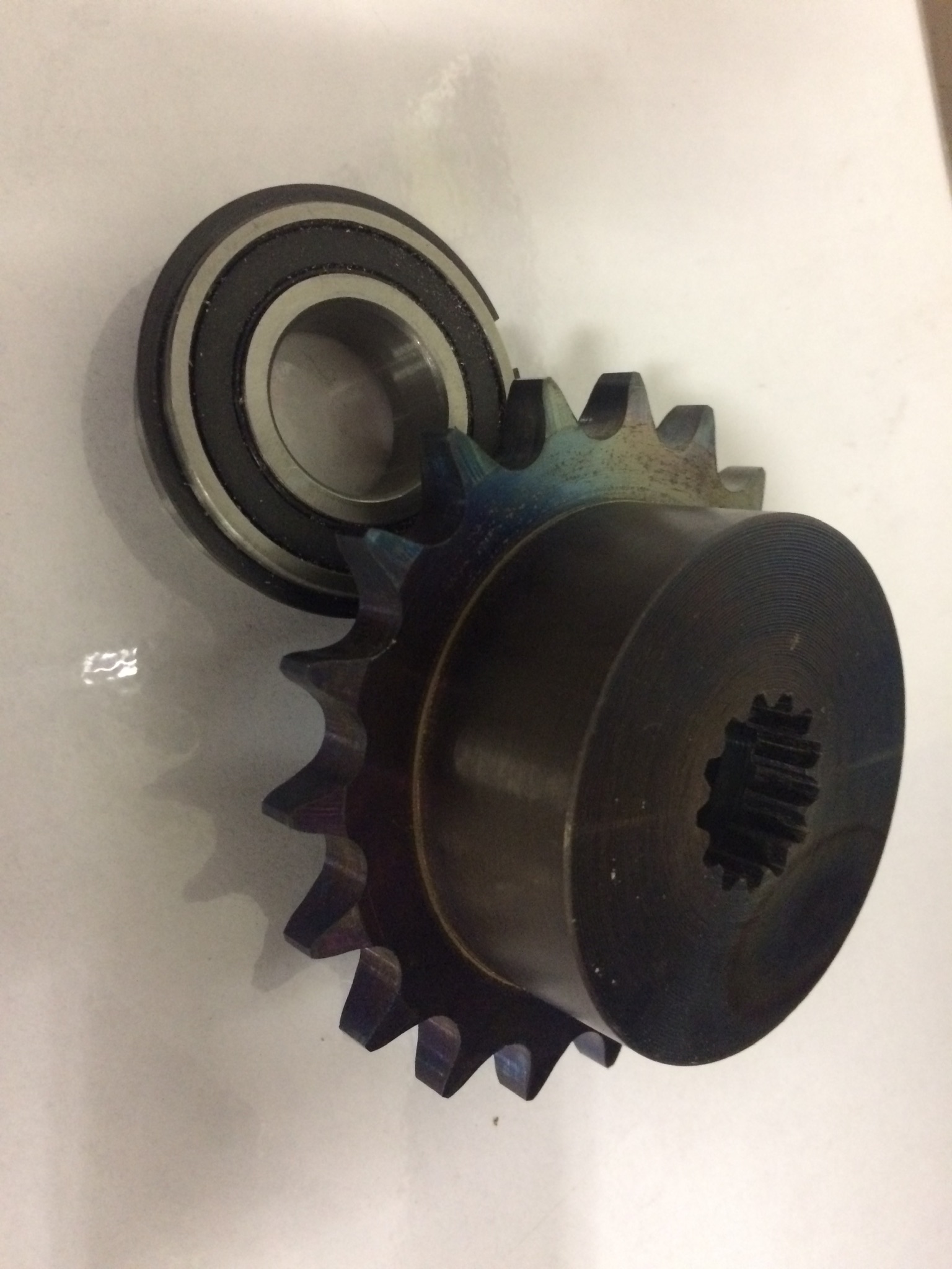

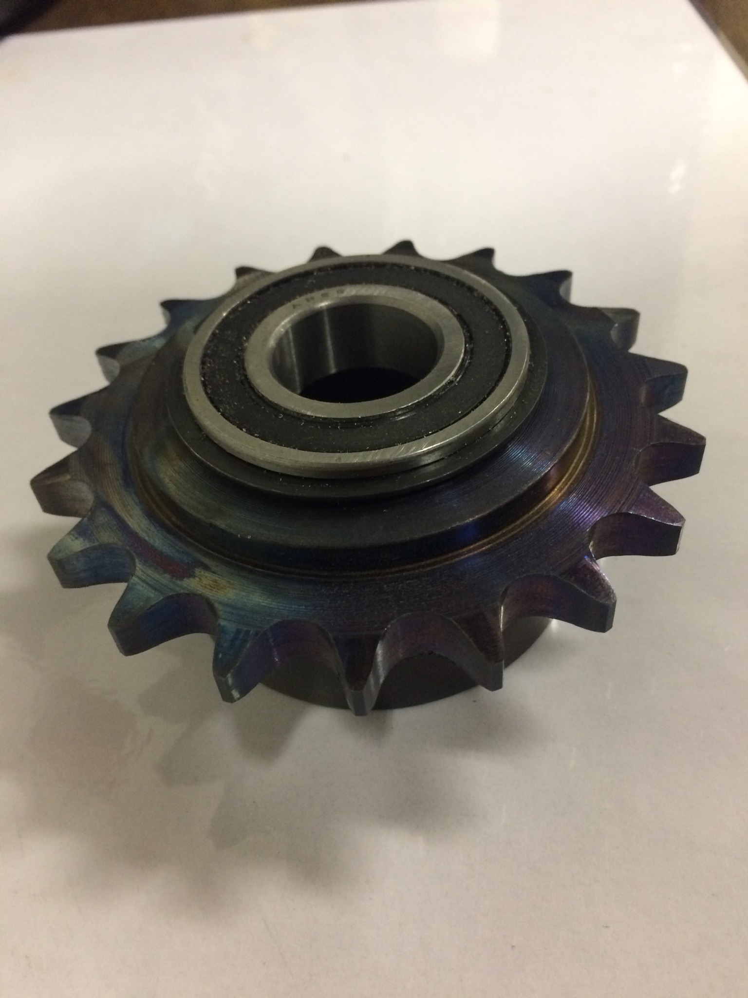

#36 PostAuthor: Mathh » Wed Jan 30, 2019 8:57 pm
Received mine from VVM racing yesterday. He can supply the bearings as well if you want..
Looks great!
