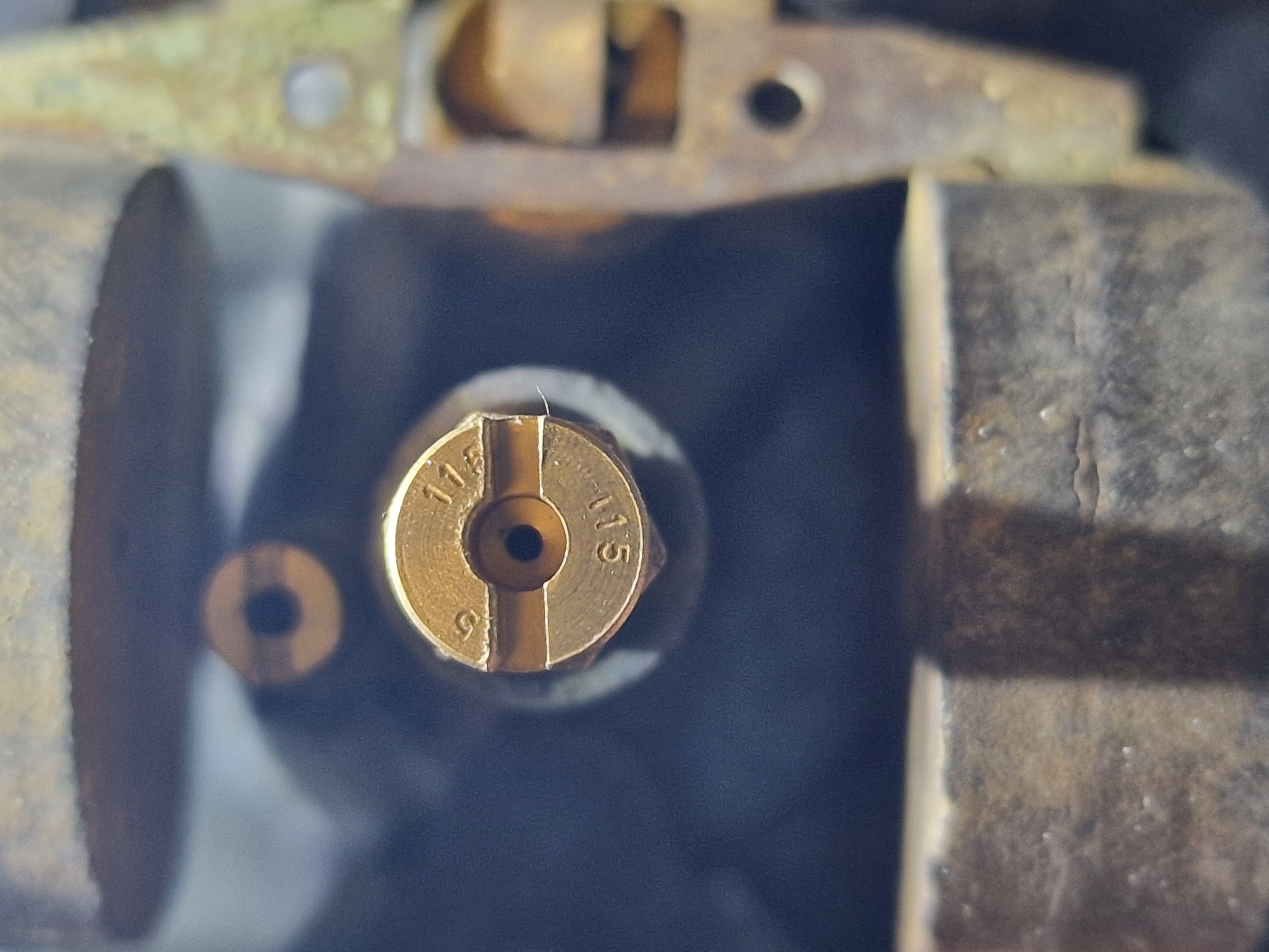

When checking the jet sizes look to see how the size is stamped, if they look like second rate stamping, at an angle or generally just naff chances are they are after market dross.
Genuine mikuni jets have size and their logo stamped appropriately neatly.
If they are after market bin em for sure.
If your unsure if they are or not post a close up of the jet showing the size stamping and we can advise.

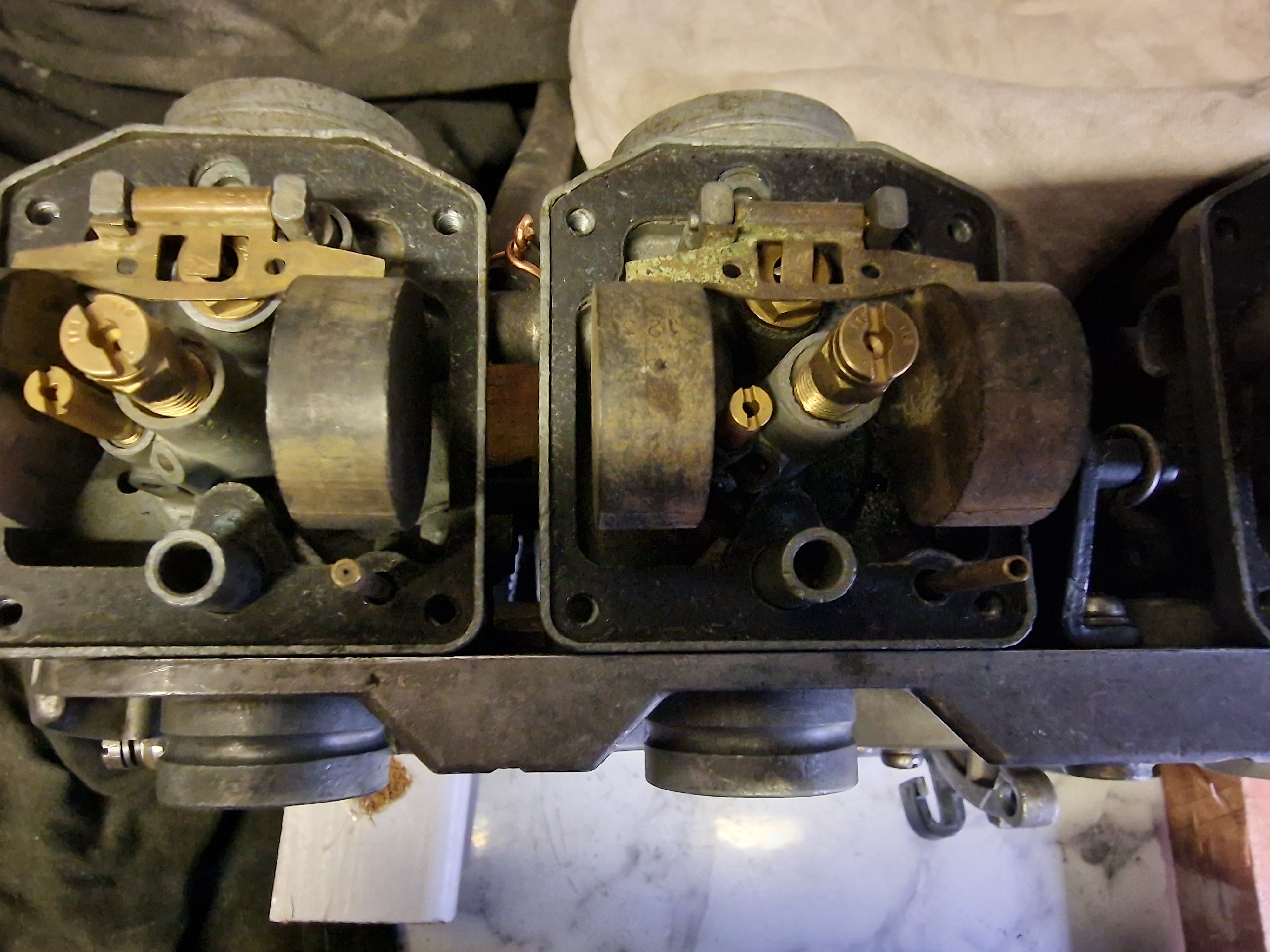

Hi Guys, Firstly measured voltage at battery not running 12.6v, then removed tank and measured voltage at coils 10.8v so a drop of 1.8v which isn't ideal may well fit relay mod to sort this.
Next removed carbs not an easy job sure you all know this but had to be done.
Drained carbs float chambers 1 at a time they were all different but plenty fuel in them all. These need the gauge to get them all the same as at moment each has a different amount, also tabs quite bent on the 3 i havn't double washered them. However all 4 floats operate unhindered and dont seem to catch on anything, if you invert then back you can hear the float free moving. But obv they need to be all the same volume. So gauge needed to do properly.
Next checked main jets, the 2 outer carbs have 118 stamped on them, whilst the 2 inners have 115 stamped, is this correct, thought they should all be the same.
Next checked smaller jets next to mains all 4 are the same at 117.5.
Then removed the air screws all 4 are the same with a taper but not too a point they are flat on the ends is this correct? Nothing blocking the holes though.
I have yet to get to the chokes, i can vaguely remember when i stripped everything that they all looked ok but thats over a year ago.
Im going to give everything a good clean again and blow airline through everything again. There was no sediment in any chambers.
Another thing i noticed inner L/H carb and outer R/H carb have a brass tube (to the right of main jet) which has an opening so looks hollow, the other 2 carbs its a solid brass tube is this correct?
Finished up now back at it tomorrow.

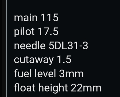

115 in the center two and 117.5 (118 no such thing) in the outside is wrong. The middle two are the ones that run hotter so if anything you want bigger jets in them to be run richer. Do the main and pilot jets have the Mikuni logo on them? For sure someone's been in there and messed with them.

As per Warren's post (and Ultim8's earlier chart) for jet sizes - someone's been fiddling.
Flat ends on the air screws are correct.
Fuel level gauge is a good idea - £20 or so from ZPower.

Mikuni jet logo. Appears on both genuine main and pilot jets.

Agreed its def been played with at some point, i stripped each carb seperately and re assembled before moving on to next one so cant think im to blame, however been back to garage and checked jets again outer ones def marked 118 , inners 115, smaller jets are 17.5 not 117.5 my typo. See photos, i also note 1 of the carbs float post has been repaired, although this isnt the one that leaked and seems to work ok.
So whats best way to proceed, could try and get a replacement set of carbs online, but no guarantee they would be any better, obtain 4 full new jets and keyster gasket sets which would be over £100 + send chokes for repair to Rob another £50 not sure how long they would need to be away? Thing is if carbs themselves knackered im wasting money. One way or the other i need to get it running correctly,

One more random input from me after looking at your last couple of pics. The brass tubes you mentioned earlier - are they the ones at the bottom left of each float chamber in the bottom pic? If memory serves that feeds the fuel/air mix for start/idle. I'm pretty sure that all mine look like the top one in your second pic (that shows both float chambers together) , i.e. a small hole. Is it a catch of the light or has the bottom one been opened up considerably? Sorry to add to the can of worms!
