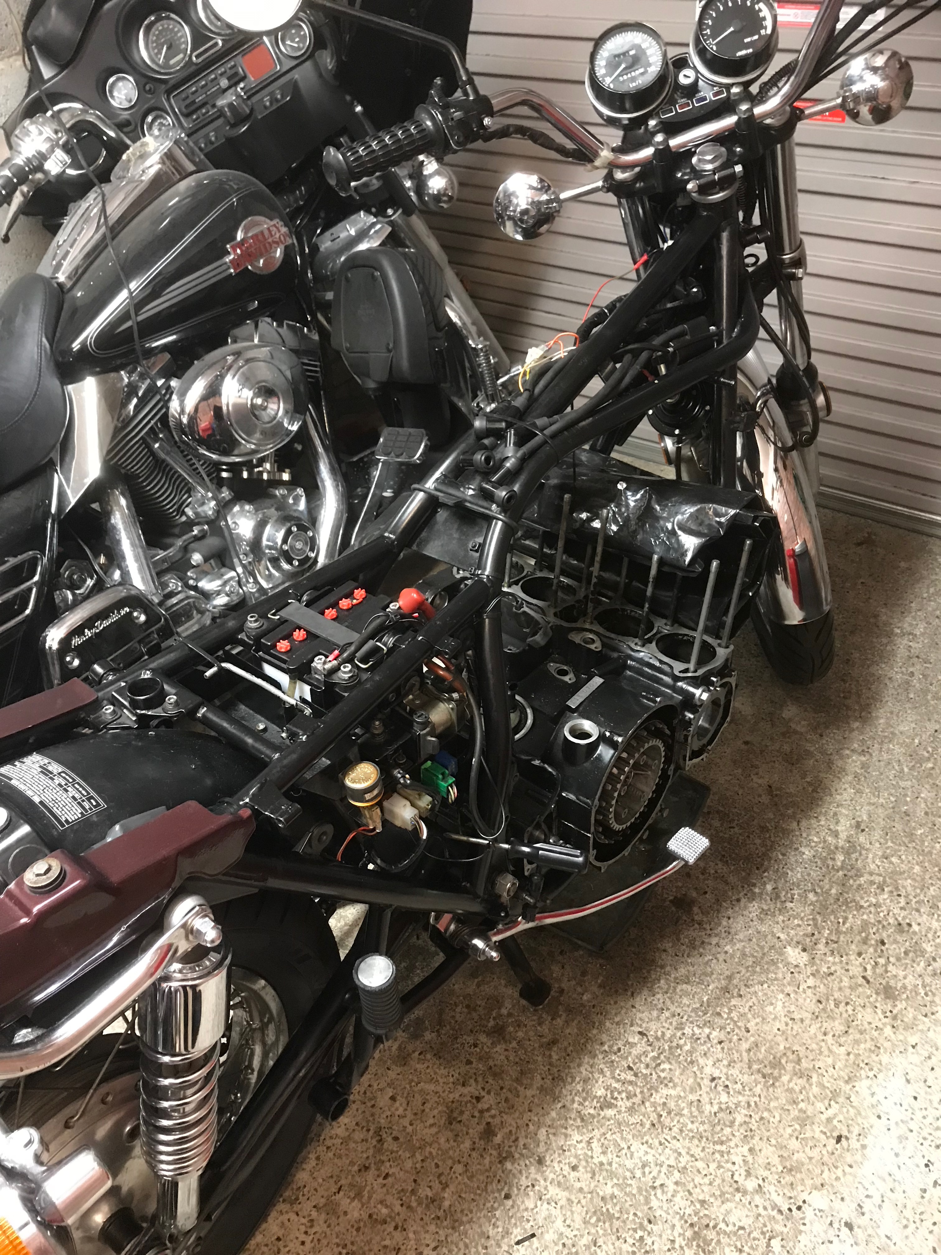

Picture posted. Looks a sorry state I know, but it's being rejuvenated`!!! Hope the motor doesn't make that noise after all this.
P.S the screwdriver is my temporary earthing point. Not an optional extra!

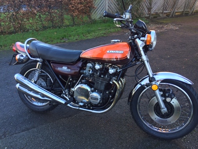

Image before the rip down .But with noise.
