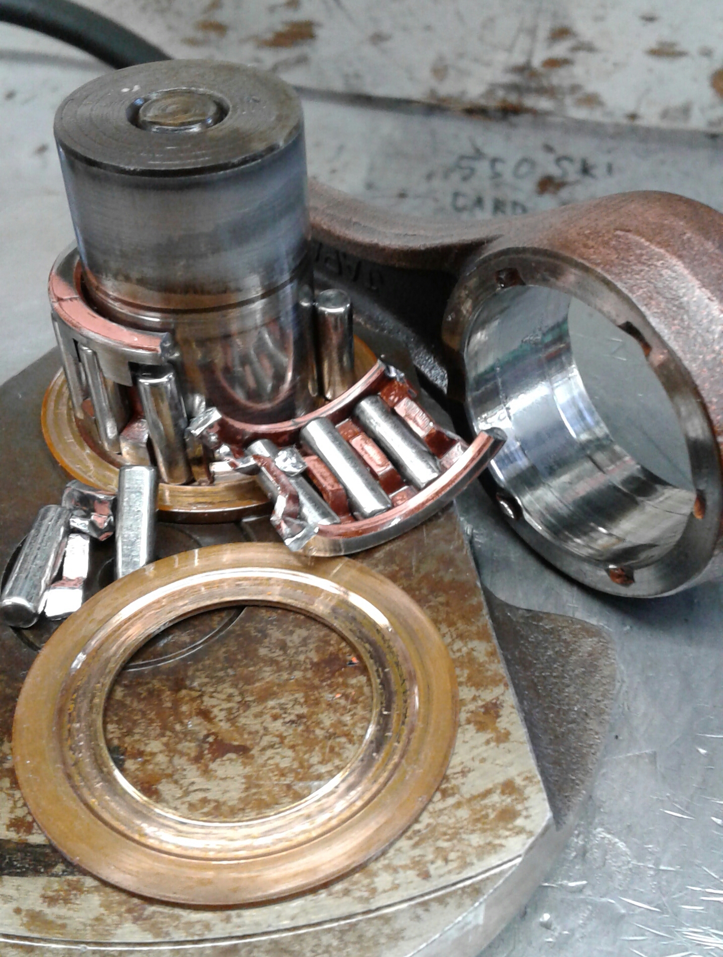

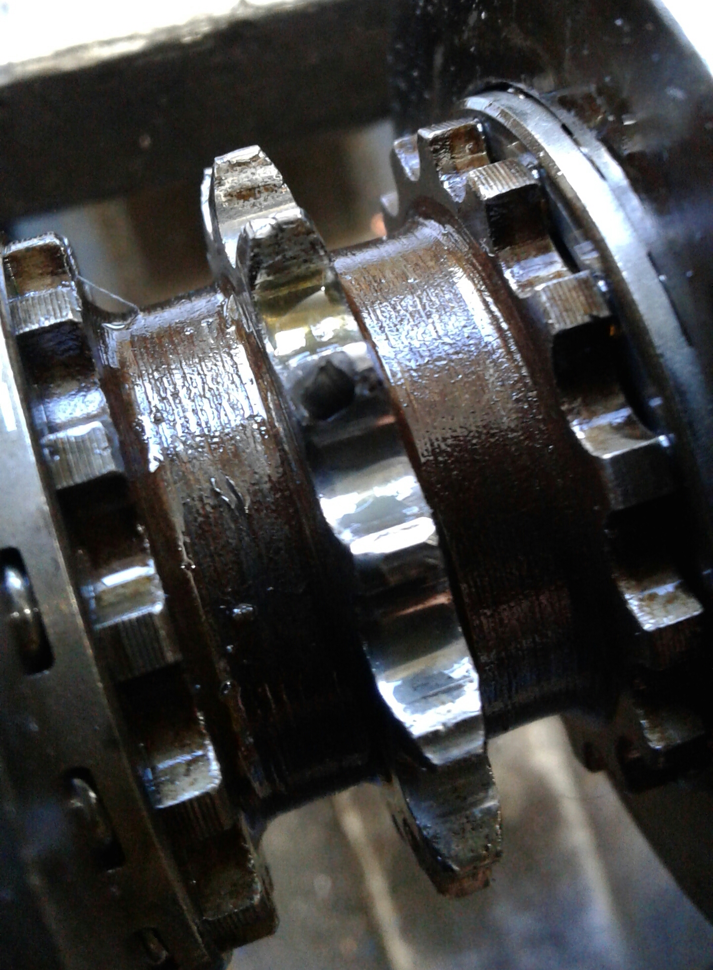

#65 PostAuthor: PJONO » Tue Jan 22, 2019 3:42 pm
AND THE PROBLEM WAS/IS. -....... (Well almost certainly anyway) a collapsed cage roller bearing that was still held in the big end but already in pieces..
Not helped either by the cam chain crank cog that appears to have lost part of several teeth. Though not immediately obvious until a side view could be obtained!!
Pleased I've found the issue. Full crank refurbishment underway. It's fair to say these cranks are robust but by no means infallible :happy
Some pretty good good engineers familiar with cranks in general looked at this and it managed to elude them. The rod didn't exhibit any vertical movement and was still in tolerance with side-play. There was no 'grumble or roughness to the bearing when turning. Glad it's identified as full collapse was obviously on the cards and could've been pretty catastrophic.

#66 PostAuthor: Philippe » Tue Jan 22, 2019 4:17 pm
Hi PJONO
I've never seen that before! What happened to that engine in the past? We'll never know...anyway you found the problem and it'll be solved.

#68 PostAuthor: z1bman » Tue Jan 22, 2019 9:15 pm
i cannot believe that any of the people who have inspected that crank didn't detect any abnormal wear in that rod

#69 PostAuthor: PJONO » Tue Jan 22, 2019 10:36 pm
Chris Applebee upon his initial exam of that particular rod mentioned it was looser than the others upon examining the crank when complete. Guess he sees these cranks daily. Believe me, to the uninitiated, there was no perceptible vertical play, probably due to the the bearing cage still doing its job and further kept in situ by both the big end itself and clamped by the crank counter weight and spacers either side. The lateral movement when I measured it was 0.38mm. Book gave limit of 0.5mm. There was a little bit of a wobble but not a worrying amount. The crank when spun in the cases didn't indicate a roughness. Clearly under power a different story, I hope!!!
Be good to know how it came to be like that - Don't believe it can simply wear like that. The teeth chipped off the cam cog may offer a clue.
Just glad I sent the crank away for strip down.

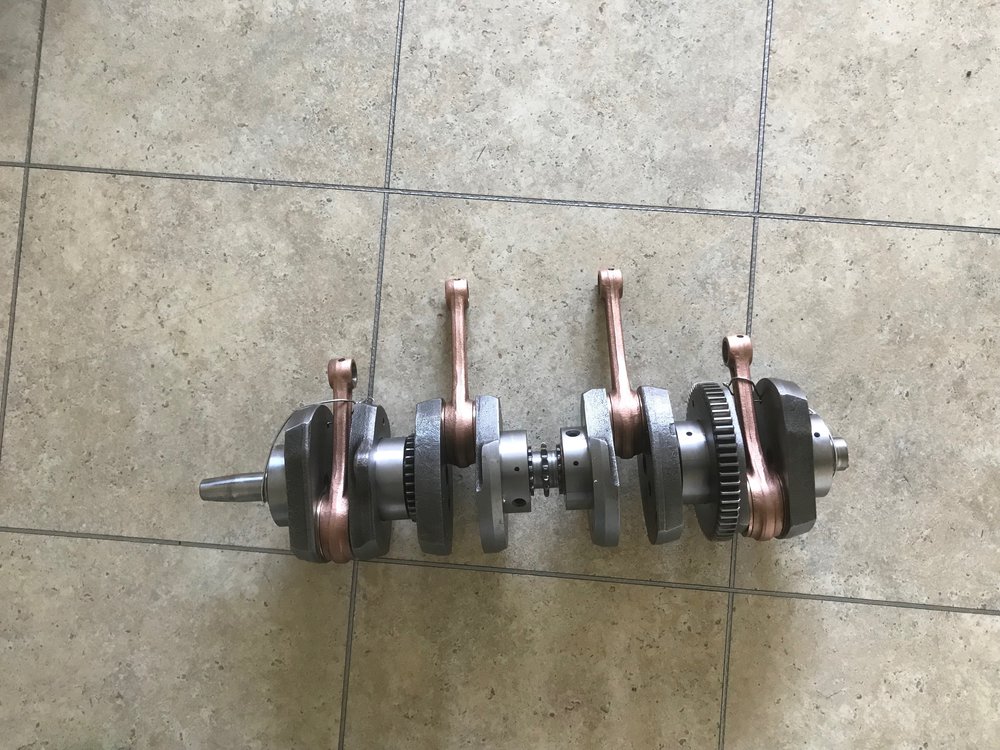

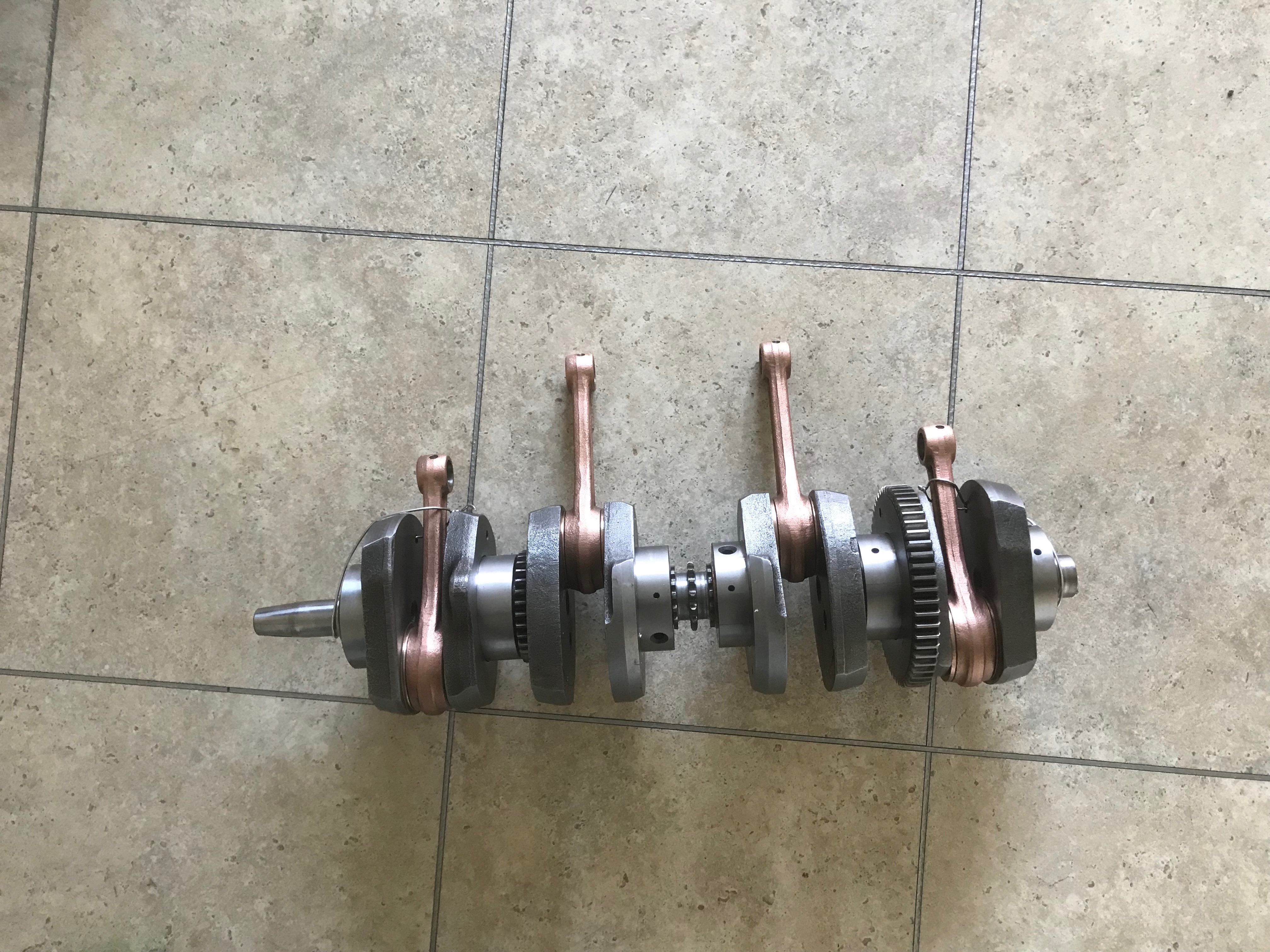

#75 PostAuthor: PJONO » Thu Feb 14, 2019 12:26 am
download/file.php?mode=view&id=10951
Well the crank is back. Fully refurbished- a thing of beauty. Already in bike. Rebuild straightforward to date. Cylinders and pistons on Friday. Get crucified if I do them tomorrow as its Valentine's day.
Replaced all inlet valves and guides in head along with exhaust valve and seals. Be nice to get bike up and running. Do possess a certain amount of trepidation that I press the starter -it starts and the noise remains!!
I have to say the engine is a delight to work on having spent ages working on old Harley's- (I've heard ALL the jokes-so don't bother) Bloody time vampires though these motorcycles I go in the garage honestly believing what I need to do will be an hour max- Three hours later................
