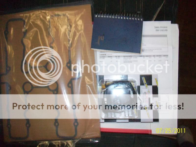

#10 PostAuthor: Blackfox » Wed Jul 27, 2011 4:02 pm
Did it look like this one
Mine came with Jap instructions one day i am going to learn to read it well :lol:
