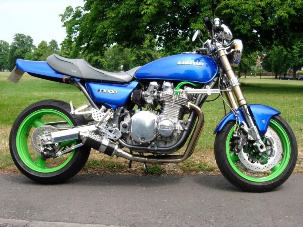

I've got gsxr1100 USD forks on mine no problem. I believe early zx9r forks are also long enough.
GSXR or ZRX swingarms seem popular (can't comment as mine is single sided)
Be good see another modified Z1R.

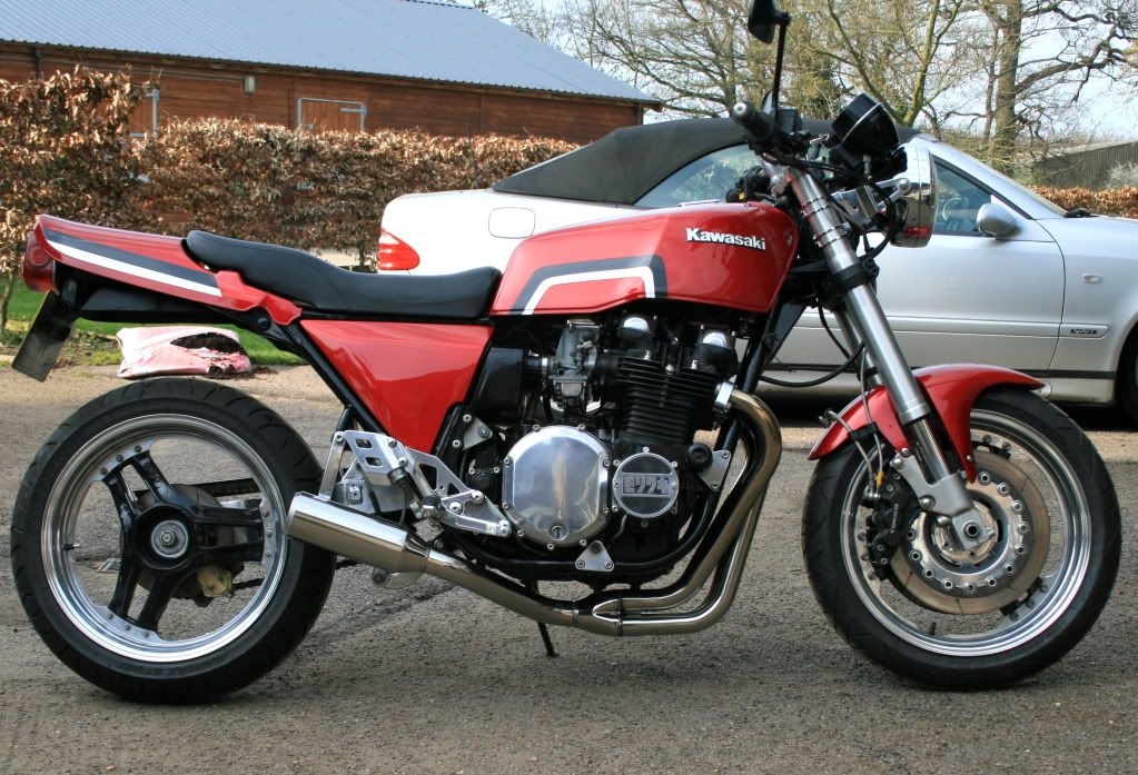

#5 PostAuthor: Ginger Bear » Fri Apr 20, 2012 12:51 pm
ZX7R forks, extended + custom yokes :save :save :oops: GSXR600 SRAD swinger
ZX9RB4 forks (standard length) ZX9R bottom yoke + ZX7R top yoke. :sou GSXR600 SRAD swinger

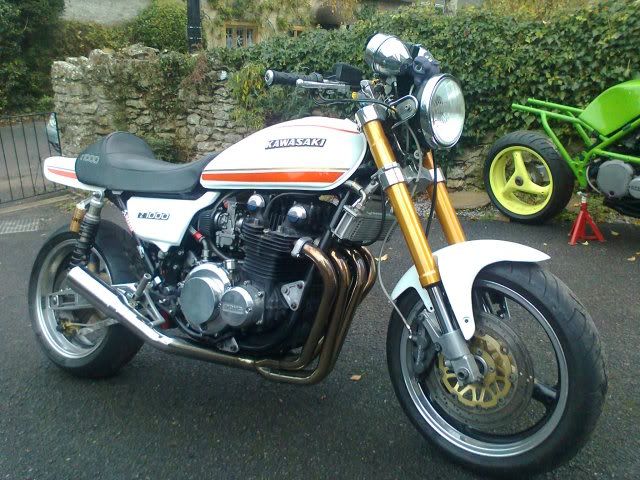

#9 PostAuthor: Pigford » Fri Apr 20, 2012 4:28 pm
Thought I'd join in........
Gixxer stuff :!:

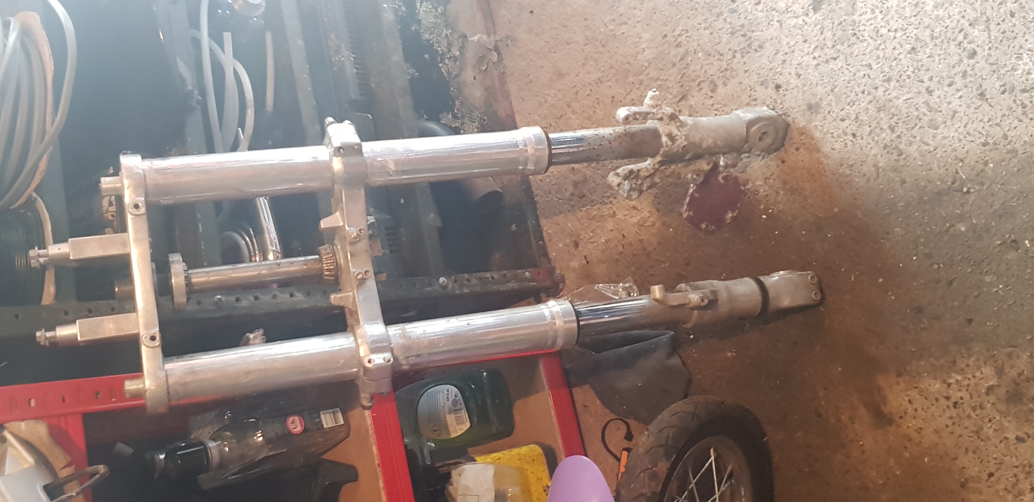

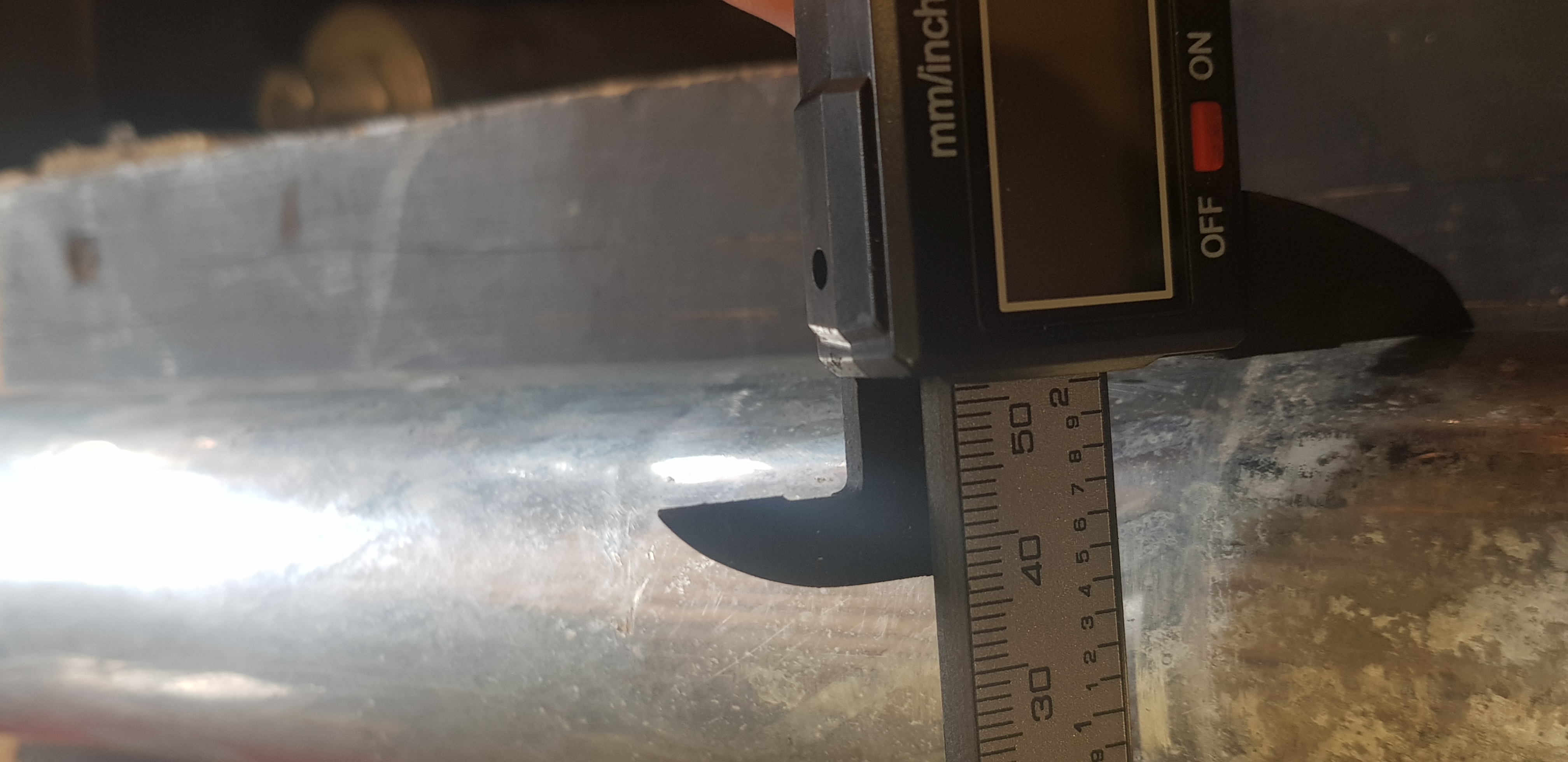

Interesting old thread, I think the forks I have are Zx9r B, they are going on the Z1R project, good news if they are
