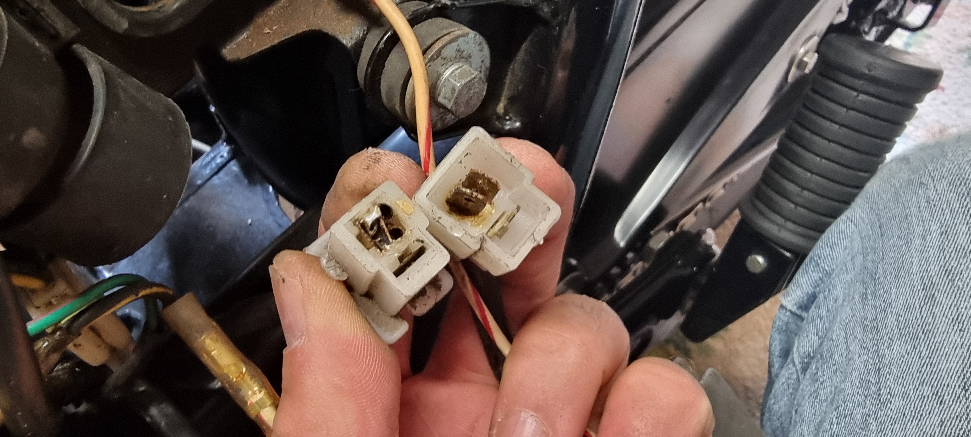

#5 PostAuthor: olnmfc » Fri Jun 14, 2024 1:04 pm
Revisting this post and a few other good similar posts on this site. A great help. So my bike died coming to a stop. Quickly worked out that battery was flat. Kick started it with lights off and got home keeping the revs up a bit. Found some suspect connectors from the alternator particularly this one going onto the reg/rectifier. Will set up a bypass but can you buy the 3 wire wiring section from alternator to rectifier including this connector? Cheers

#6 PostAuthor: Skid Mark » Fri Jun 14, 2024 8:11 pm
I'm not sure if its identical ,but you can get 3way tee blocks and the male and female connectors from bikers tools box.
Or just put bullet connectors on it if you are easy going about these things.

#7 PostAuthor: r3sc » Fri Jun 14, 2024 8:41 pm
I’ve used Bikers Toolbox on a number of occasions for this type of connector and they’re good quality items and match the originals!

#8 PostAuthor: BAFF1960 » Sat Jun 15, 2024 11:02 am
Kojaycat electrical at https://kojaycat.co.uk/epages/950000457 ... Categories have various original style Kawasaki loom connectors and its worth searching their site for other useful stuff.
