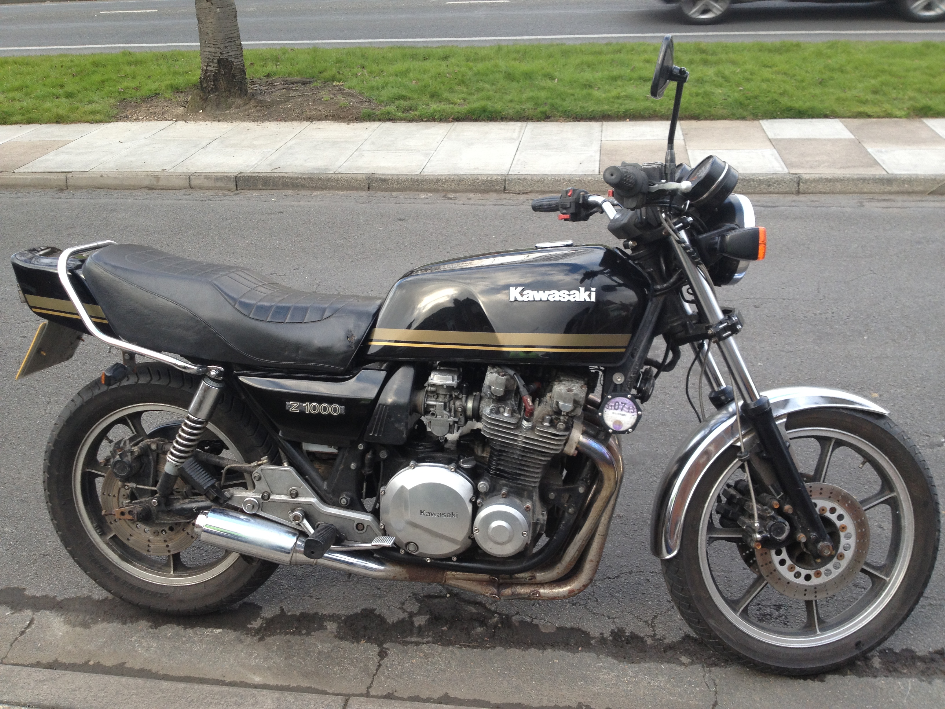

In the meantime, I spent the day in the garage today and, after finishing off the A4 after a rebore, carefully looked over the 1000J for the first time since I bought it. It is X reg (1982) and from the frame number appears to be a J2 (pictured below). There are a number of non original parts on the bike and I am unsure what to look out for. So can anyone tell me where to get hold of/or can they post a picture of:
- original handlebar grips;
- original rear shocks;
- the chain guard - Mine might be original but has a cutaway just behind the shock - which looks original but does not align with the shock
- tell me why the loom seems to have so much to spare from where it passes from the exit point underneath the tank before rising into the headlight shell;
- tell me what lettering should be on the switchblocks. There is none on mine;
- what the colour should be - is it flat black or a very fine metallic black? I have examples of both on two different panels.
As you can probably tell, I know zilch about this model so any info is gratefully received.

#12 PostAuthor: Robw » Sun Mar 19, 2017 8:23 am
Bill, my Lawson still has the original loom fitted and that also has a large loop, near the head stock. I think the original shocks, were the same ones I gave you years ago, which came off the Lawson. I will send you the part numbers of the handlebar rubbers, once I get into the garage. I may even still have the original switch gear, which may have the lettering still on it.
Rob
Posts: 4690
Re: Z1000J Parts book
#13 PostAuthor: z1bman » Sun Mar 19, 2017 9:23 am
grips are the same as this also fits other kawasaki models
http://www.ebay.com/itm/46075-1022-NOS- ... 1429865431
Posts: 4690
#14 PostAuthor: z1bman » Sun Mar 19, 2017 9:25 am
colour is METALLIC STARLIGHT BLACK
Julian_Boolean
Posts: 804
Joined: 20th Oct 2016
Location: Ipswich
#15 PostAuthor: Julian_Boolean » Sun Mar 19, 2017 8:42 pm
I've got switch gear you can have as well, and yes the wiring is too long for the bike.
