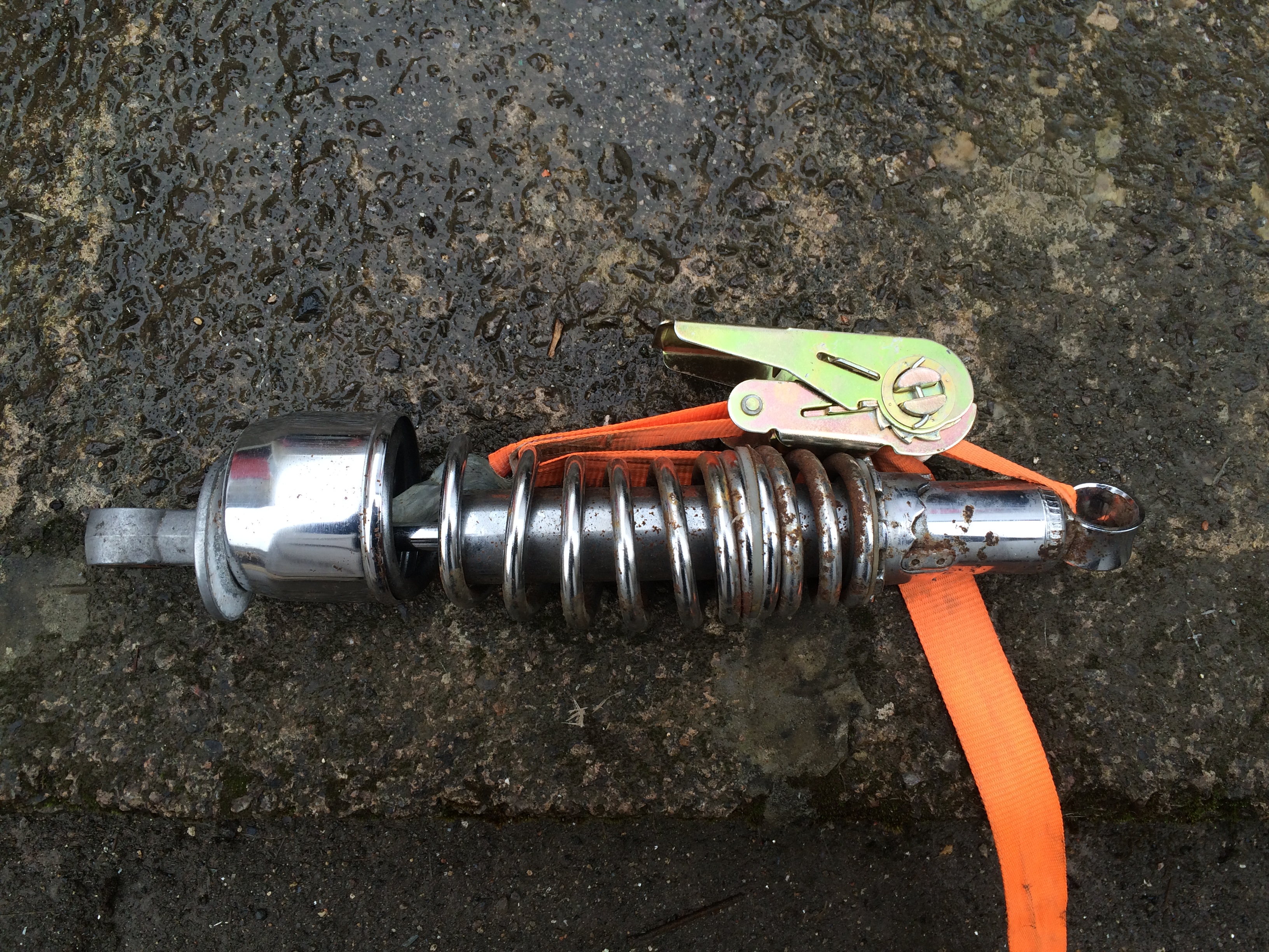

I use 2 ratchet straps to do this, 1 either side of the spring , doesnt do any damage when refitting. Very cheap too!

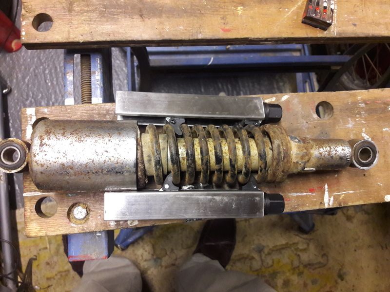

So after trying several things to get the springs off, finally bit the bullet and ordered some of those Sealey spring compressors - the claws did look a bit chunky at first, but did fit between the coils worked great

Good info & pic ta.
I was a bit concerned with access cos the ZRX shock has a plastic sleeve sitting just inside the spring at the lower part - and I didn't want that to foul the hooks.

Here's the ratchet strap in action, I managed to pull these shocks apart with 1 strap

Wow Pluto !!!
I have obviously underestimated the power a ratchet strap can safely exert.
Would not have believed you could do that with just one strap.
I plan to deffo use 2 to keep the pull even.
Thanks v. much for the pic
and to jack for his pm info on same subject.
Cheers Lads
