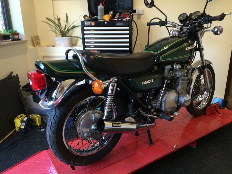

Can someone in the "know" tell me what tio check when looking at a standard/original A4 please.
Frame number Z1F507793
Engine number Z1E110077
I am venturing over the DARKSIDE and will be looking at a bike this weekend, so pointers on date codes, etc would be mucho appreciated!
If anyone would be willing to talk to me (can only hope) send me a PM and I'll call you this evening.
Cheers boyz :P

#3 PostAuthor: Pigford » Thu Mar 23, 2017 5:19 pm
Cheers for the link marmck!
The bike has the following frame/engine numbers....
Makes it an LTD in my book??????? Or am I wrong?
KZ900A4???
Re: KZ900 A4 - Distinguishing marks?
#4 PostAuthor: Garry.L » Thu Mar 23, 2017 5:40 pm
My old A4. Original unrestored (except paint). Good for a comparison.
http://s46.photobucket.com/user/J7MGX/slideshow/Z1
From your pic the Bars are wrong and tail light bracket looks to low.
#5 PostAuthor: Pigford » Thu Mar 23, 2017 5:46 pm
Garry - whats this (LTD?)
#6 PostAuthor: Garry.L » Thu Mar 23, 2017 5:52 pm
Pigford wrote:Garry - whats this (LTD?)
Numbers match Z-Powers site for a Ltd B1.

#7 PostAuthor: Pigford » Thu Mar 23, 2017 6:09 pm
If it's an American "Nebraska" built bike - could it be in the same range as the LTD?

#8 PostAuthor: warren3200gt » Thu Mar 23, 2017 6:14 pm
All the frame and engine nos arranged by capacity and model
http://Www.zedder.com
Bike and cd info tab
Year & Model '77 KZ900-A5
Color(s) (1) Dia Dark Green
(2) Dia Brown
Frame No. Range Z1F-510341 - 515578
Engine No. Range Z1E086001 - 138846
Engine No. Location RH top crankcase, below carburetor
Cylinder Mark 903 cc
Cylinder Mark Location Front RH corner
Engine Type 4-stroke, 4-cylinder, DOHC, Air cooled
Bore X Stroke 66.0 X 66.0 mm
Compression Ratio 8.5:1
Maximum HP 81 at 8500 rpm
Maximum Torque 7.3 kg-m at 7500 rpm
Re: KZ900 A4 or LTD Frame/engine numbers????
#9 PostAuthor: Pigford » Thu Mar 23, 2017 6:18 pm
According to Dave Orritts "Buyers Guide" the A5 was built in Nebraska, numbers Z1F 500001 > Z1F 521344
Confused dot cum :rock
#10 PostAuthor: Pigford » Thu Mar 23, 2017 6:36 pm
Cheers Warren3200gt
Year & Model
'76 KZ900-A4
Color(s)
(1) Dia Dark Green
(2) Dia Brown
Frame No. Range
Japan MFR Z1F-085701 - 117060
USA MFR Z1F-500001 - 510340
So, it fits an A4 Nebraska spec - not much between the A4/5 & LTD apart from obvious bodywork, wheels, rear disc, pipes, shox...
The LTD:
'76 KZ900-B1:LTD
Color(s)
Classic Red
Frame No. Range
KZ900B-500011 - 505514
Engine No. Range
Z1E086001 - 117973
.....which rules out the frame!

#11 PostAuthor: kev edwards » Thu Mar 23, 2017 6:43 pm
Piggy, i have read it's a 1976 A4 frame, and the motor number series covers 1976 A4 and 1977 A5
#12 PostAuthor: Pigford » Thu Mar 23, 2017 6:56 pm
Cheers Kev - just wanna make 100% sure its okay before I traipse up there & leave a deposit :??

#14 PostAuthor: Pigford » Thu Mar 23, 2017 7:15 pm
Thanx - I think that's also where all the info is leading from my own (laymans) investigations :P

#15 PostAuthor: z1bman » Thu Mar 23, 2017 7:36 pm
as already mentioned it has the wrong tail light bracket the one fitted to the bike is for the uk long rear mudguard
