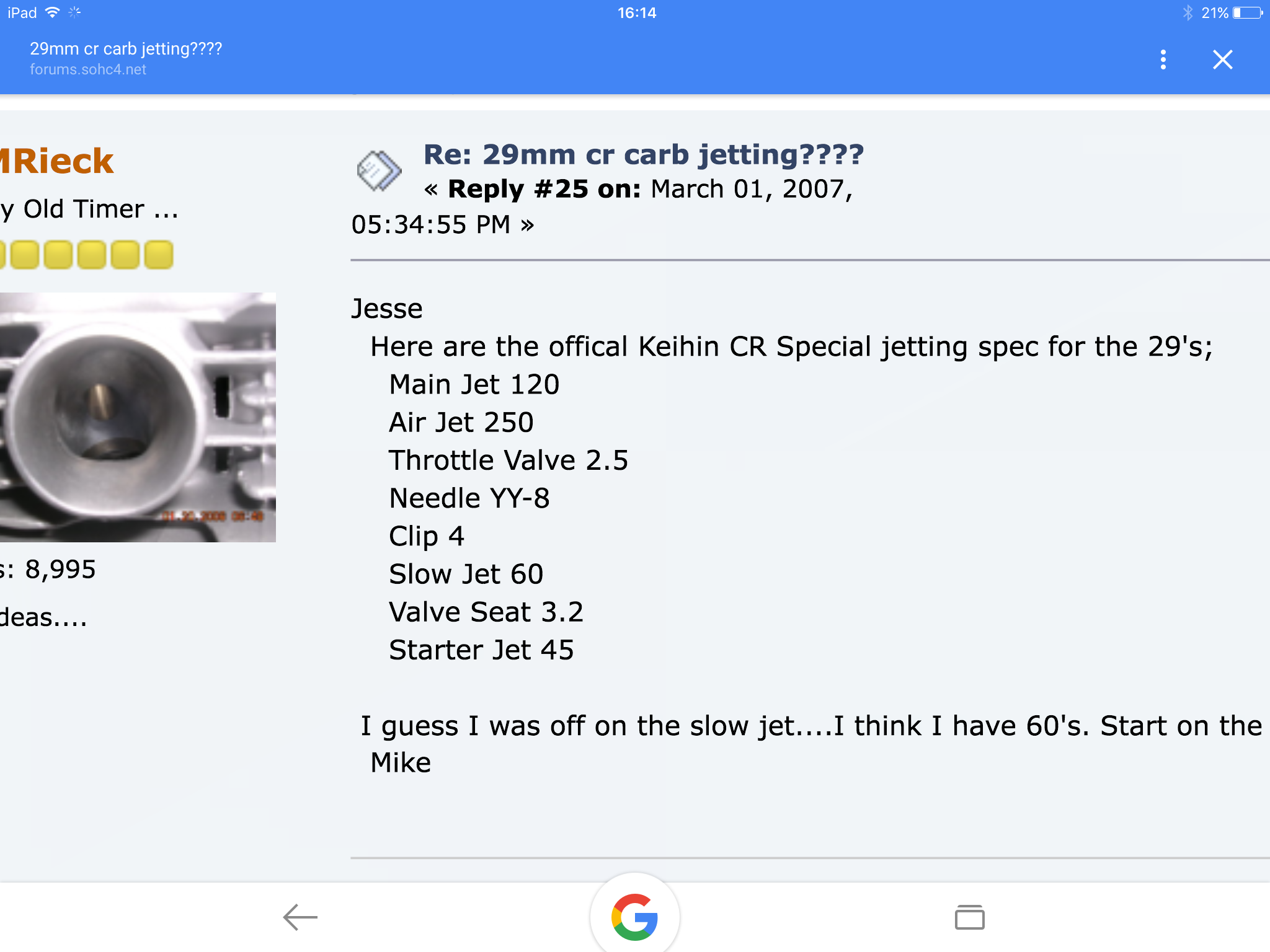

Hi Harvey, I use cr29 with 55 pilot jets and 125 mains and they run lovely

29s shoud be perfect for a 900 - they're hardly going to strangle it as they'll be flowing more than the standard carbs :D . You'd also be better with a bigger tap for that reason. One thing about the CRs I was advised that you can't really set them up on vacuum gauges (and which from my futile efforts before I was told this appeared to be correct) you need to synchronise them up on the bench using the feeler guage/bit of wire method.

Thanks for the info had a look today the needles were set at 2 instead of 4, the pilots are 65 instead of 60 so will change these and put back on and she how she runs.
