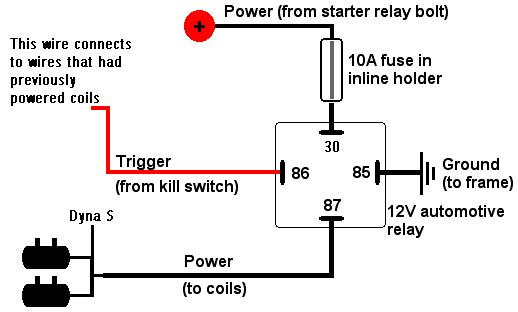

I heard somewhere that Dyna S does draw quite a bit of current, to overcome this, there is a modification you can try called the "wired george" mod, by adding a relay to the circuit from the battery, thus:

Sounds like the original regulator and it has probably goosed the battery. Bin it, fit a combined unit and do the "Wired George" mod while you are on.

I took the battery out last night and put it on the optimate. This am the optimate says the battery is "weak" . I've already had the R switchgear apart and checked all the wiring. Never tried the killswitch on/off tho. Battery replacement seems inevitable now however. Where do I get one of these relays - do I just read then the mumbers as per the diagram?

http://www.vehicle-wiring-products.eu/p ... with-diode
you will get everything you will need here including the japanese bullit crimp connecters
