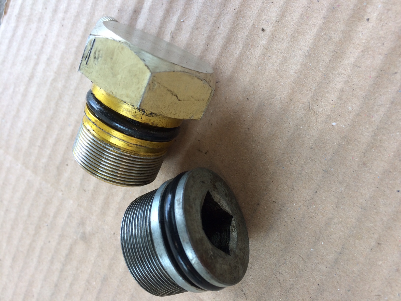

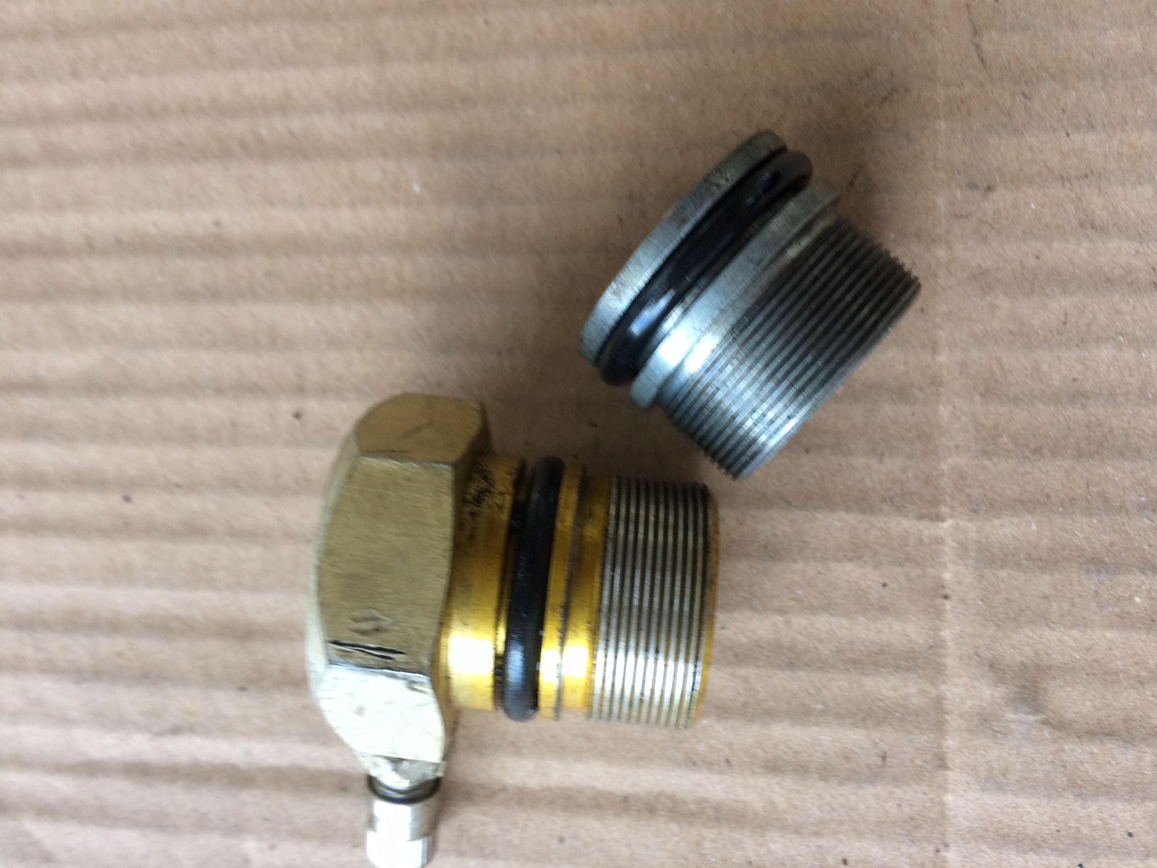

#7 PostAuthor: BigZCas » Sun Apr 23, 2017 1:28 pm
Ok there you go -
There first picture shows the fork tops with the nipple.
And before anyone says it "yes and the tit on the bike" :lol:

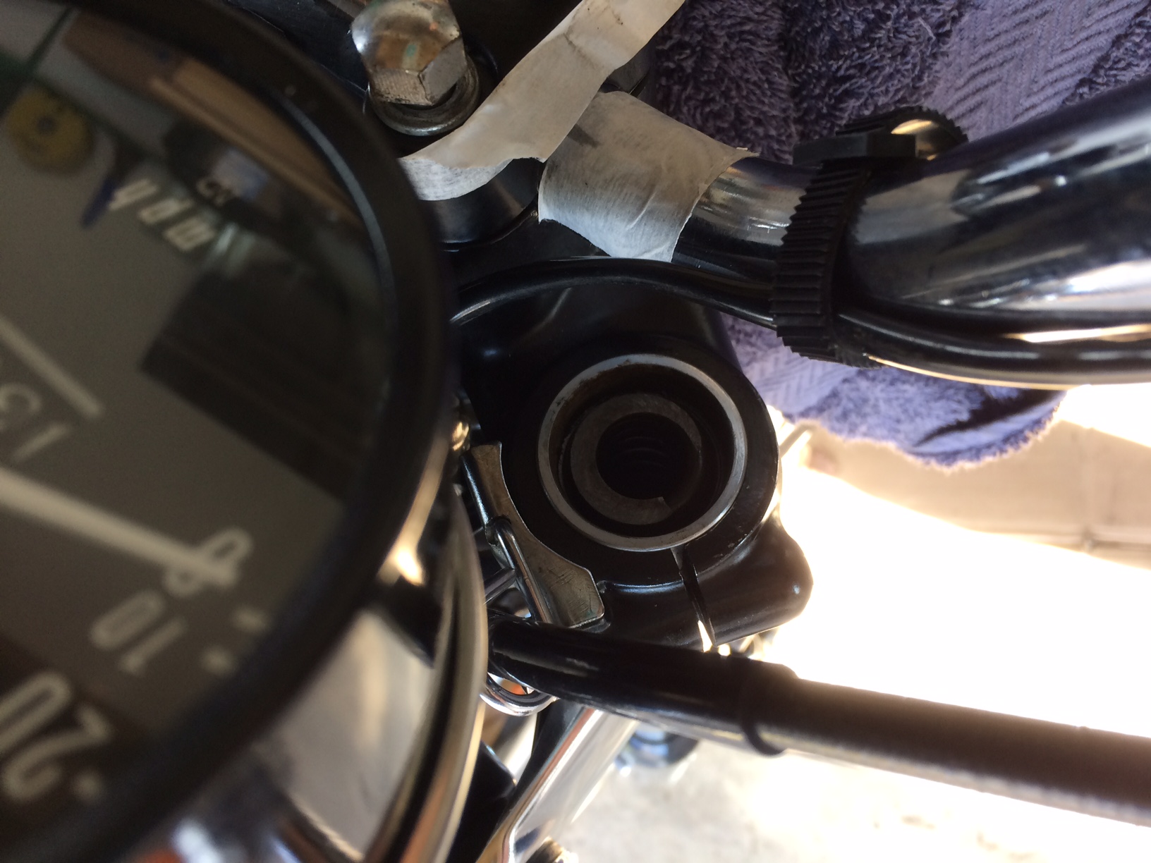

#8 PostAuthor: kev edwards » Sun Apr 23, 2017 2:27 pm
Well you definately have A2 fork lowers, i have just measured the inside of an A2 top leg and before the thread starts it's id is 30mm so the thread is definately 30mm, if the grey coloured top does not go in, a previous owner has replaced the stanchions with some from a different set of forks.

#9 PostAuthor: z1bman » Sun Apr 23, 2017 3:26 pm
a1 fork inners

#14 PostAuthor: BigZCas » Sun Apr 23, 2017 5:45 pm
Ok,
Just measured across the open part of my fork tops and they measure as Kev says 30mm so that means that the threads cant possibly be 30mm other wise the plain part of the grub screw type top would not slip inside.
Measured the silver grub screw type top and the thread is 30mm but the plain part is 33mm so no way would go into the forks either thread or plain part.
Must be different to the Z650 etc so the incorrect parts purchased from ebay.
Think I am going to have to pester Dave (Saisei) tomorrow !!

#15 PostAuthor: z1bman » Sun Apr 23, 2017 7:37 pm
