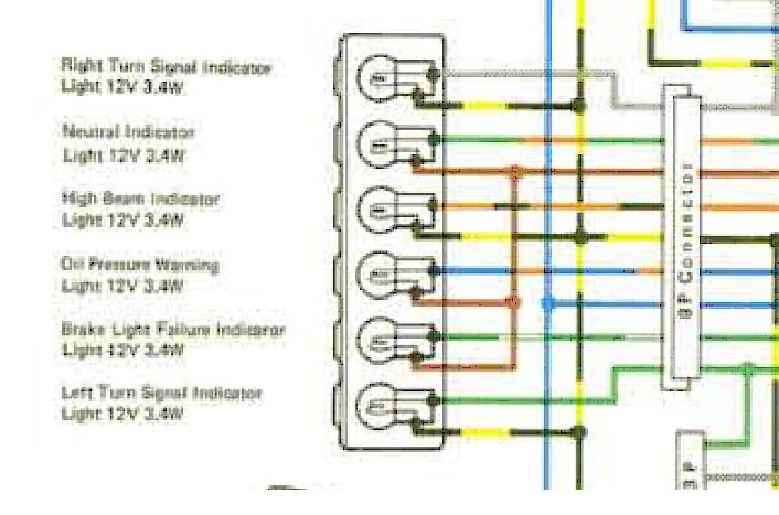

I have just had a look at the diagram and i would say the brake light failure idiot light shares switched (ignition) 12v with the oil pressure and neutral idiot lights (Brown wire) . This would suggest to me that the break is in the indicator light harness after the 12v feed splits.
I think you can rule out the brake light failure switch because this works on the earth side (green/white wire).
Try taking the tail light bulb out and jumping power from the 12v feed to the neutral or oil light. If the brake failure light flashes the switch is working and you have proved the harness is faulty.

ZedHead wrote:I have just had a look at the diagram and i would say the brake light failure idiot light shares switched (ignition) 12v with the oil pressure and neutral idiot lights (Brown wire) . This would suggest to me that the break is in the indicator light harness after the 12v feed splits.
