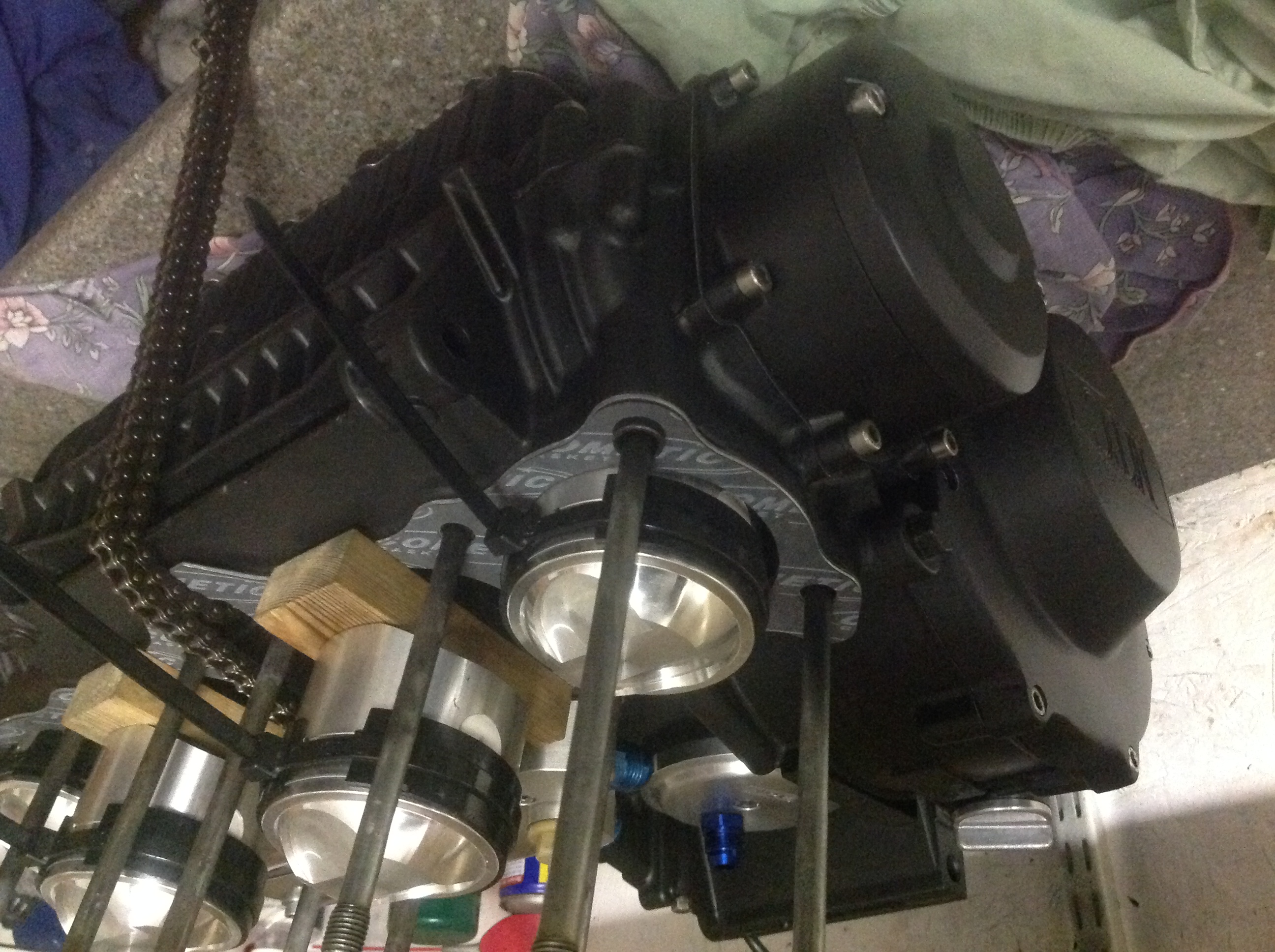

So I made some of those piston ring clips out of drain pipe and bought cable ties, tonight I made the wooden pieces to hold the pistons still. So far so good.
I then go to try the little blocks of wood in place, turn the engine slowly to raise the middle two pistons and then the bloody cam chain snarls and lifts the guide dislodging the little rubber blocks, one of which I can't find. I assume it's either gone down the cam chain tunnel or down one of the inner 2 piston holes in the crank case. The air turned blue at this point.
Question is, where do I go from here ? Is it likely to do any harm ? Might it come out if I drain the oil ? Or am I screwed and have to strip the whole flaming thing down ?
Felling like a prat !
Paul

#12 PostAuthor: ZedHead » Tue May 23, 2017 4:44 pm
slappa13 wrote:Works well
Even better with the engine the right way up :up

#13 PostAuthor: 1975-S1C » Tue May 23, 2017 6:15 pm
Yeh I know, funny right !
But I do need to sort it, and being completely new to working on Z's (not that you can tell) I do need some pointers.
Am I screwed ? Or what can I do to get that rubber block out of the engine ?

#15 PostAuthor: 1975-S1C » Tue May 23, 2017 6:37 pm
One of the two little rubber blocks that sit on top of the lower cam guide wheel shaft.
Yes, very new to working on zeds, though I do have a triple, but that is of course a very different beast.
