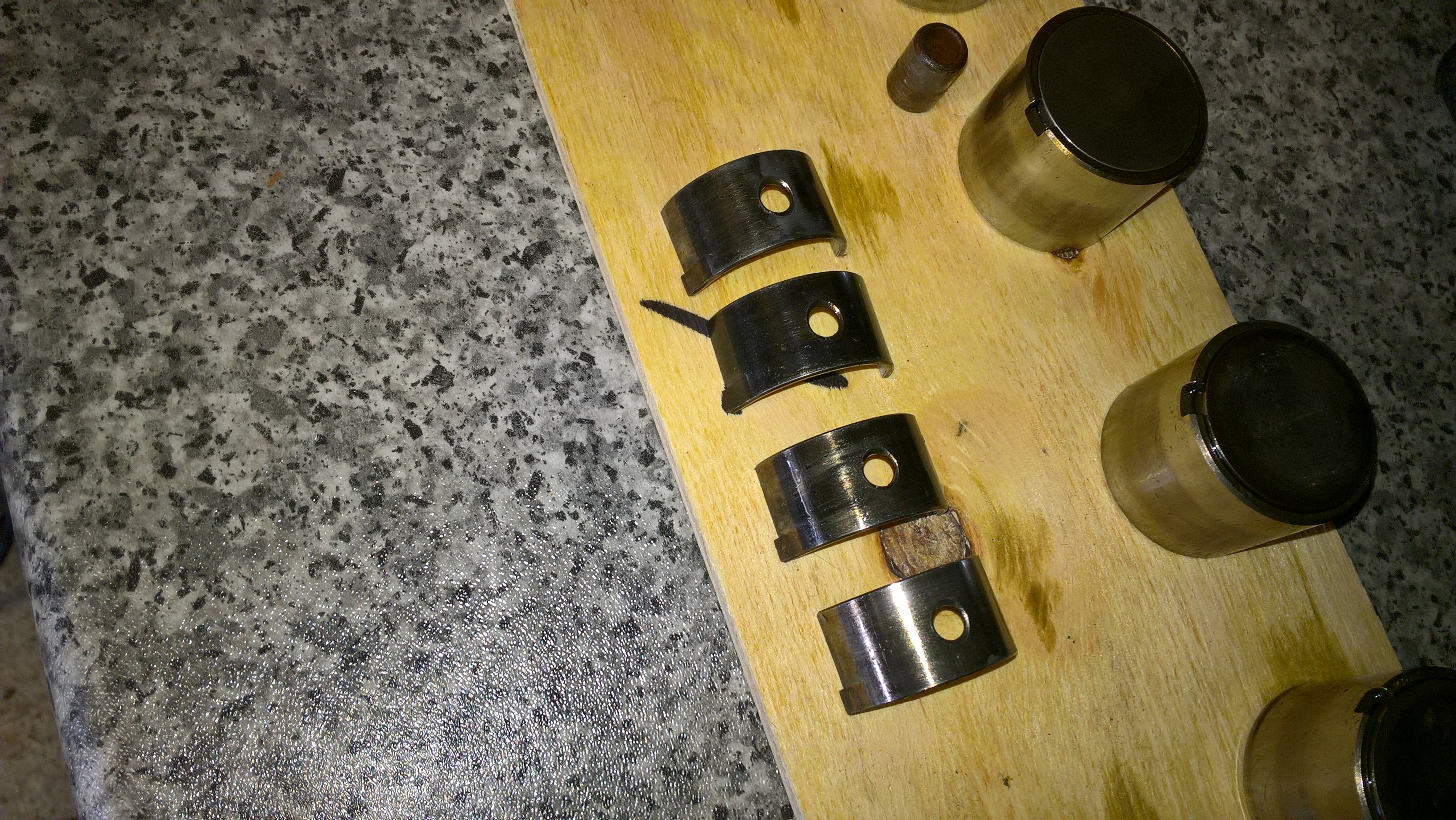

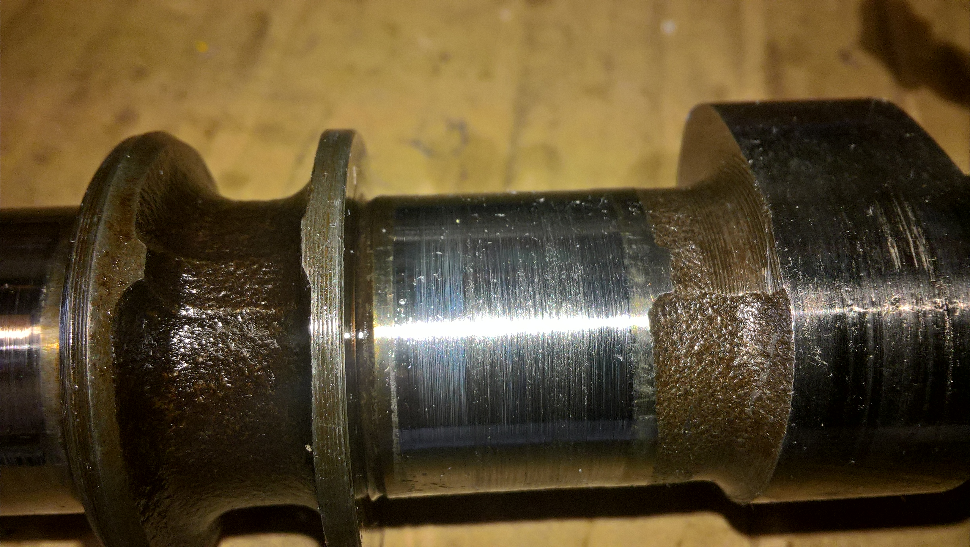

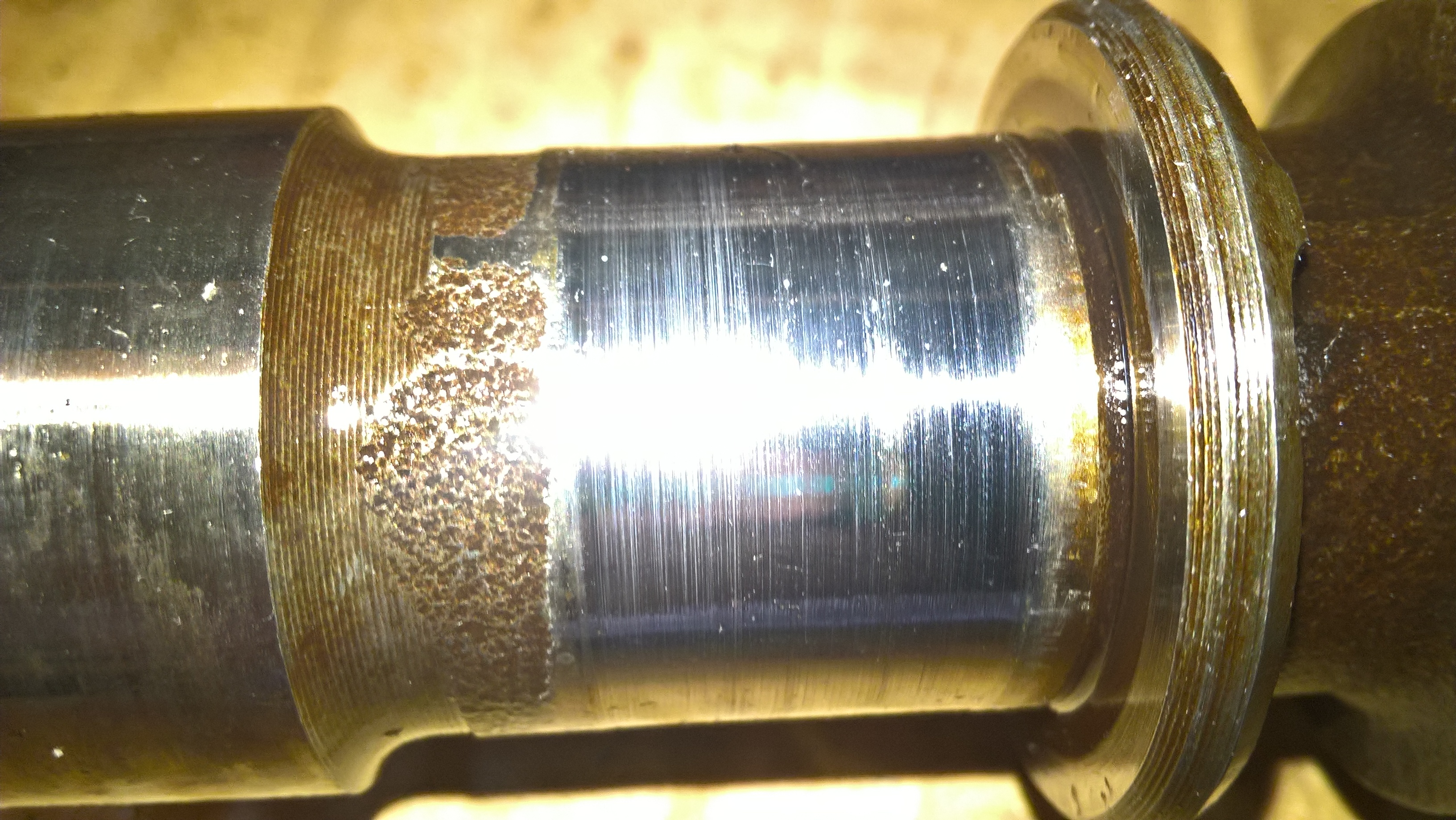

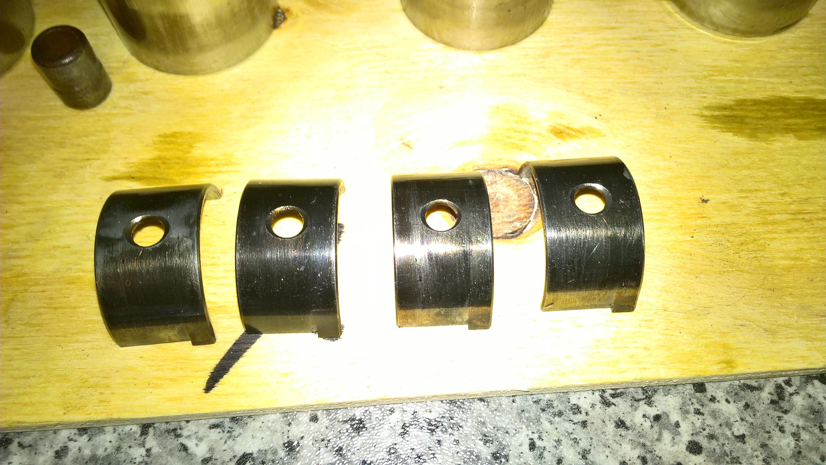

Well today the head was removed,at some stage there has been some massive overheat in there even the alloy under one of the cam cap bearings has evidence of overheating, exhaust bearing shell lowers are black on the back and the surface like sandpaper, left side exhaust cam journals i could use as a file, one cam cap has had holes drilled to 8mm, one bolt has snapped off most holes have helicoils, 3 spark plug holes have been repaired badly and the remaining one is letting by, valve shafts exhaust side are polished almost black , a few of the valves are not seating properly, the head to to barrel locating dowels are shot and one is jammed in, one of the 6 mm head bolts is stripped, so the head is pretty much toast, i would chance my arm and say a PO has had a disaster with it, and thrown it back together and got it running after a fashion and i am the unlucky bugger sorting it out, i find it hard to believe they spent a huge amount of money on the rest of the bike and neglected the motor, looks like i am in the market for a complete head cams and valve gear included, i have made one inquiry and hopefully it will come through for me.
