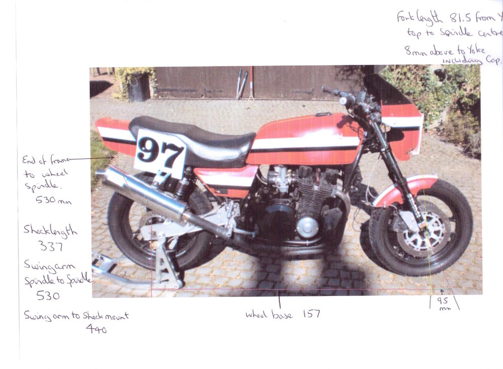

I have found a picture we drew up from Robs Orange before he fitted bandit forks.
It was fine like this but bandit forks have less offset.

Al has but Rob has'nt on the picture above.
His swing arm gsxr slabby is 530mm
Also the orignal Lawson bikes did not have that done, but they did run less offset.

Like the guys say they are are bit of a barge (ignore the shock lengeth on the picture above as the brackets are were well forard on robs swing arm.
I think that Gpz'S Standard are 365 as are zrx's. Like Al suggests tip it on its nose that should help.
