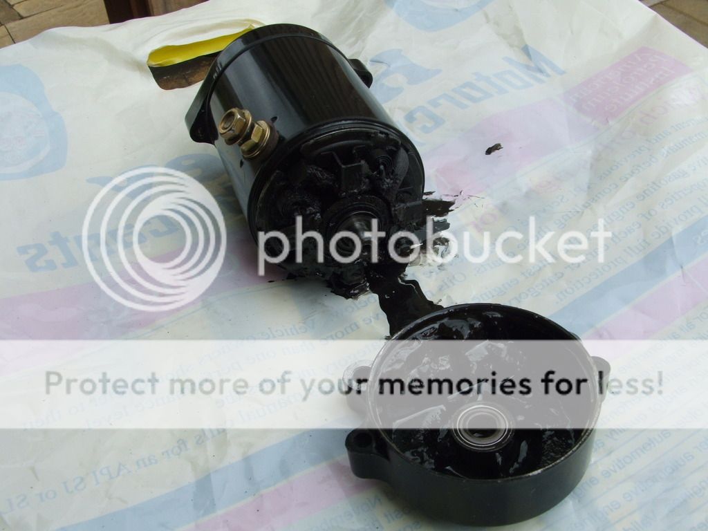

Hi Chaps,
Starter motor died on my Kawasaki ZRX.
When I stripped it down it was full of oily grease - both ends.
No one in the ZRX forums has ever seen this before.
Anyone on here seen or encountered it before please?
I can only imagine it is engine oil getting in past a seal or O ring from the crank cases
OR
Something in the SM itself is breaking down and releasing oily gloop.
Any advice appreciated. Don't want to refurb/ replace and find it is due to something I have not fathomed out and it happens again :-( :-(

#4 PostAuthor: z1bman » Sun Jun 18, 2017 6:18 am
yes its not uncommon. it would be worth giving cradley a call & speak to the technical department as i think there was a service bulletin regarding oil leaking into the starter
