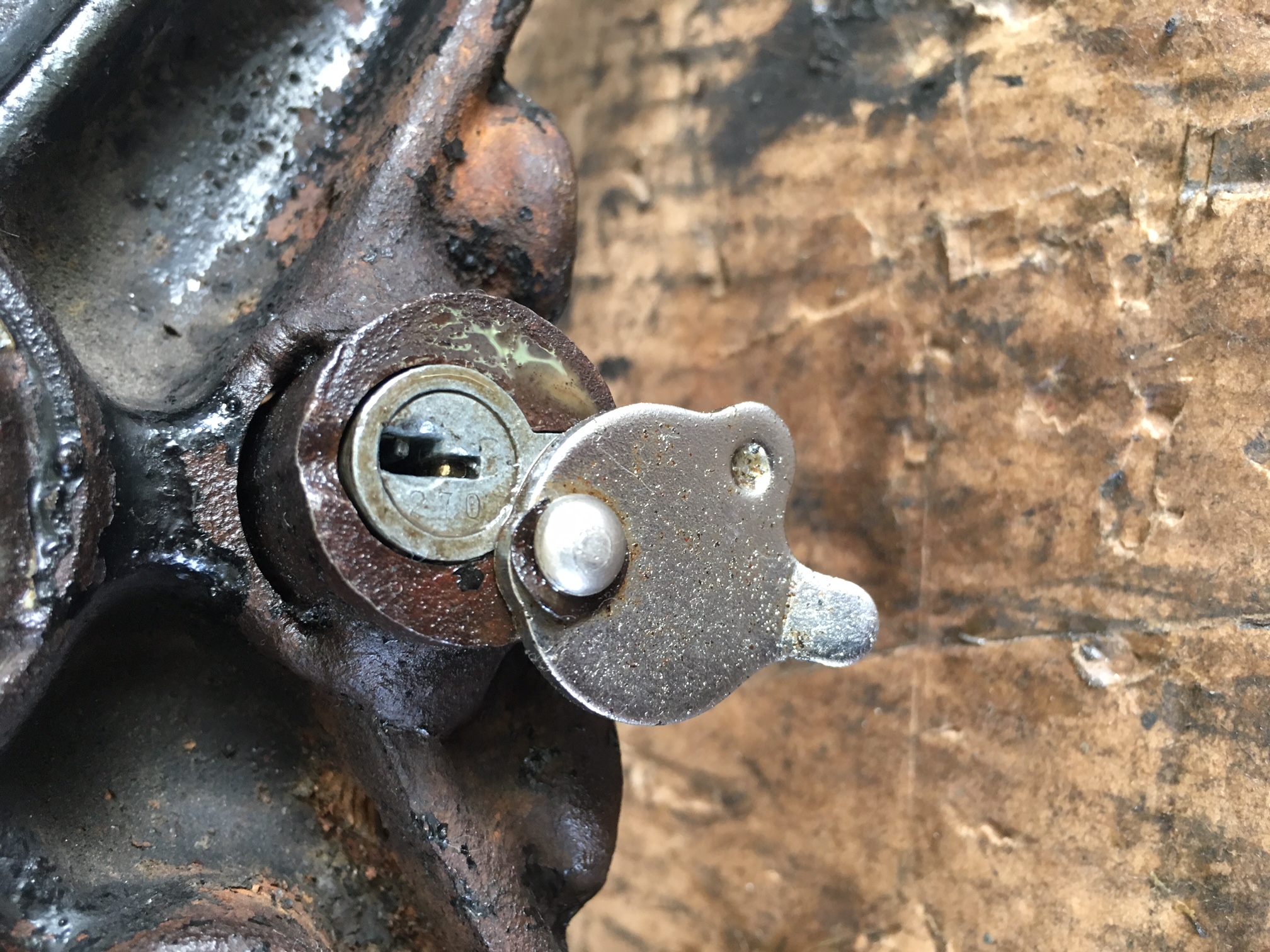

Can any advise - (UK - Z1a)

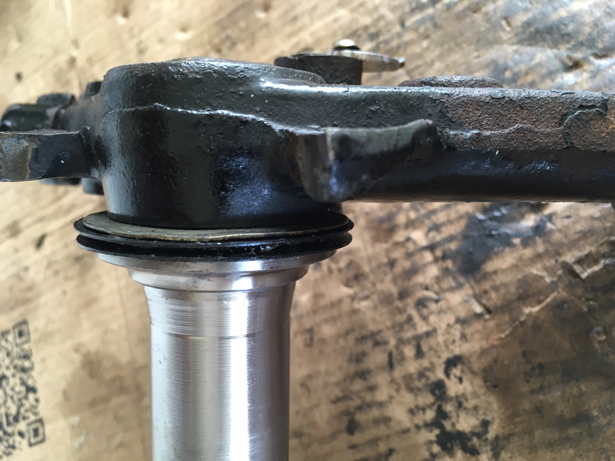

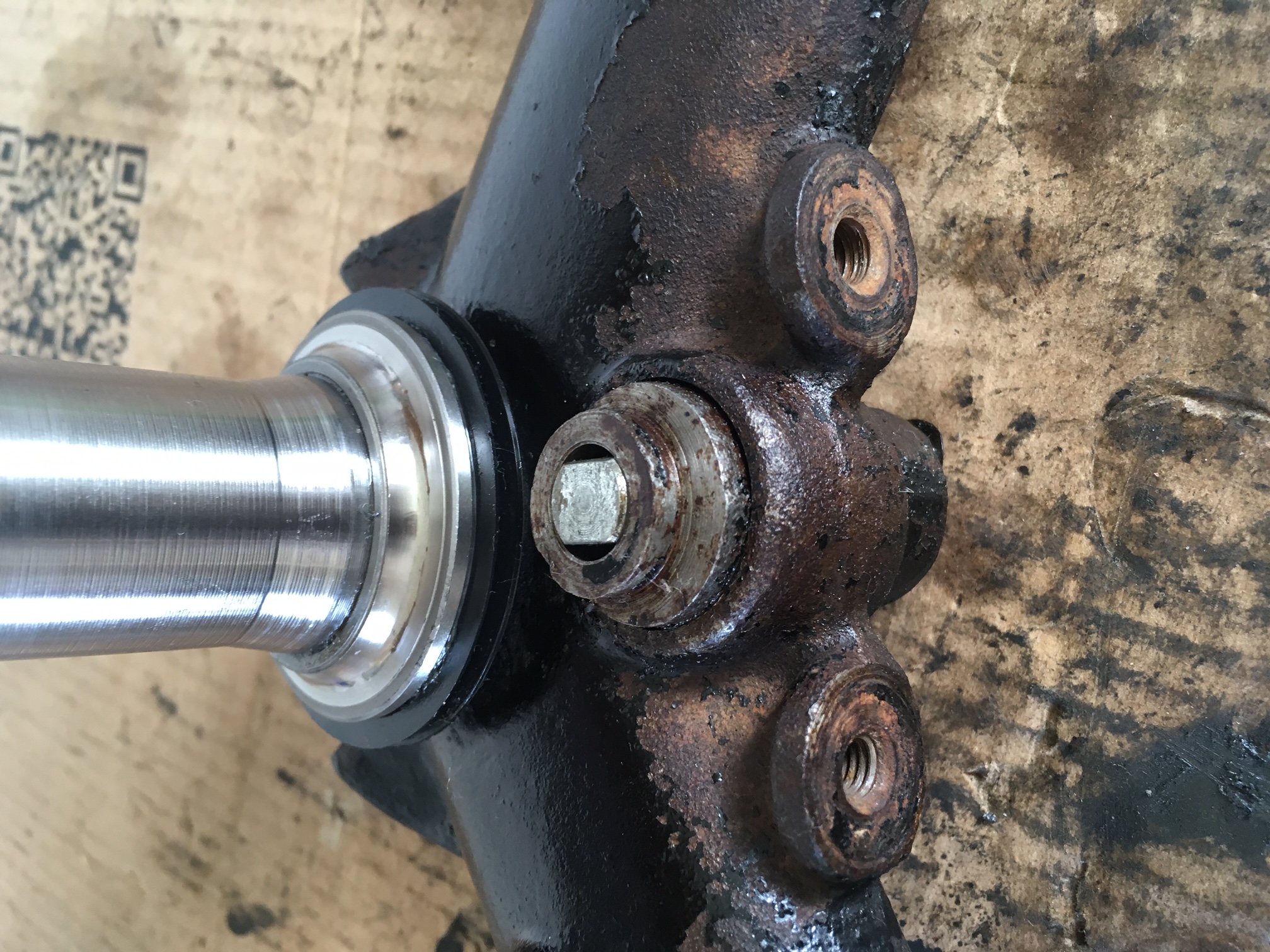

Best way to remove the seal and 1/2 bearing from the bottom yoke ?
How to remove the steering lock (Is it the cover rivet holding the lot in) ?
Any help ,much appreciated. :)

Took last one off with a dremmel with fine cutting disc a touch at a time,seem to recollect there is a pin in the side that retains the lock,could be mistaken on that one though,you going for the taper bearing upgrade?..Paul J

The Haynes manual says that the UK lock is a Neiman Lock secured by a rivet, the one on the cover is the only rivet that I can find, but not convinced (no rivet or screw in the side) ??

#4 PostAuthor: 000zeds » Sun Jul 09, 2017 7:30 pm
That is a tapered pin and not a rivet :!:
Ease the pin out and put the key in to remove the lock :!:

#5 PostAuthor: BigZCas » Sun Jul 09, 2017 7:49 pm
Ahh thanks,
Problem, No key :( :lol:
also no number :roll:

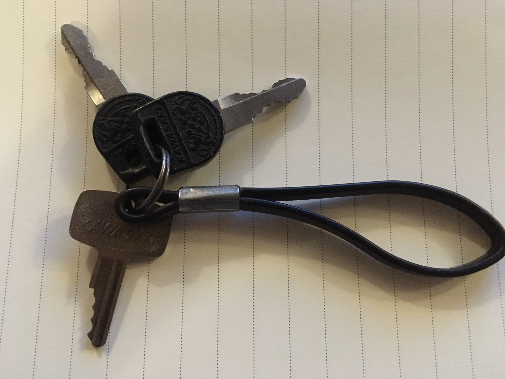

BigZCas
Posts: 479
Joined: 17th Dec 2016
Re: How to remove ??
#8 PostAuthor: BigZCas » Mon Jul 10, 2017 6:11 am
No number on the uk type !
Looks like check mate :(

BigZCas
Posts: 479
#9 PostAuthor: BigZCas » Mon Jul 10, 2017 6:15 am
Spotted it from the blown up picture :lol:
cheers :D
Will pm
Past 5 Years
1978 KZ1000a2, Luminous Green
1976 KZ1000a1, Red
1972 GT750J, Candy Lavender
BigZCas
Posts: 479
#10 PostAuthor: BigZCas » Mon Jul 10, 2017 8:38 pm
Cant believe it ...
So now I know the number and check on the keyring that I was given with the bike and
there is a key with exactly the same number :oops:
Well it looked big :??
what a complete ****
Sorry

#12 PostAuthor: swampy » Fri Jul 21, 2017 7:55 am
I remove the bottom steering stem bearing with a blunt wood chisel. using the taper of the chisel to lift bearing off the taper on the stem.
give the chisel a tap on each side of the bearing in turn until bearing lifts of stem taper.
best method to fit new bearing is with a length of gas barrel of the needed dia. slid over the stem. double check the correct fitment of shim and seal before fitting bearing as if you fit them in the wrong order you will be buying a new bearing kit.
