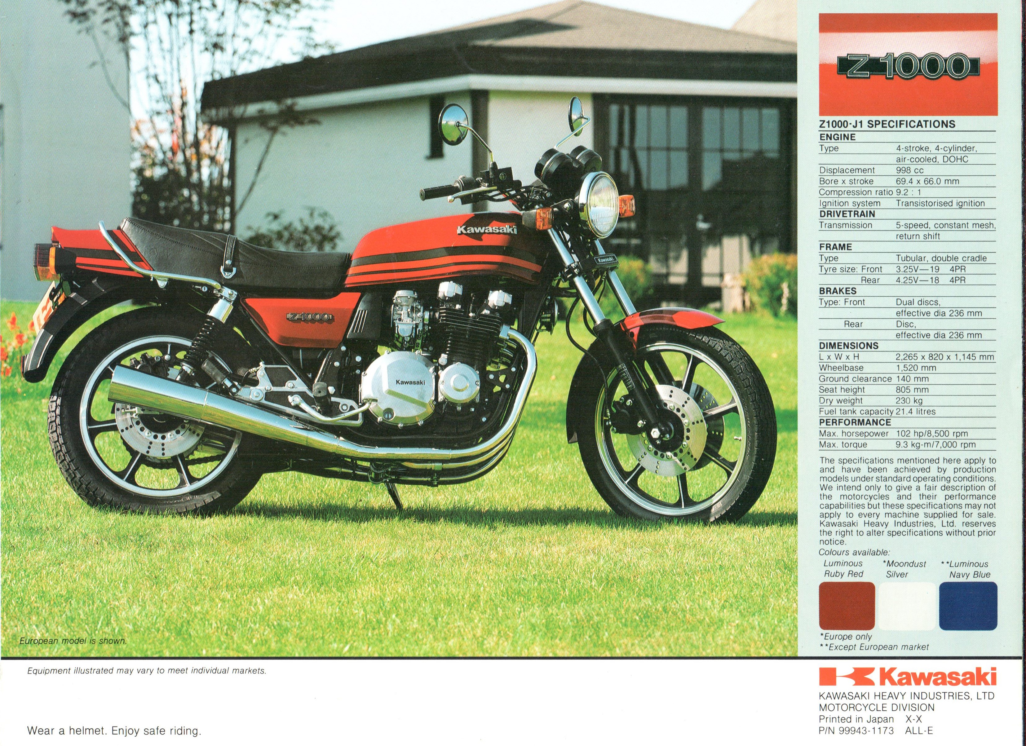

An interesting topic here.
When I bought my untouched J I maxed it out on a downhill stretch of road local to me. I just worked out that on the standard gearing at 135 mph I was pushing 8750rpm. I would say that the limit was the road condition, other traffic around, tyres and bravery.
Any engine will rev on beyond max power, which in this case is at 8500 with max torque at 7000.
The issue with an non-welded crank is that in the event of a missed gear it can whip round alarmingly and twist the crank.
Without a welded crank it is best to not miss a gear.
