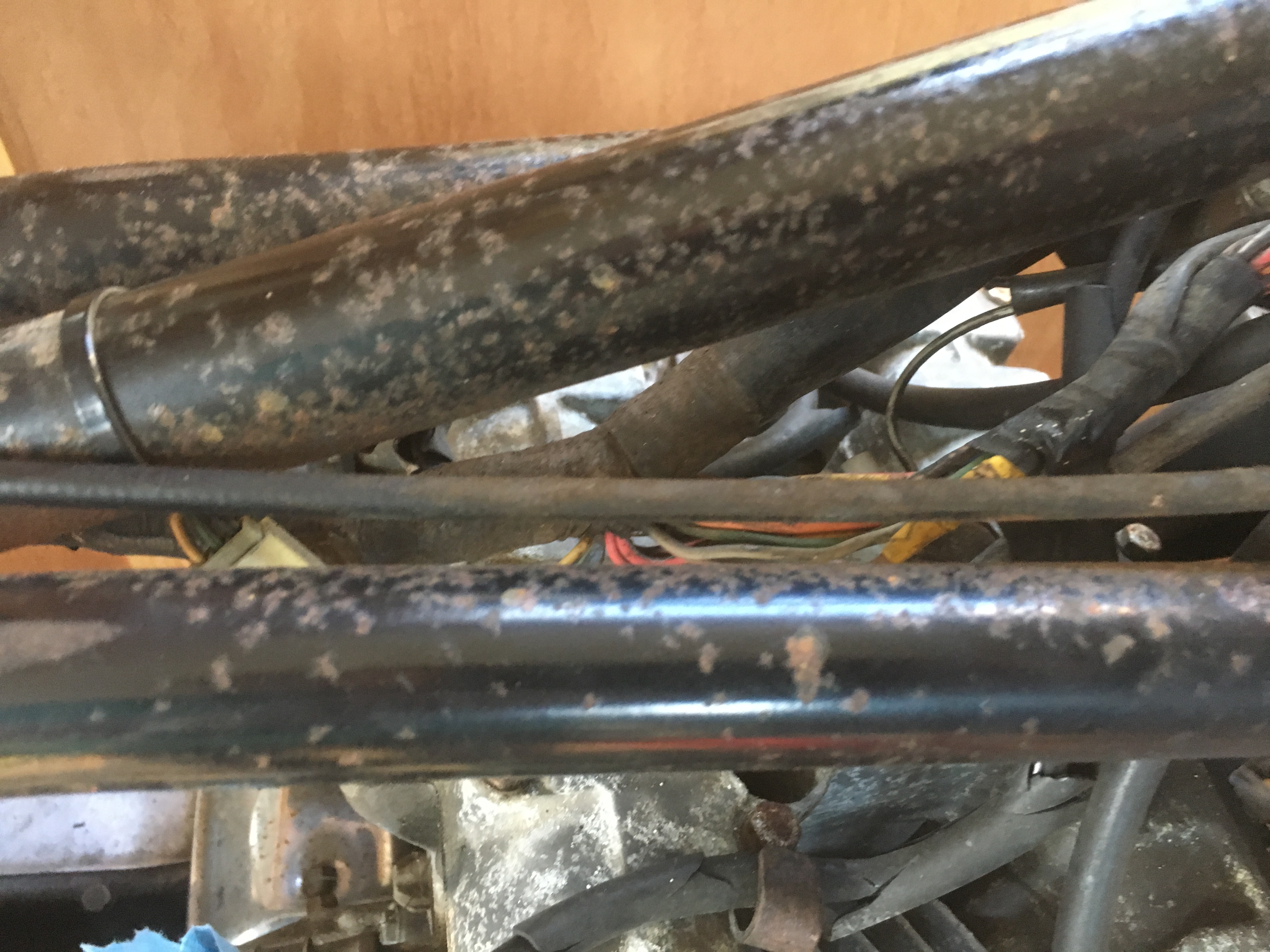

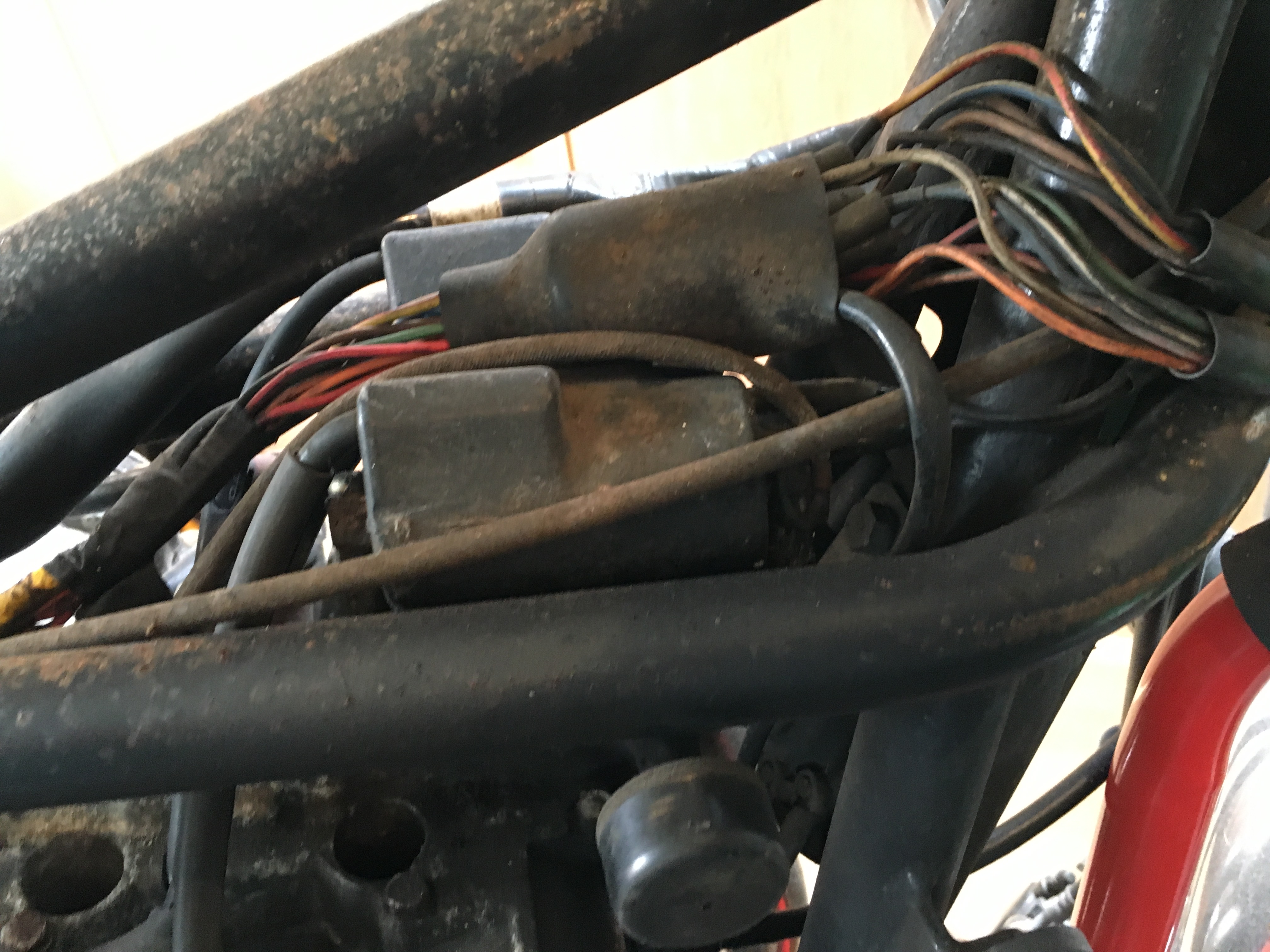

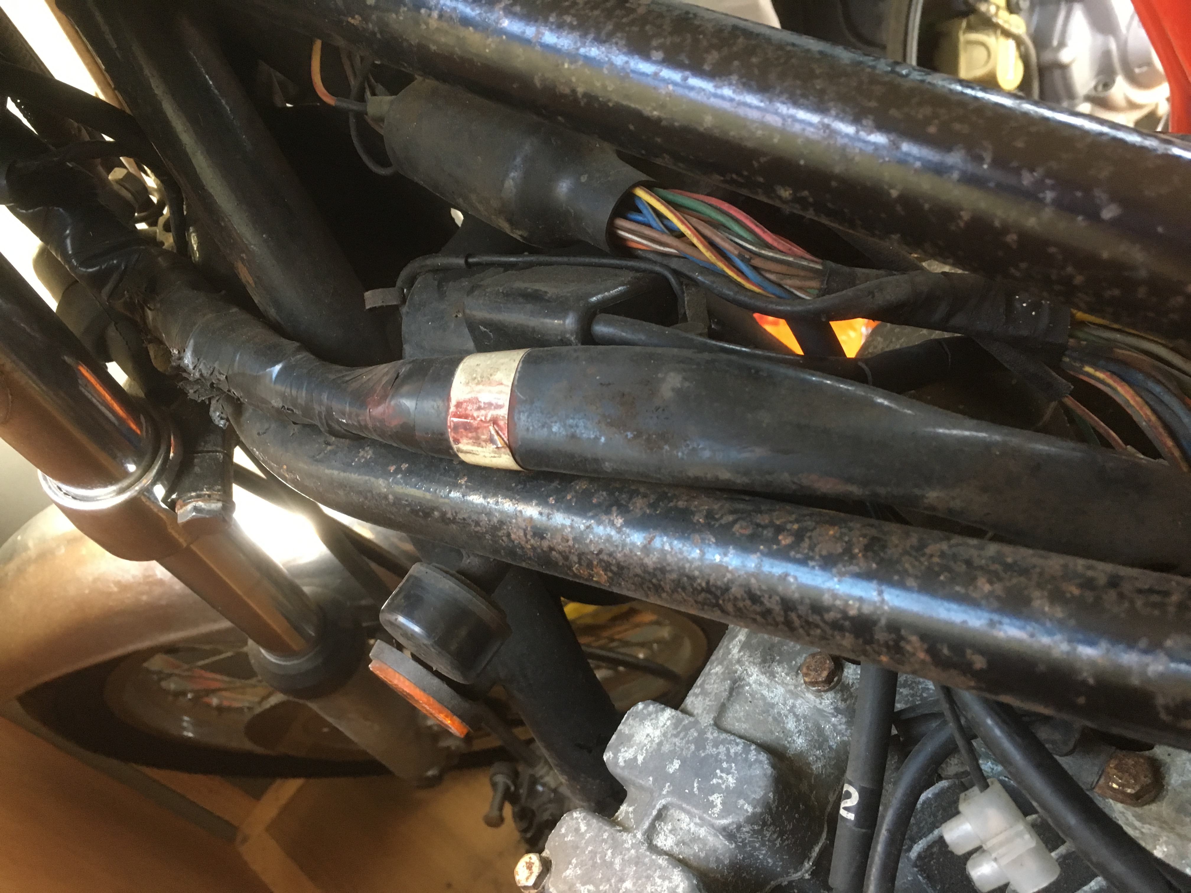

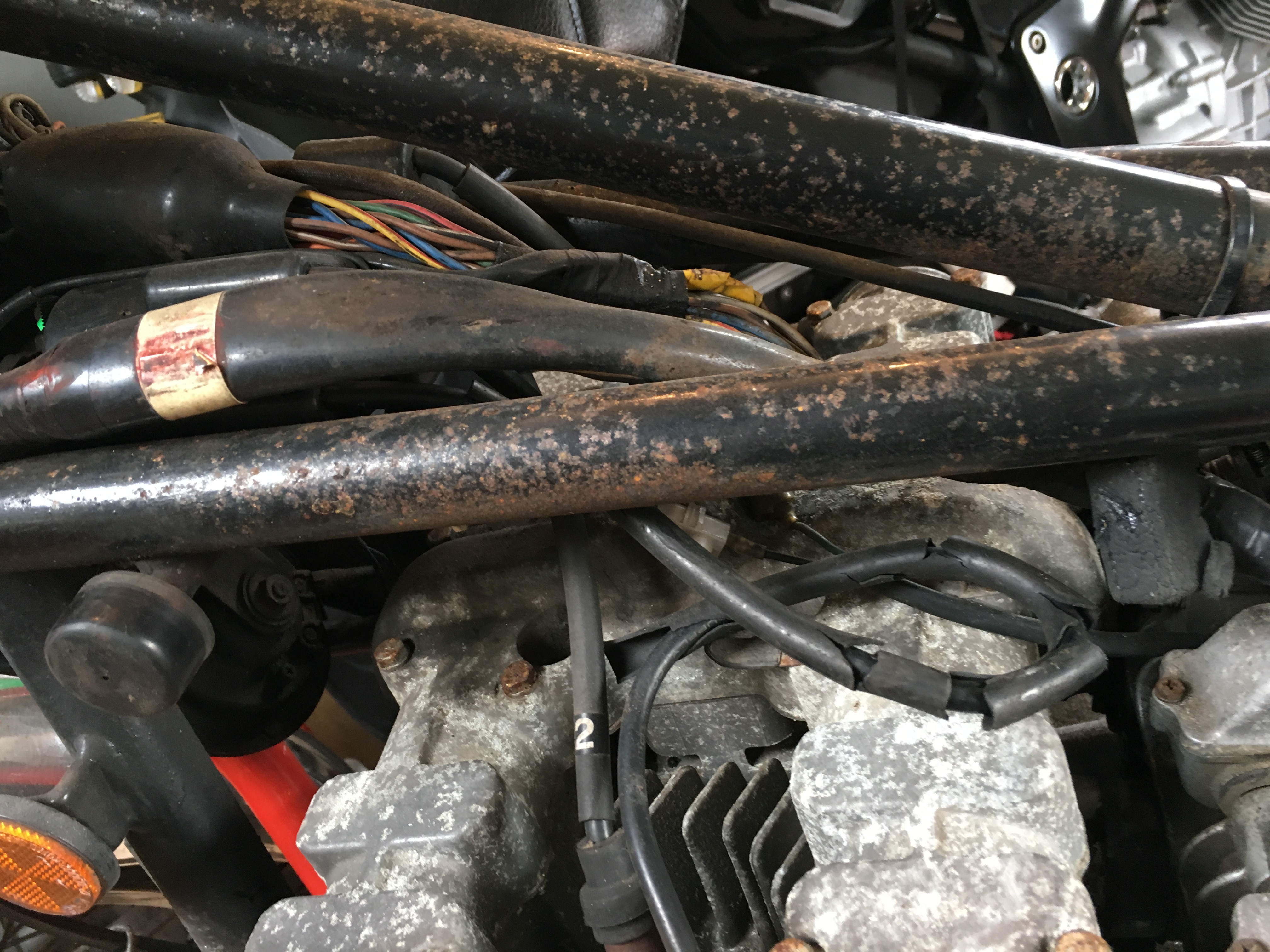

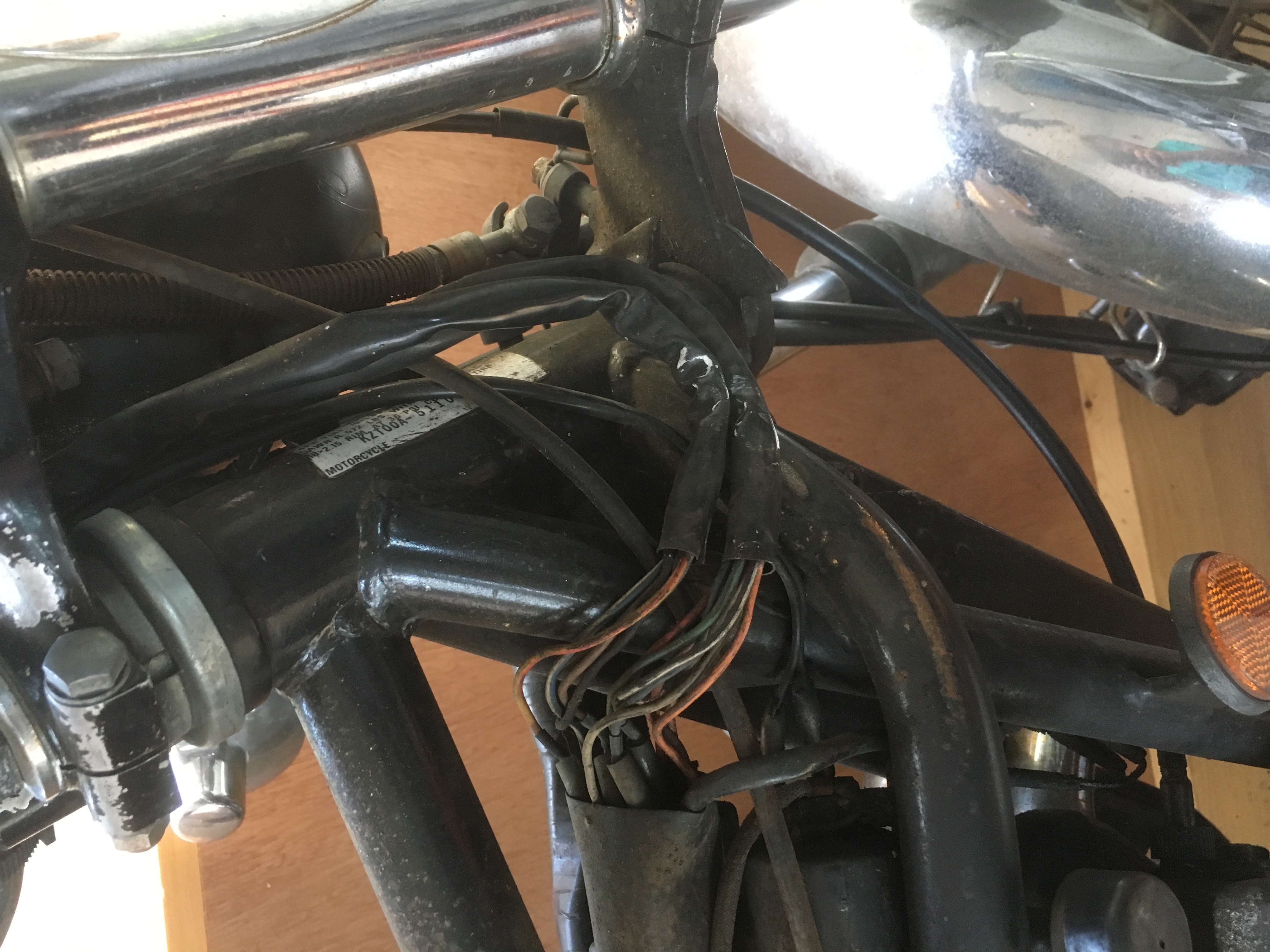

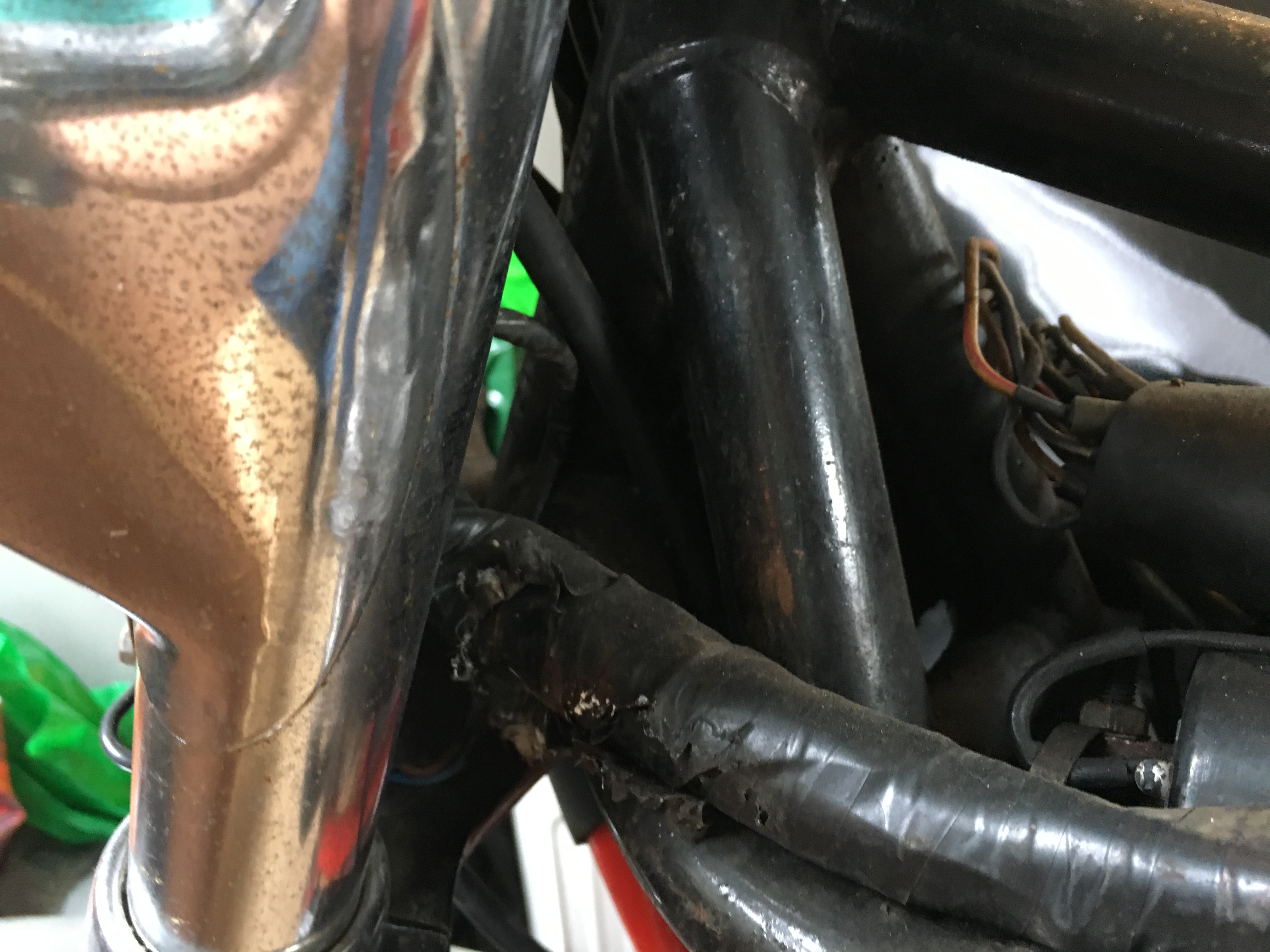

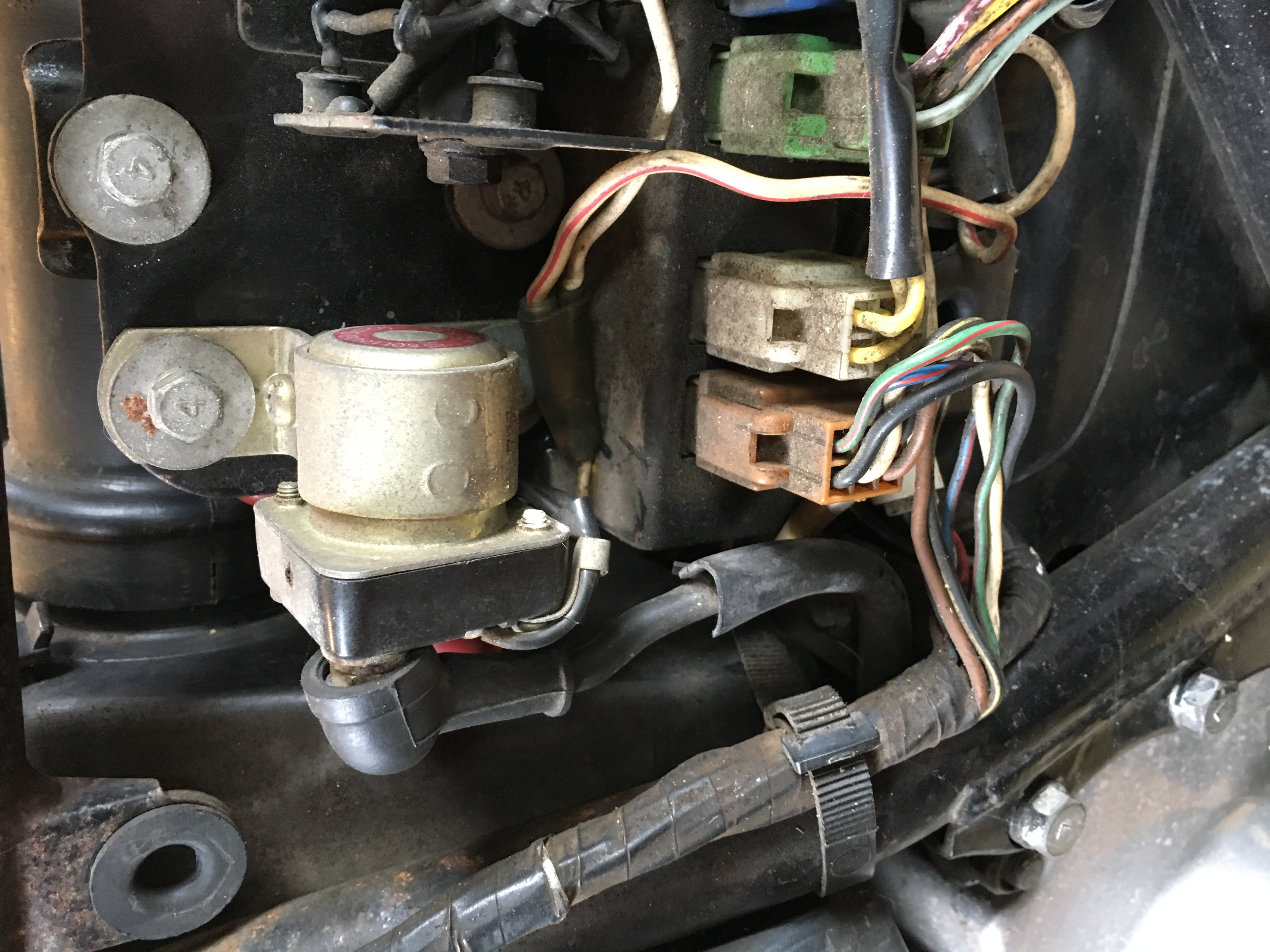

Hi - I am just starting the "pull apart" phase of a z1000 a2 refurb. All the sidepanels / tank / tail is off and the carbs pulled. It seems to be all the original loom and electrics. I probably have reasonable views of everything - let me know what you need and I'll photograph when I'm next in the shed.

That's fantastic thanks Graham - I just need to see where the deviates under or over the frame. Routing under the tank and up through the headstock.

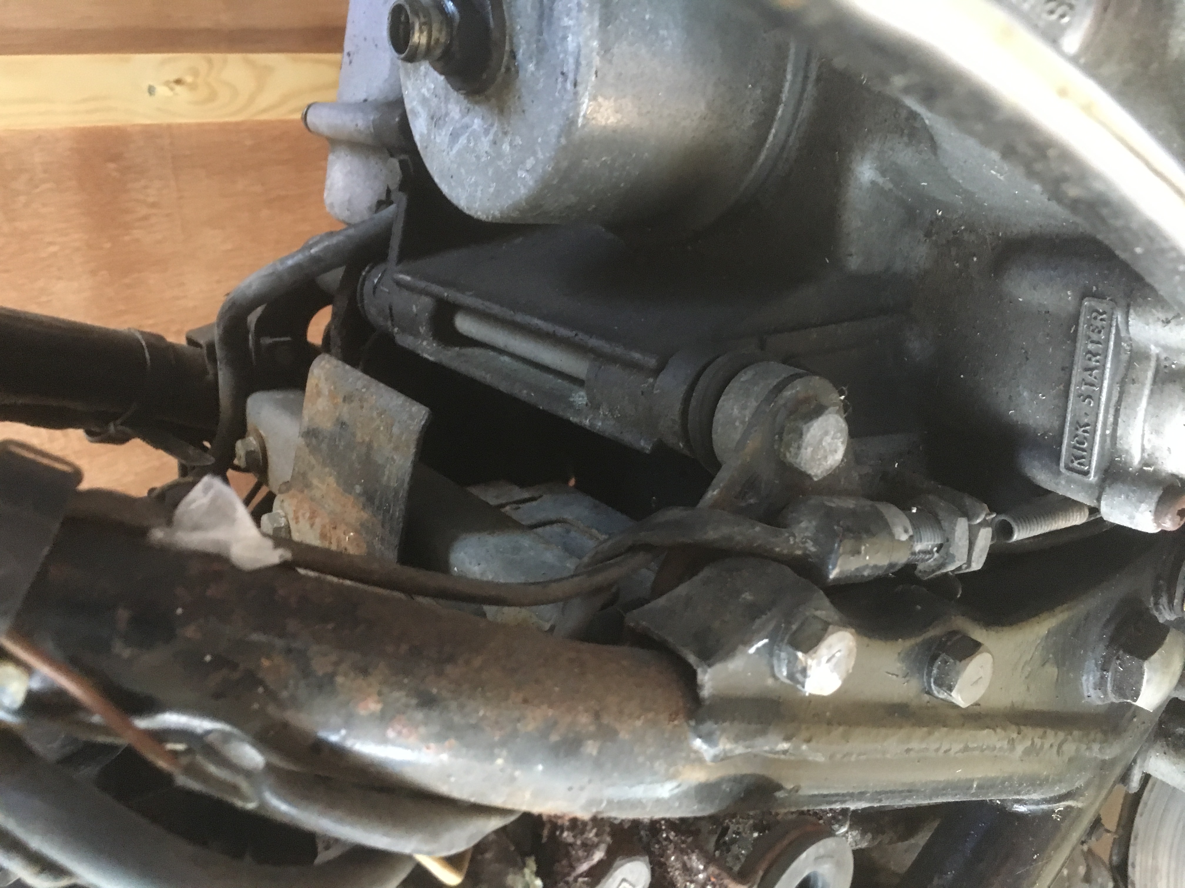

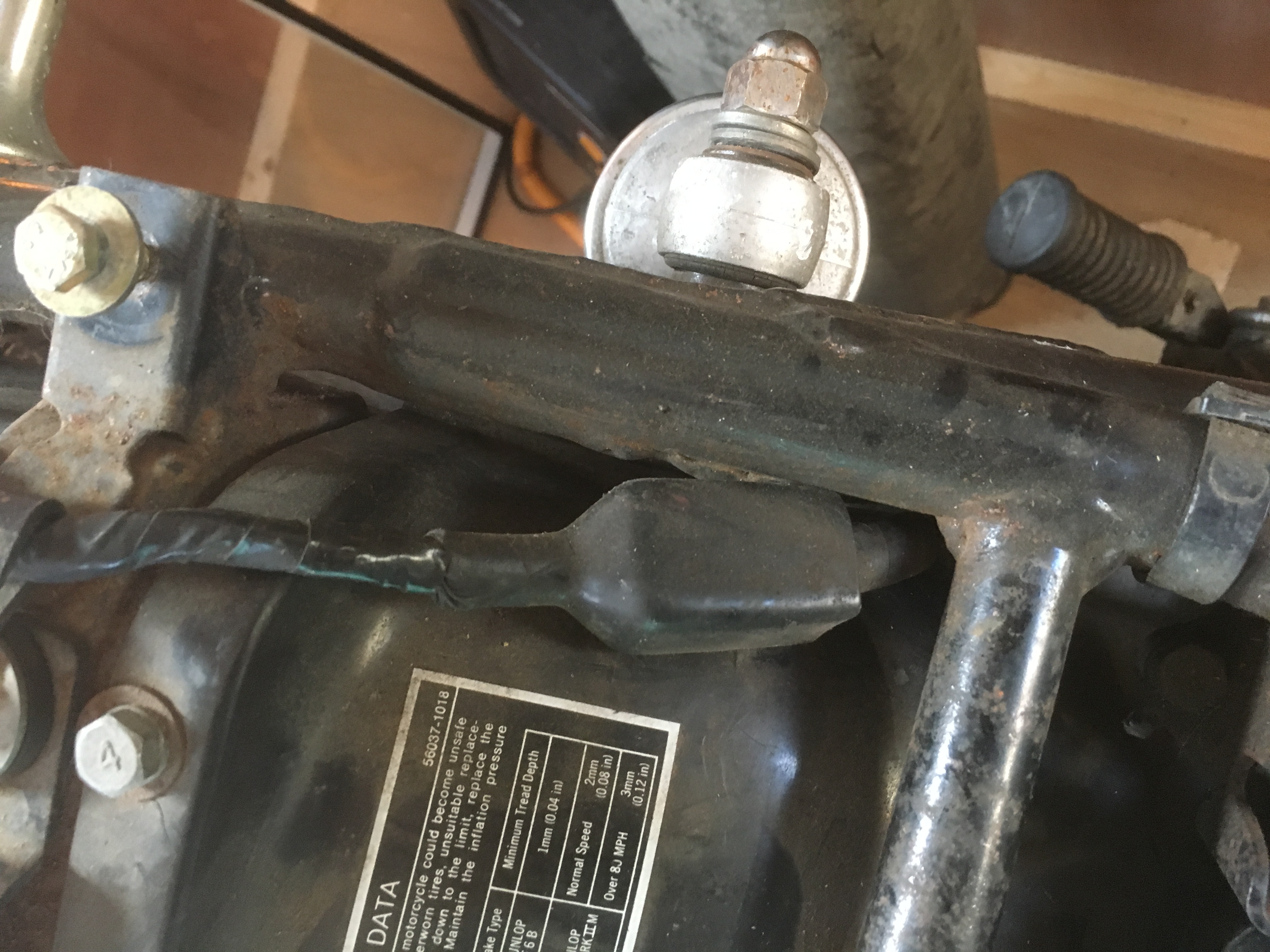

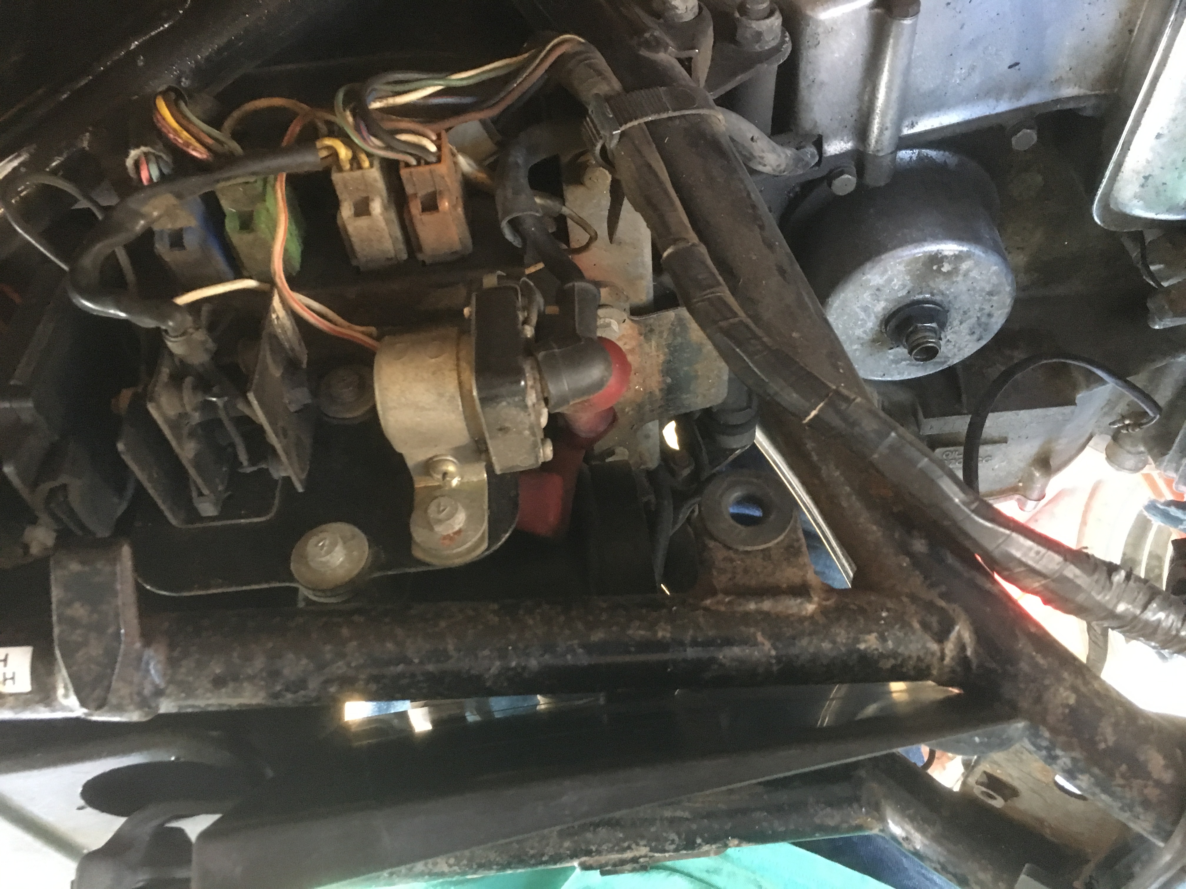

Re: 1978 Z1000a1 Wiring Harness Routing
#11 PostAuthor: Graham-A2 » Tue Sep 12, 2017 12:59 pm
Some of the pictures I took on Sunday - not especially for the wiring will take some more in a day or two....
Present
Red '78 KZ - rebuilt from engine up
Other wheels - Couple of old Guzzi's
Past 1994 - 2010
Luminous Green '78 KZ import [BLE 656S]
Graham-A2
Posts: 71
Joined: 4th Sep 2017
Location: Sussex

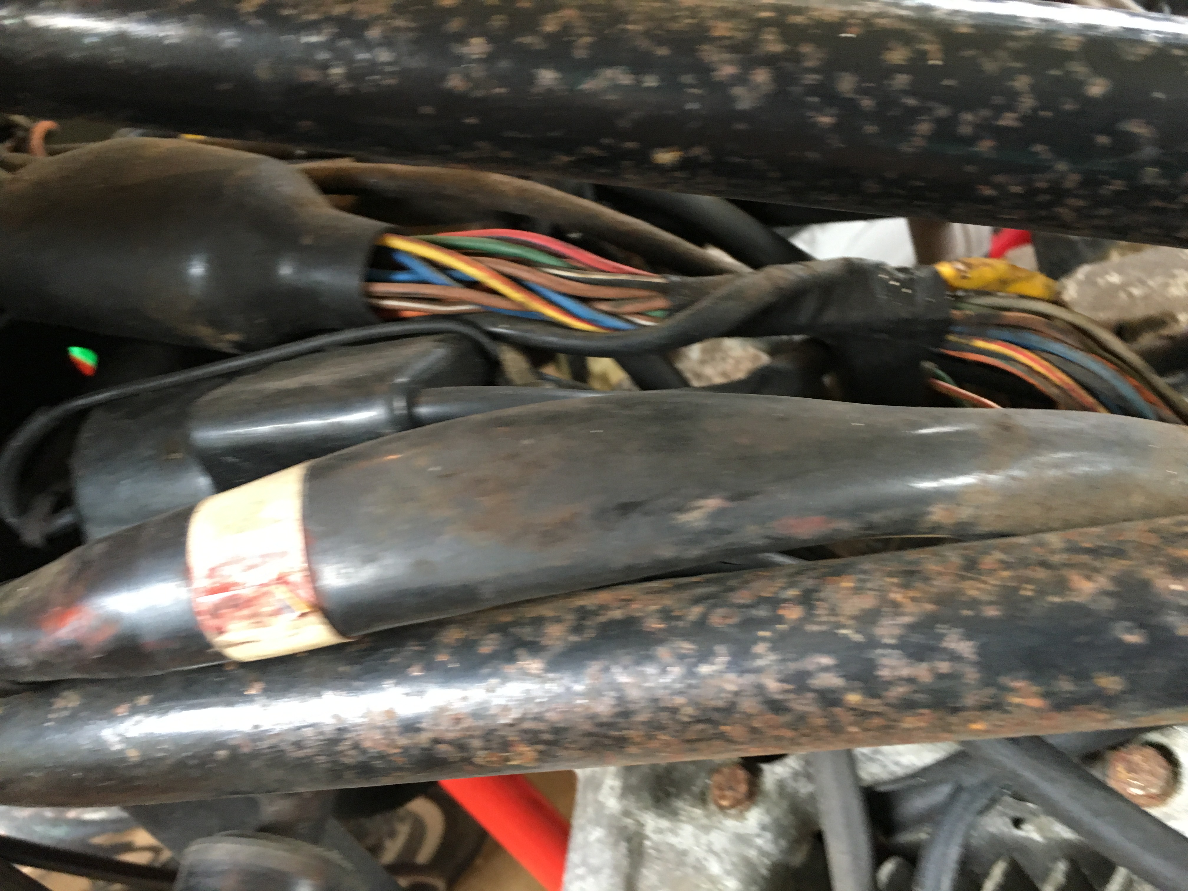

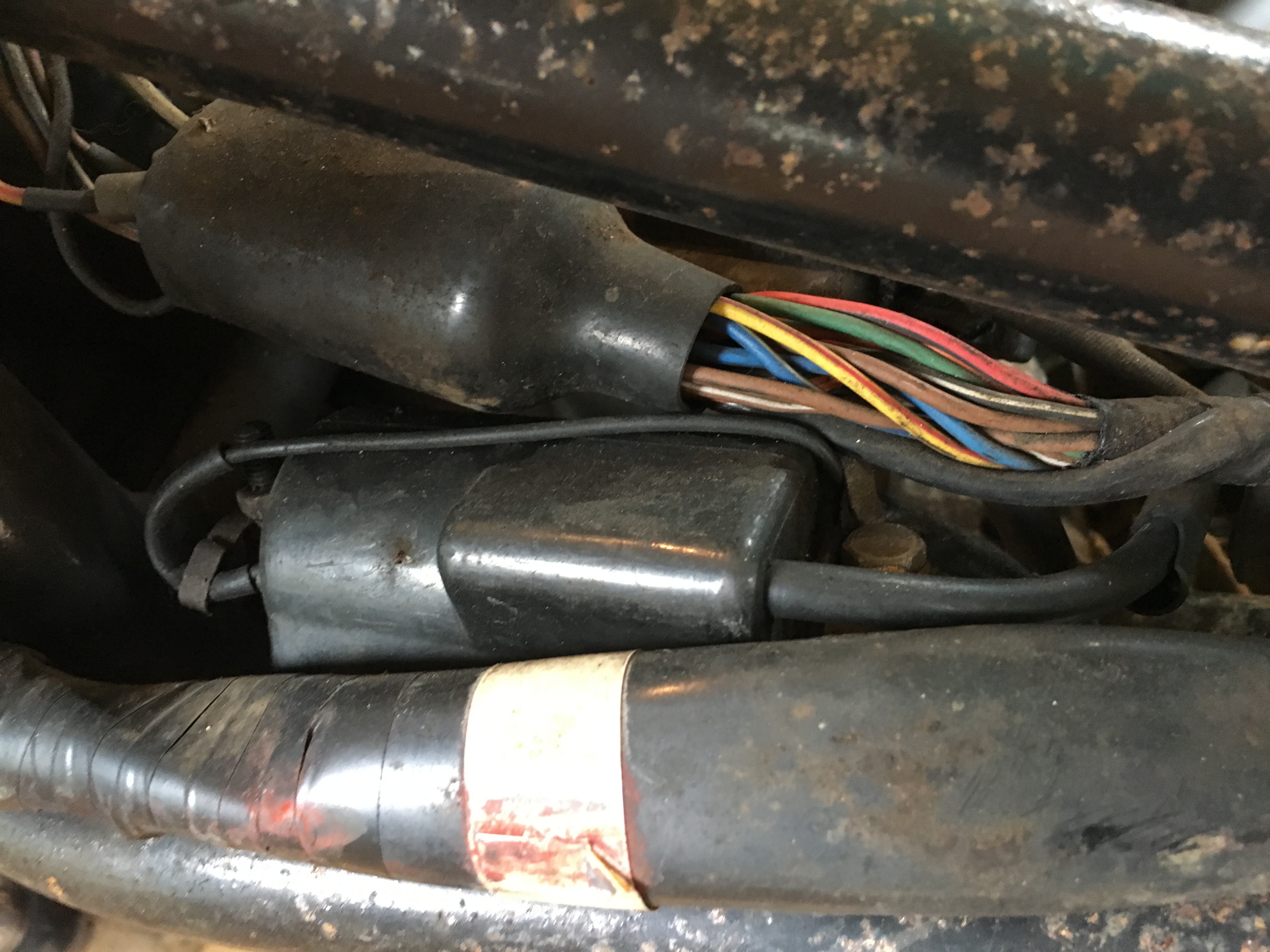

#12 PostAuthor: Graham-A2 » Sat Sep 16, 2017 7:15 pm
Hi again - sorry for the delay, first time back in the shed this week. So - had a good look at where the loom goes and took the following picks which seemed to be the main parts you might be interested in. Hope it helps

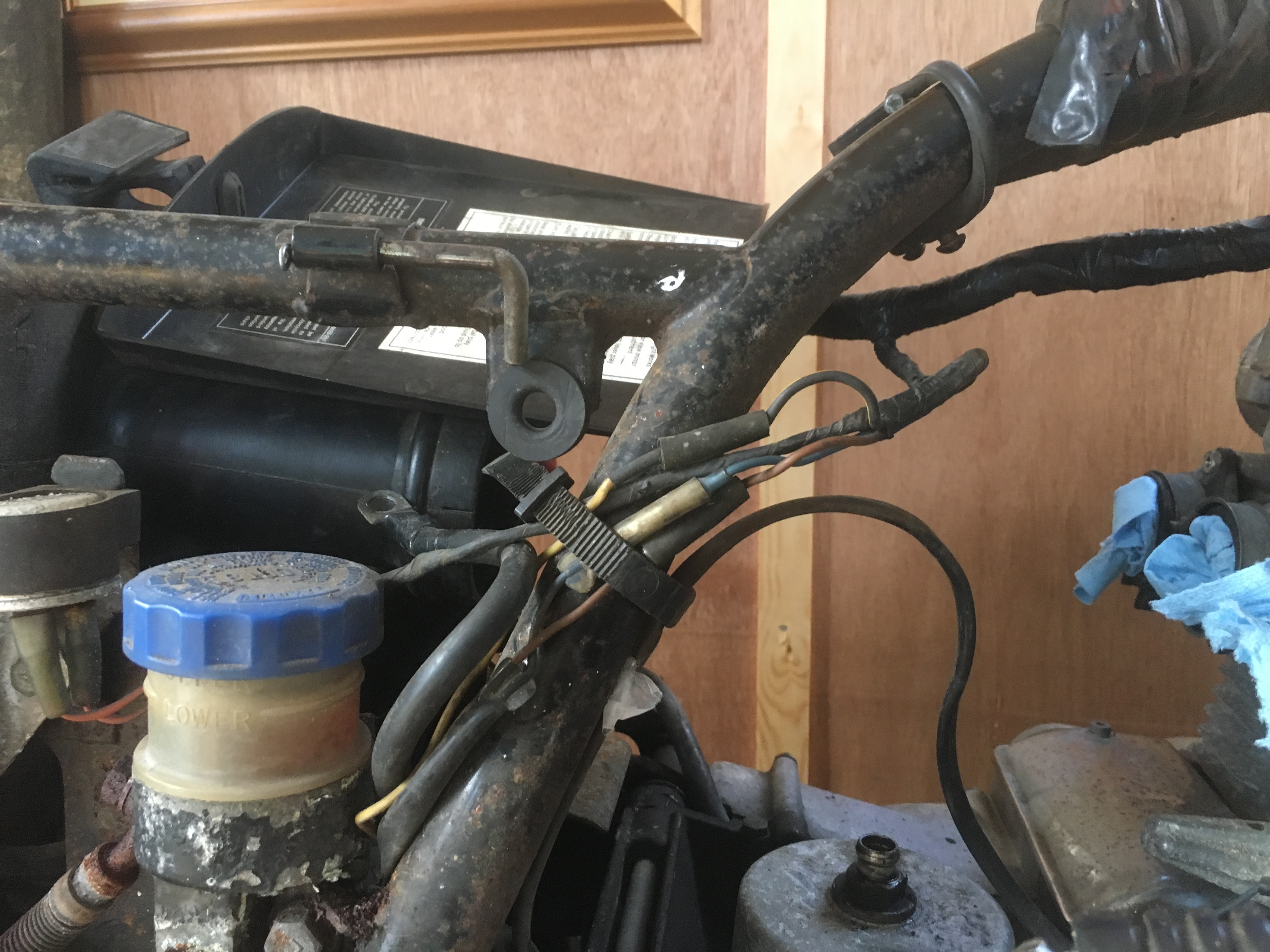

#13 PostAuthor: Graham-A2 » Sat Sep 16, 2017 7:18 pm
Oh dammit - missed one ! :biggrin

#14 PostAuthor: csx355 » Sat Sep 23, 2017 7:15 pm
Graham you are a total star - apologies for the delay in thanking you but I'm currently surfing my titz off if France. I know it's tough but someone has to do it! What you have posted will save me hours of messing about. Many thanks. Steve
