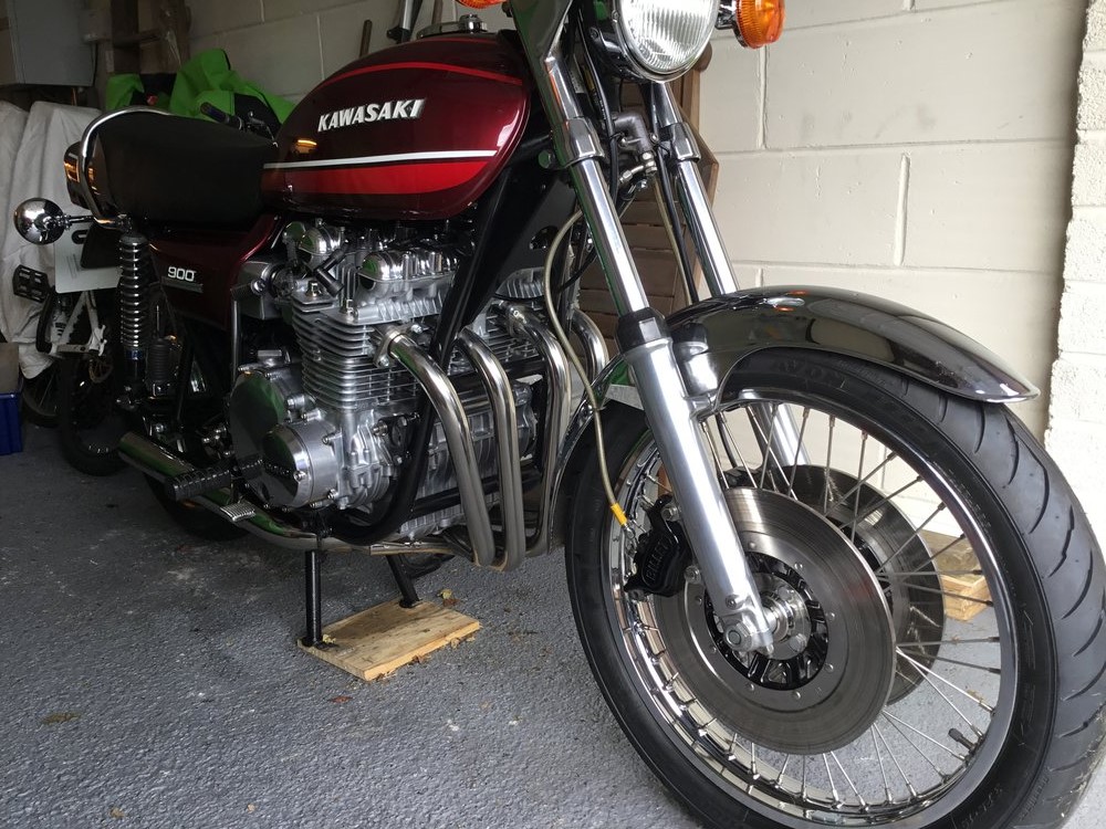

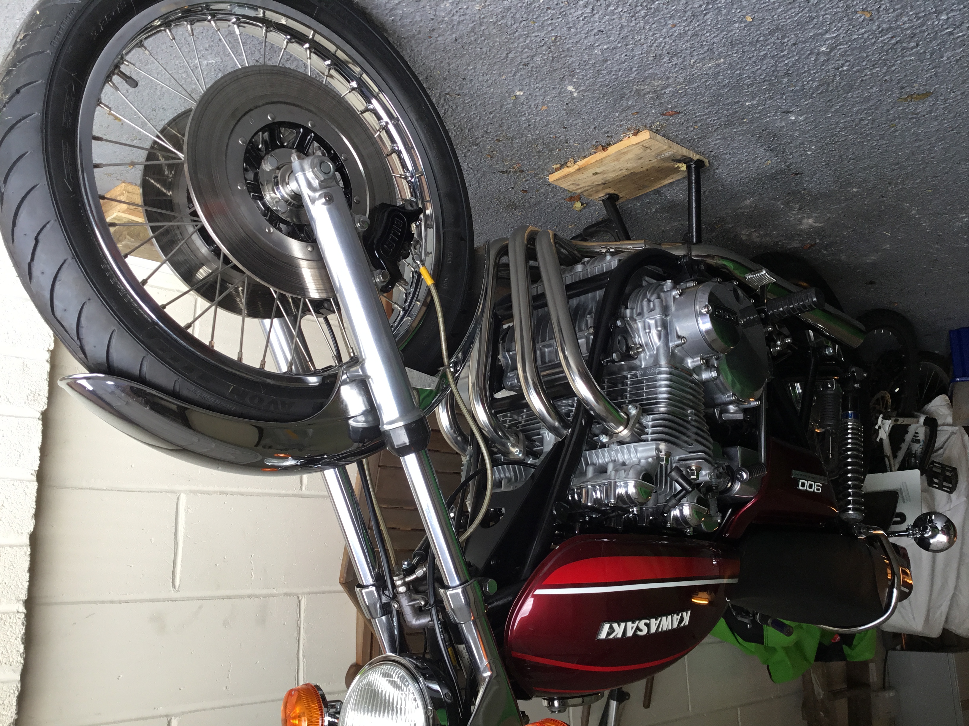

After 5 months of cussing here’s where I’m at, with thanks to you guys for guiding me along and tolerating my steady stream of numpty questions.

Re: Prep for 1st start for 5 months
looks better the rite way up
