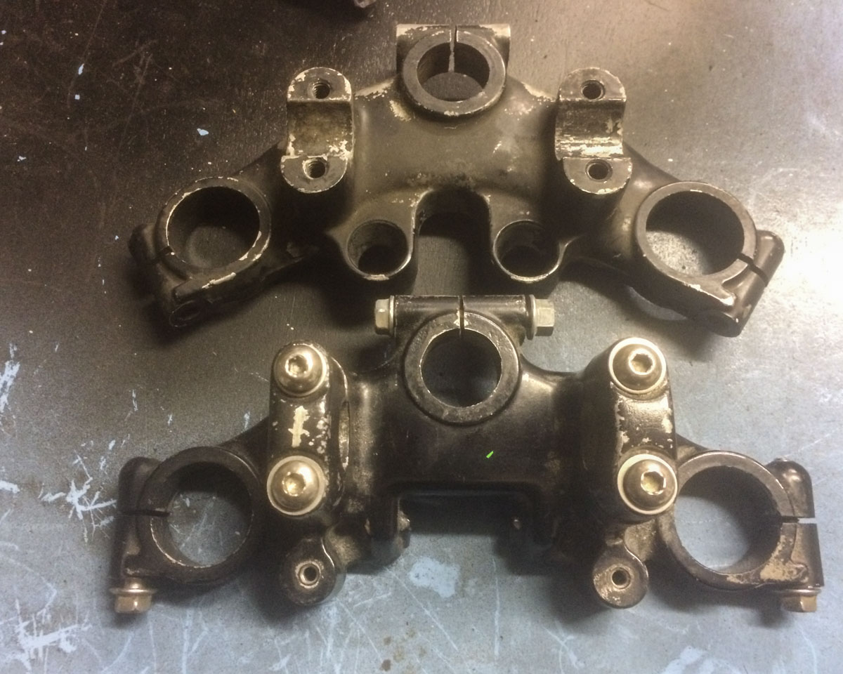

Good Morning
Could someone tell me the difference between Z1b and A4 top yokes please
I'm looking for a set and don't want to get it wrong

Chrisw1, there is a difference, although the geometry is the same...
It requires a different mount for the speedo & tacho and instrument lights.
Better off waiting for a Z1, Z1a or Z1b to come up on fleaBay.

I think this is them, Z1000 yoke at the back early yoke at front. Someone please confirm. If this is the case I would sell the early yoke.

That's very helpful .id be interested in the early yoke

I've been comparing this with a yoke actually on a Z1B, this front one is“some““what different - the bottom mounting for the clocks looks similar but the Z1B doesn't have the top holes in from of the handlebar clamps, and the stanchion clamp bolts are at a different angle, not “quite so straight. The rest of the geometry stuff matches up so it's like some kind of Zed yoke -has anyone any idea what this front yoke is off?

just guessing but is it from a 'J''
