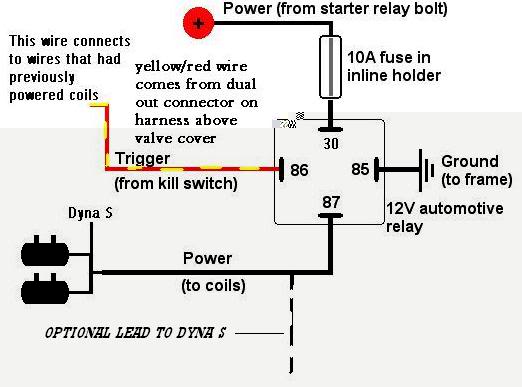

Do the wired george ignition mod first. Cost about a fiver and improves standard coil output loads. Easier starting, better idleing and running. Also use denso plugs rather than ngk. Much less hassle.

Re: Ignition Leads
wiring diagram for coil mod
