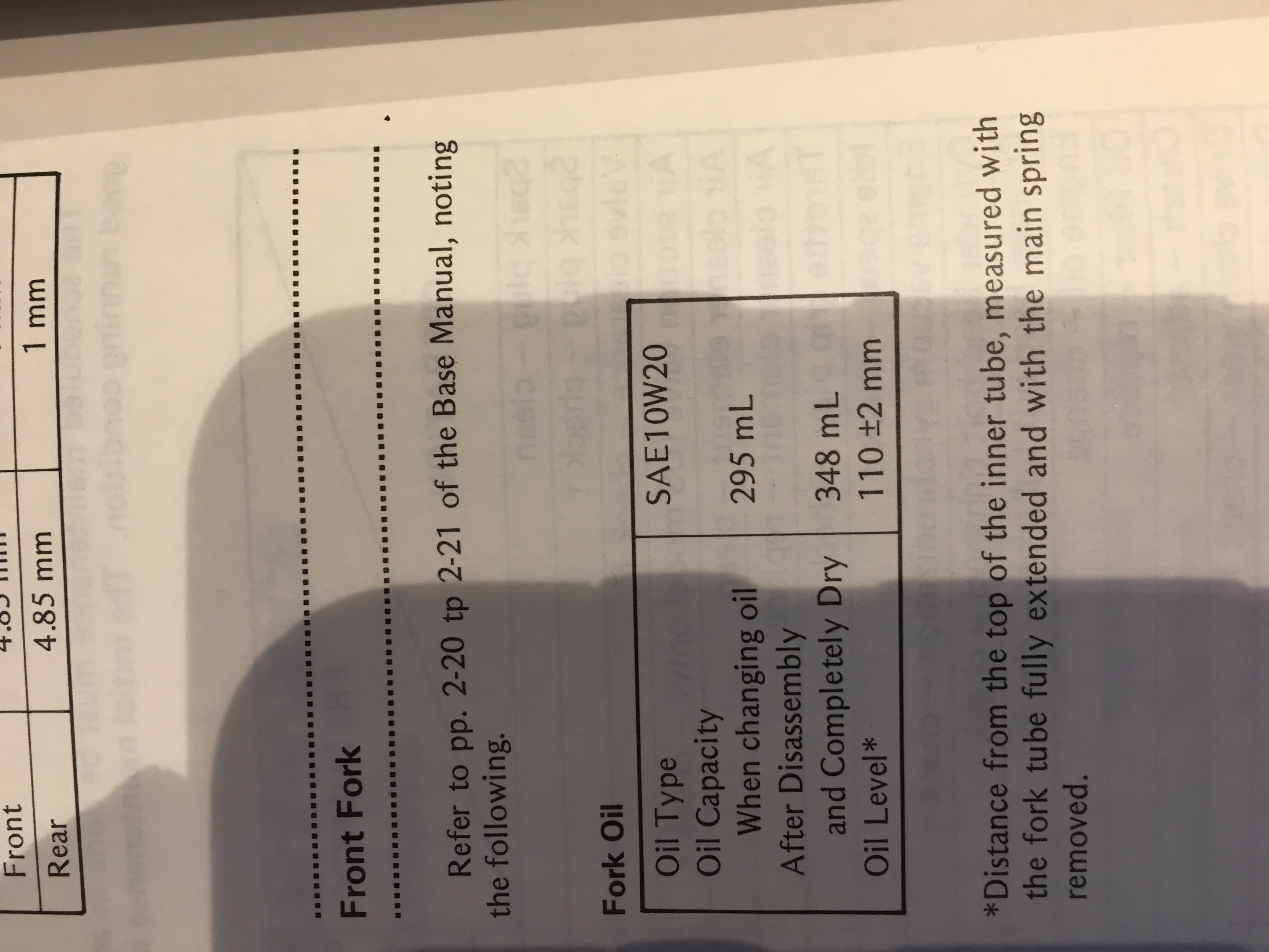

Experts. Can anyone confirm correct specifications and set up for standard front forks of a 1983 Z1000R. The factory workshop manual is, i believe, incorrect as it gives suspension travel as 180mm. Your average trail bike doesn't have that level of travel!
Need correct data on:
Fork total suspension travel
Oil weight, amount and air gap
Many thanks

from the supplement kz/z1100r1 manual,
oil type 10w20
capacity when changing 295ml
after dissassembly 348ml
oil level from fork leg top fully extended and no spring 110+/-2mm
fork spring free length 522.5mm service limit 512mm
