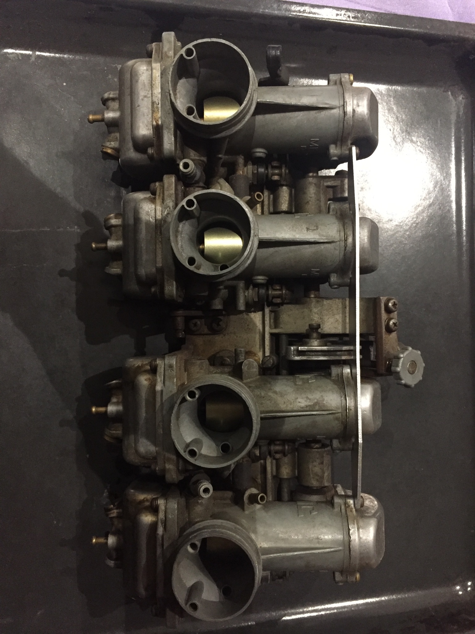

Has anyone here done a complete refurb on their carbs inc plating the plated parts etc ? Any pics ?/

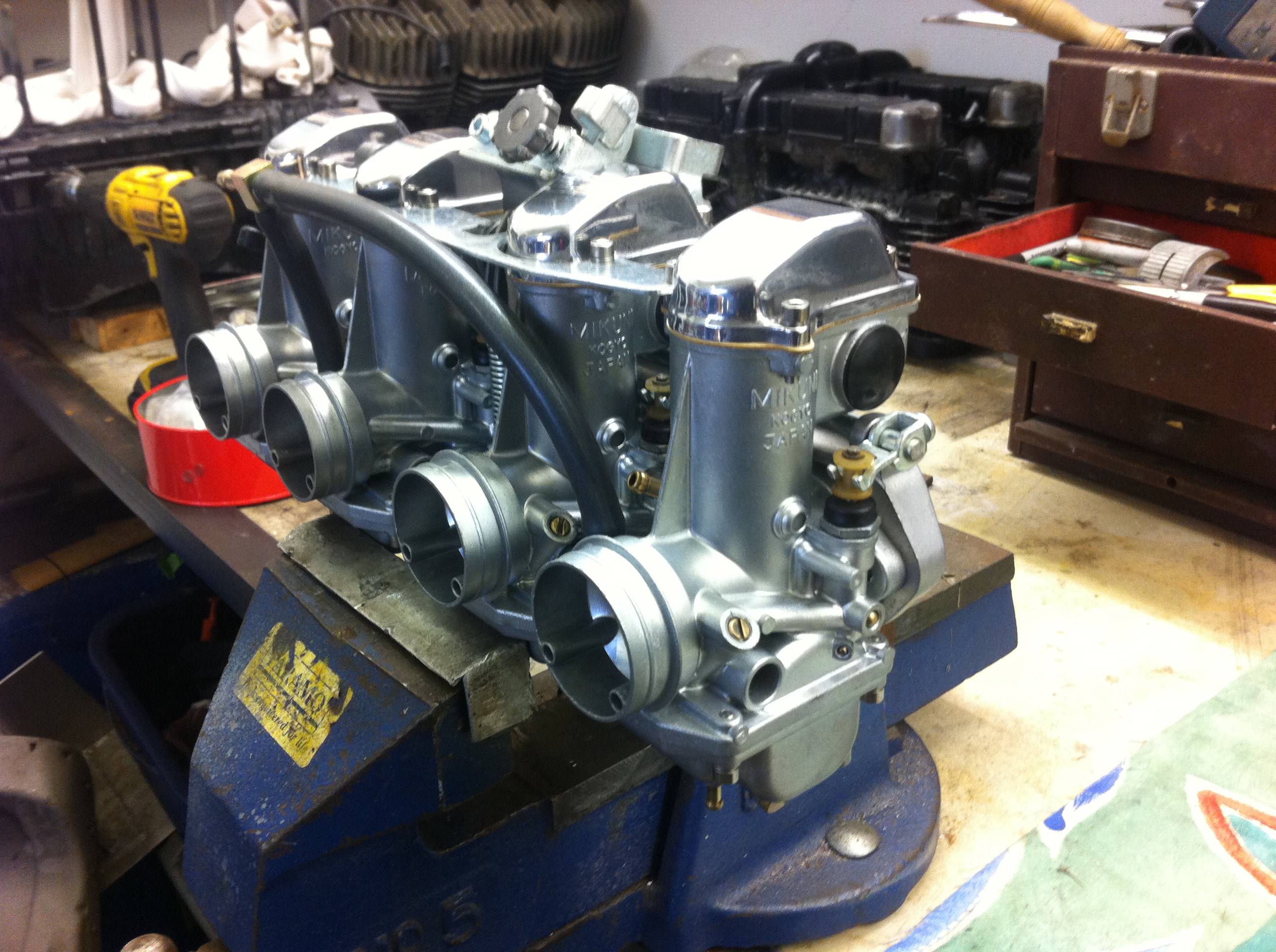

Done a few sets meself,ultrasonic cleaner,all new bits and a local friendly plater(who doesnt loose too many bits)plus patience...viewtopic.php?f=7&t=39637&p=343554#p343554
Did these meself...

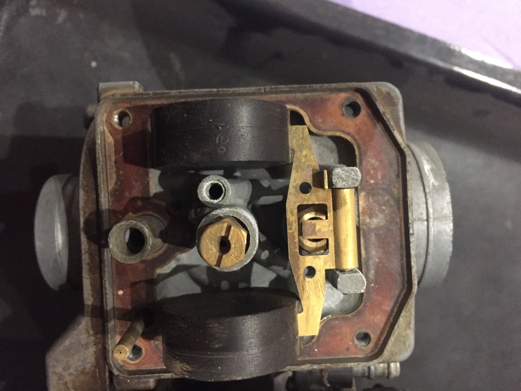

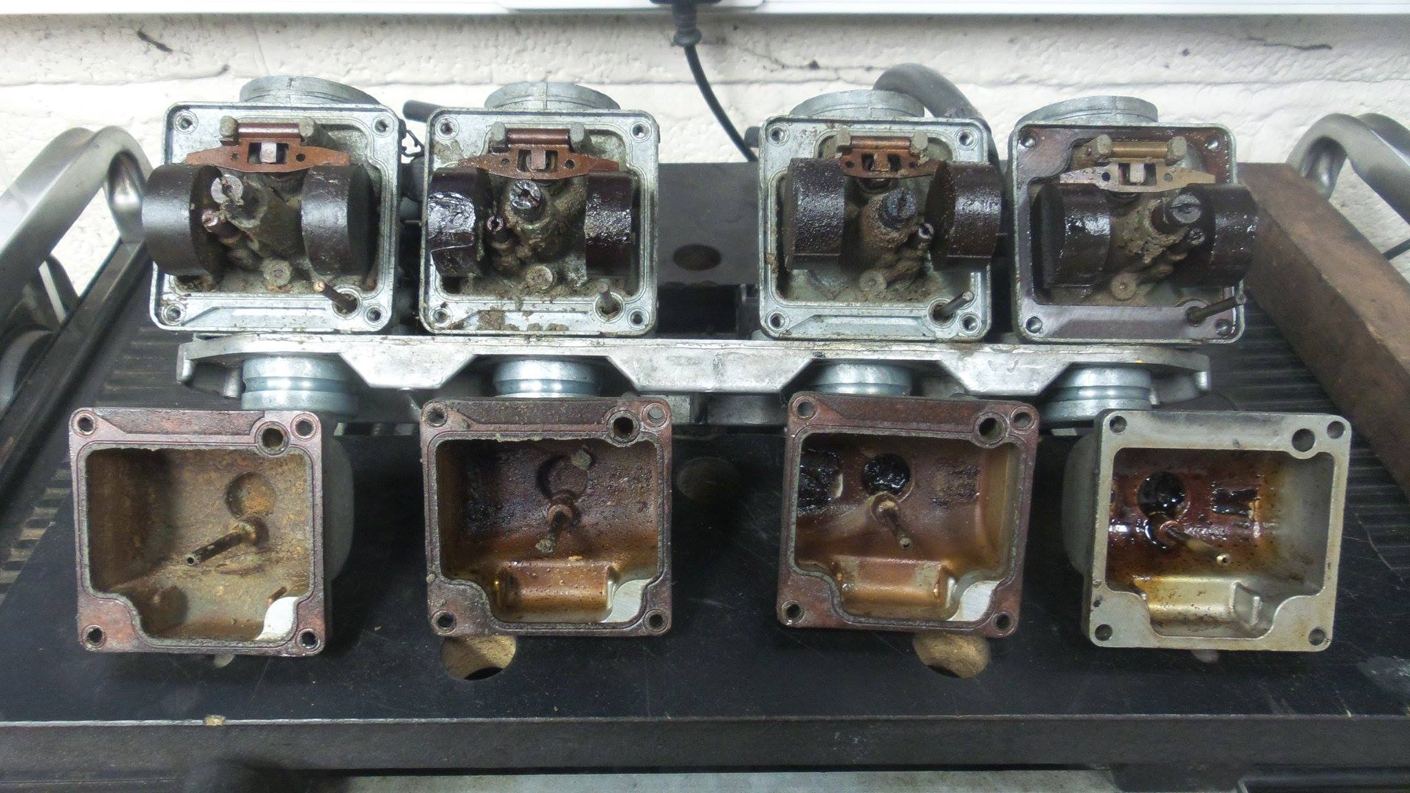

Did my z900 ones a while back and a set of z1000 ones recently. Ultrasonic cleaner, no replating.
Before:
After:

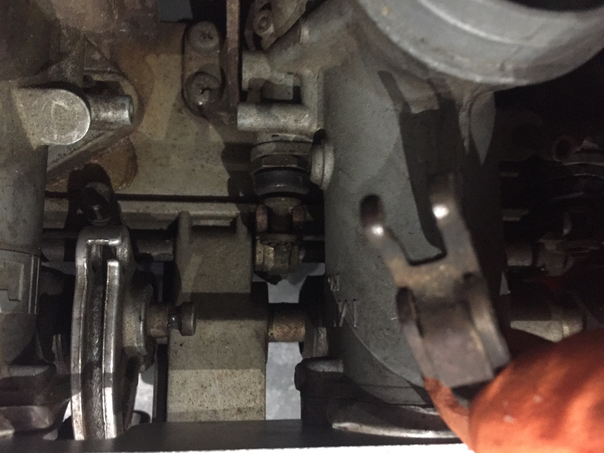

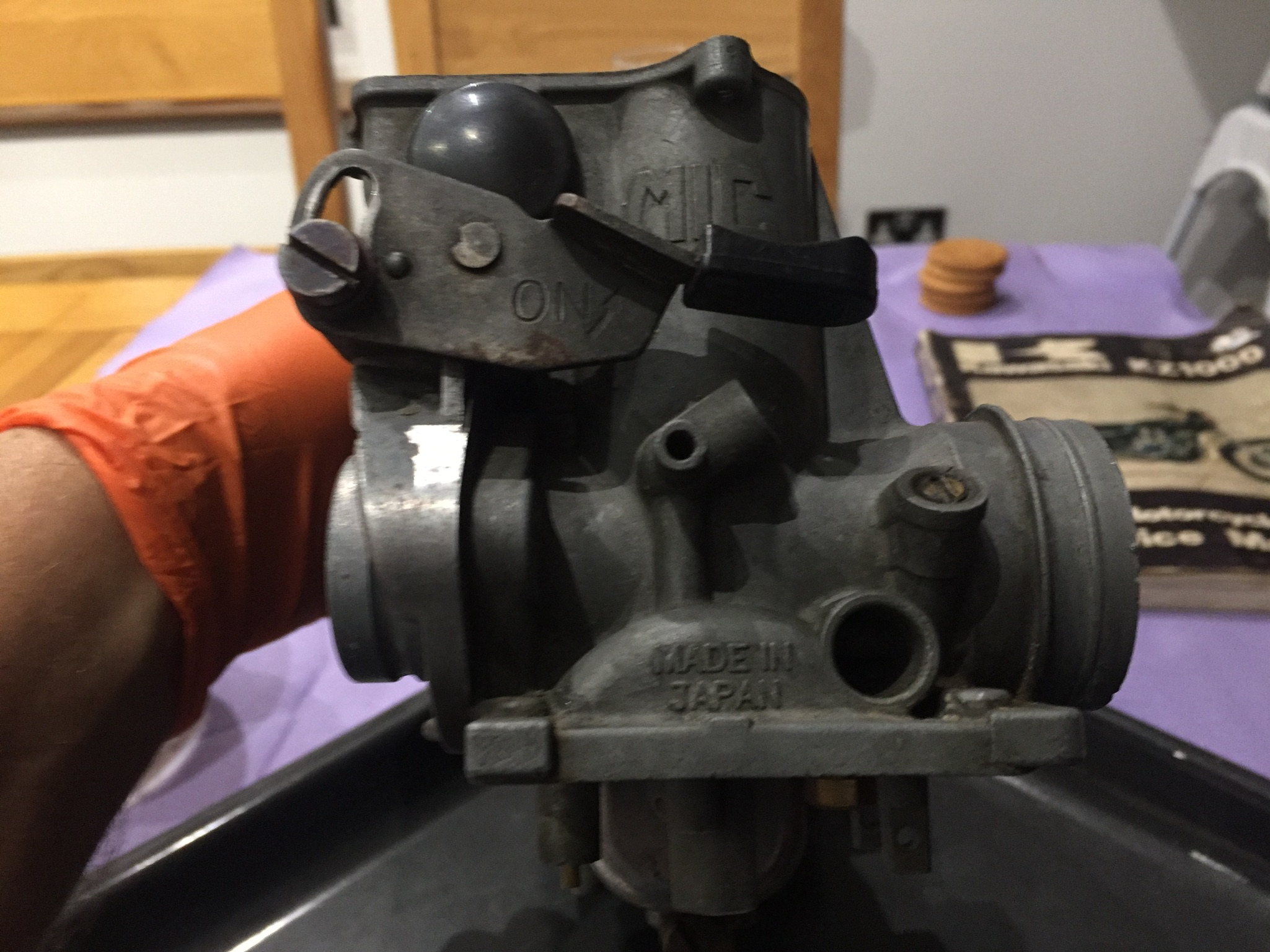

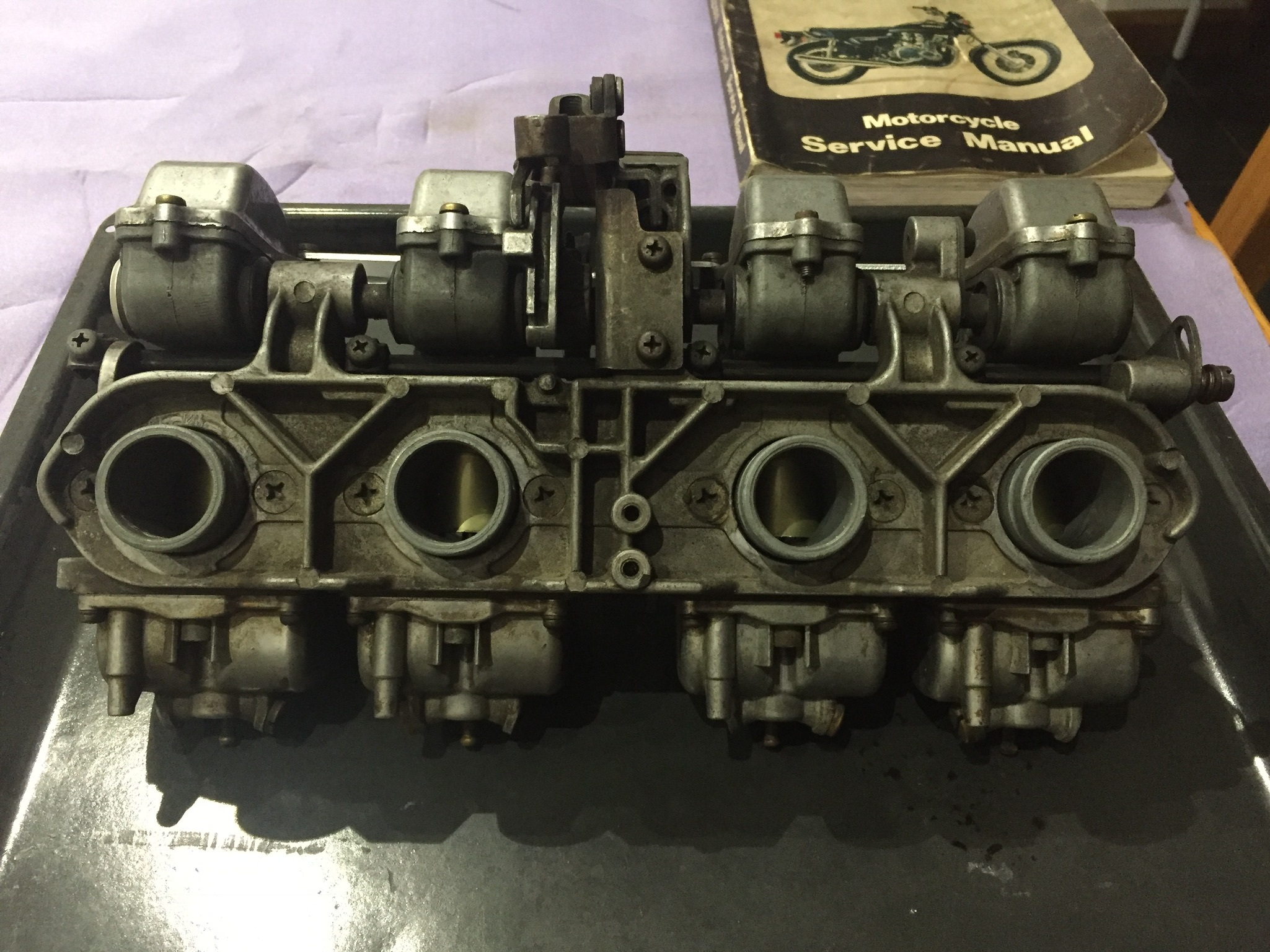

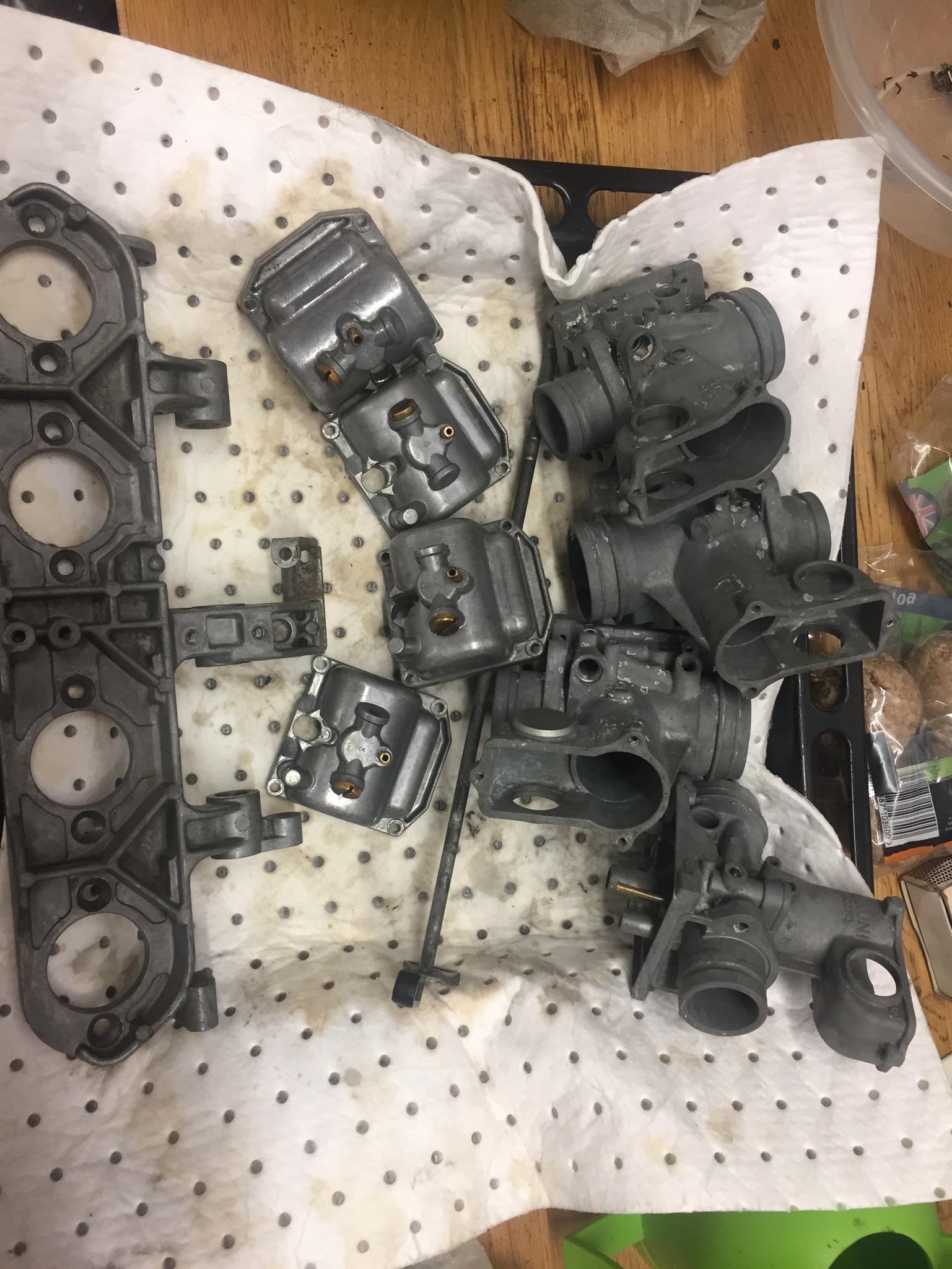

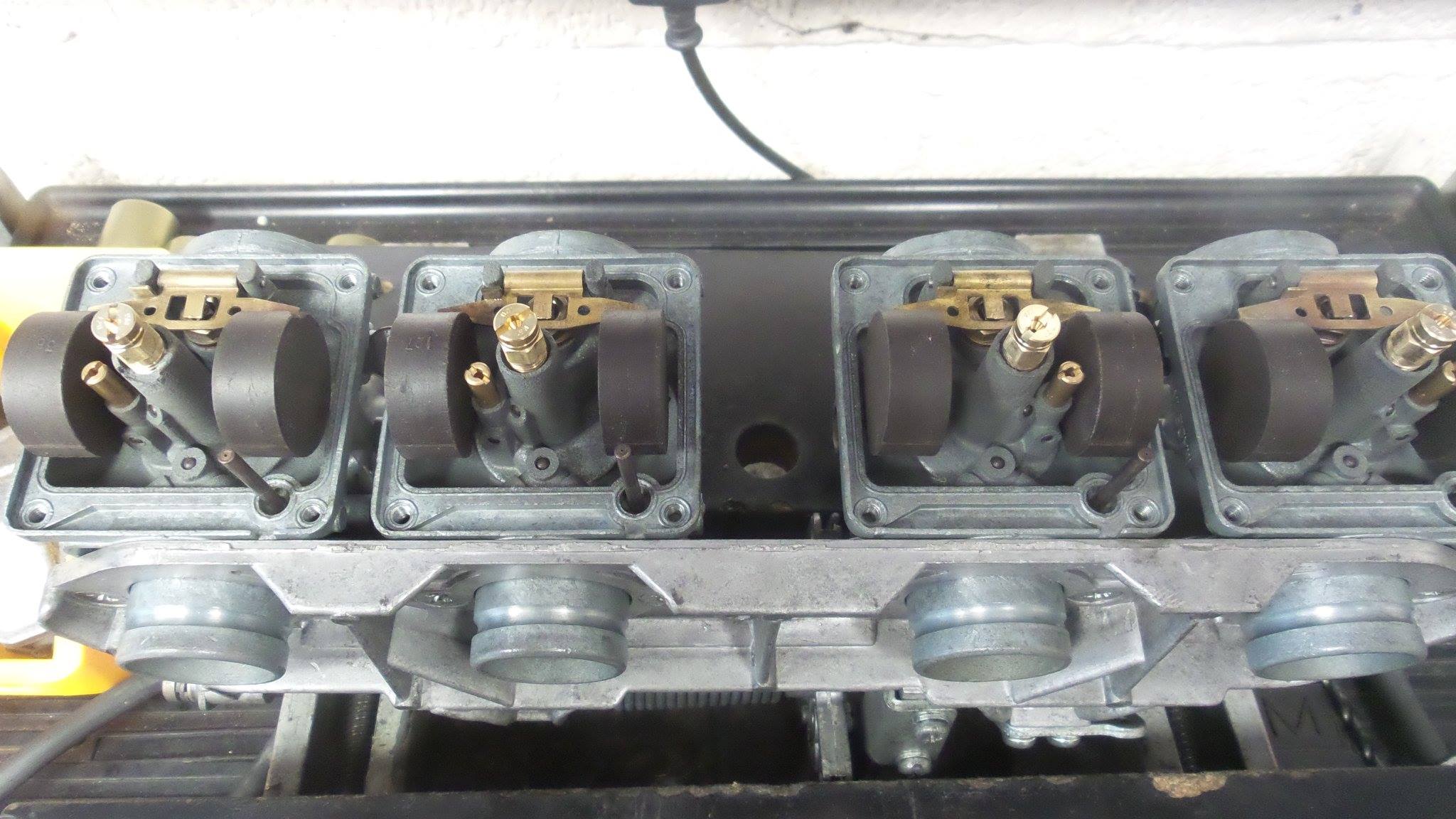

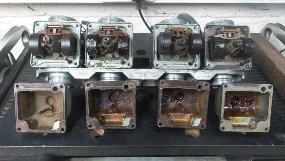

Just about to start mine - I had two sets of carbs with the box of bits formally known as a Z1000. A 26mm set and a 28mm set. I stripped the 26mm set last night and soaked them today in a Rozone cleaning bath. I just wanted to get the grease and grime off prior to going in my Ultra sonic bath. My intention is to plate and polish as much as I can myself. I have a basic homebrew plating bath based on the Gateros set with some mods.
Sorry the pics got out of sync a bit. They cleaned up really well - just started a little bit of oxidising.
I took the pics for my own reference really - this is the first time I have stripped a bank of four down.

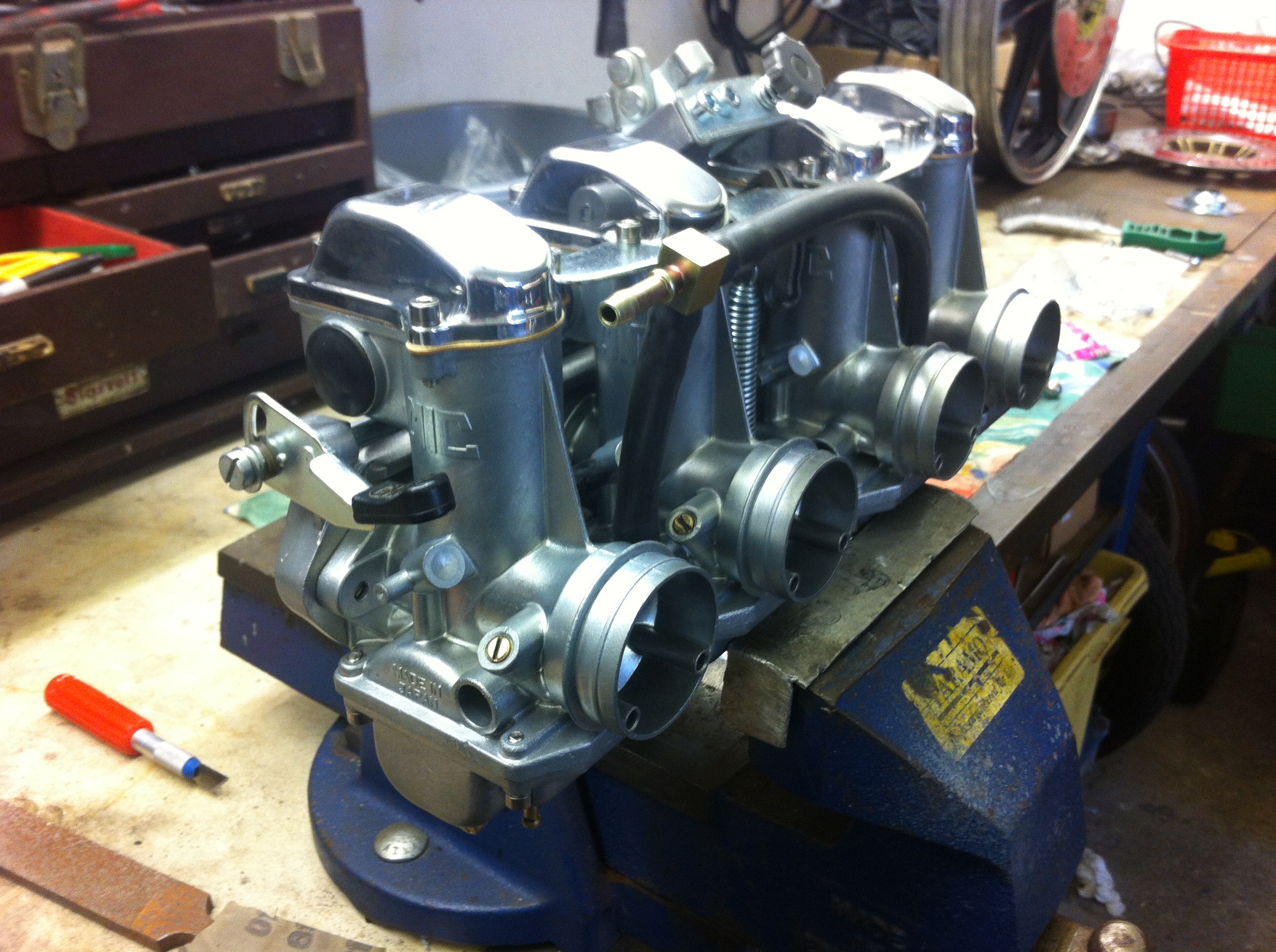

My brother just tarted up the ones on his 650...
Re: Carb refurbs.
#7 PostAuthor: Ultim8pc » Wed Nov 15, 2017 10:15 am
ooooo! Some fine looking carbs here!

#8 PostAuthor: kev edwards » Wed Nov 15, 2017 5:22 pm
Ultim8pc you have put the carbs back wrong the air screws are on the wrong sides of the carbs you need to swap the pairs around.
Re: Carb refurbs.
#9 PostAuthor: Ultim8pc » Wed Nov 15, 2017 9:05 pm
kev edwards wrote:Ultim8pc you have put the carbs back wrong the air screws are on the wrong sides of the carbs you need to swap the pairs around.
Oh yes, so I have....
:oops:
Oh well, I can fit some new fuel T-pieces while I'm at it, so it won't be a wasted effort...
Fanks a lot..

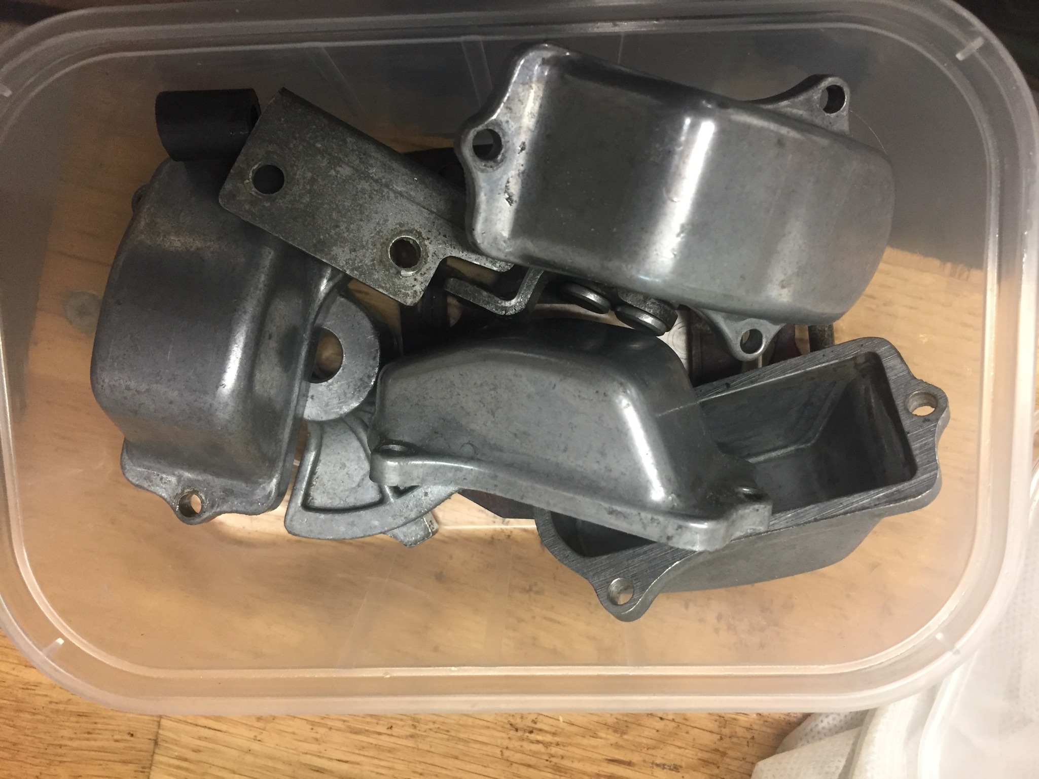

After and before being in the ultrasonic bath
Re: Carb refurbs.
#12 PostAuthor: Ultim8pc » Wed Nov 15, 2017 9:52 pm
chrisw1 wrote:After and before being in the ultrasonic bath
I think you've cheated and pout new jets in...
